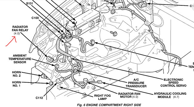

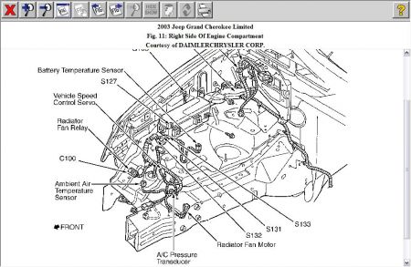

the cooling fan even after ignition is off the fan will run until the battery is dead, what should i check and where is the cooling fan module located at?
Dec 6, 2007 at 3:00 PM
  • 75,992 POSTS

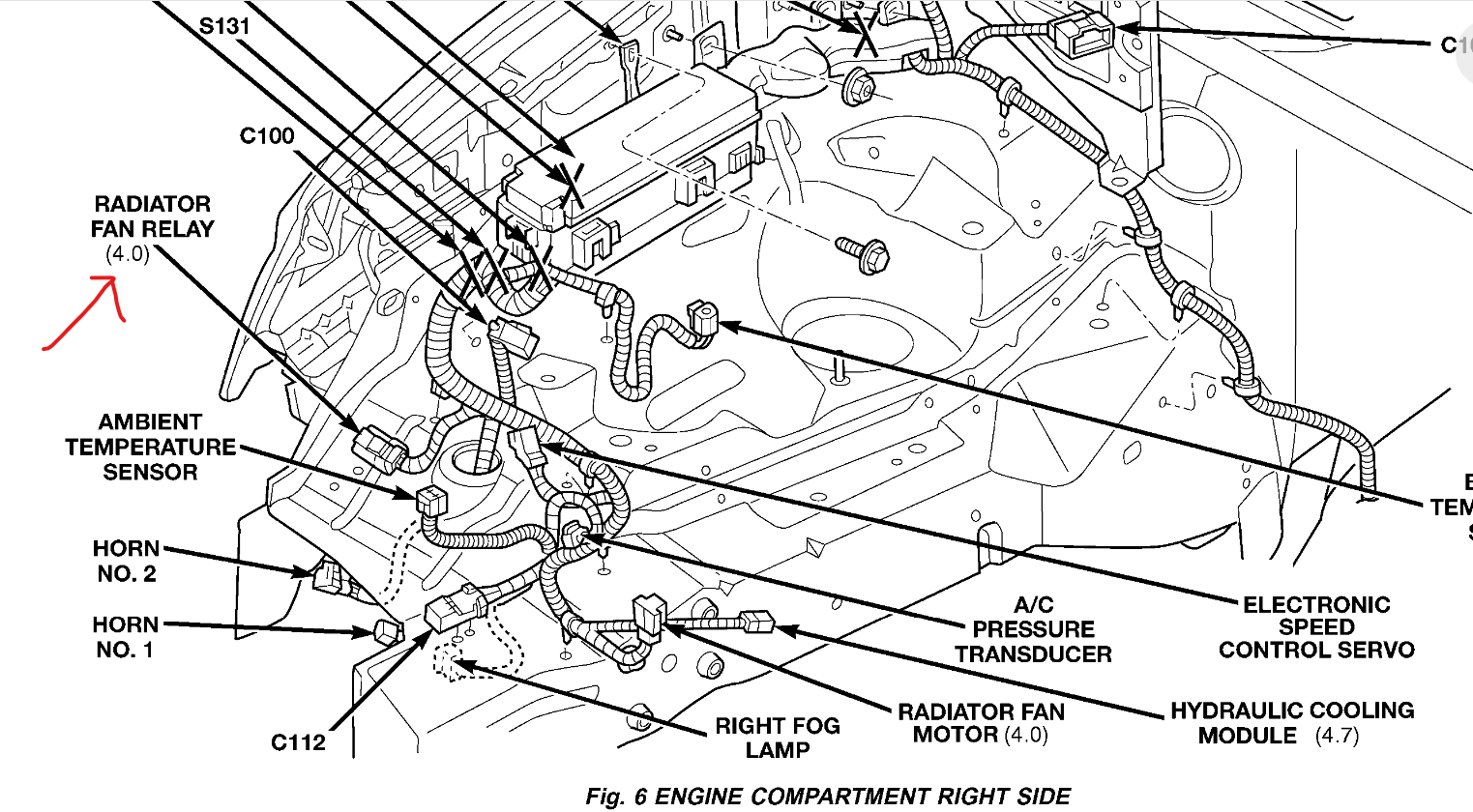

Inspect and test the hydraulic cooling module at right front of engine compartment and also the radiator fan relay. see below
https://images.2carpros.com/forum/automotive_pictures/12900_fan_relay_1.jpg

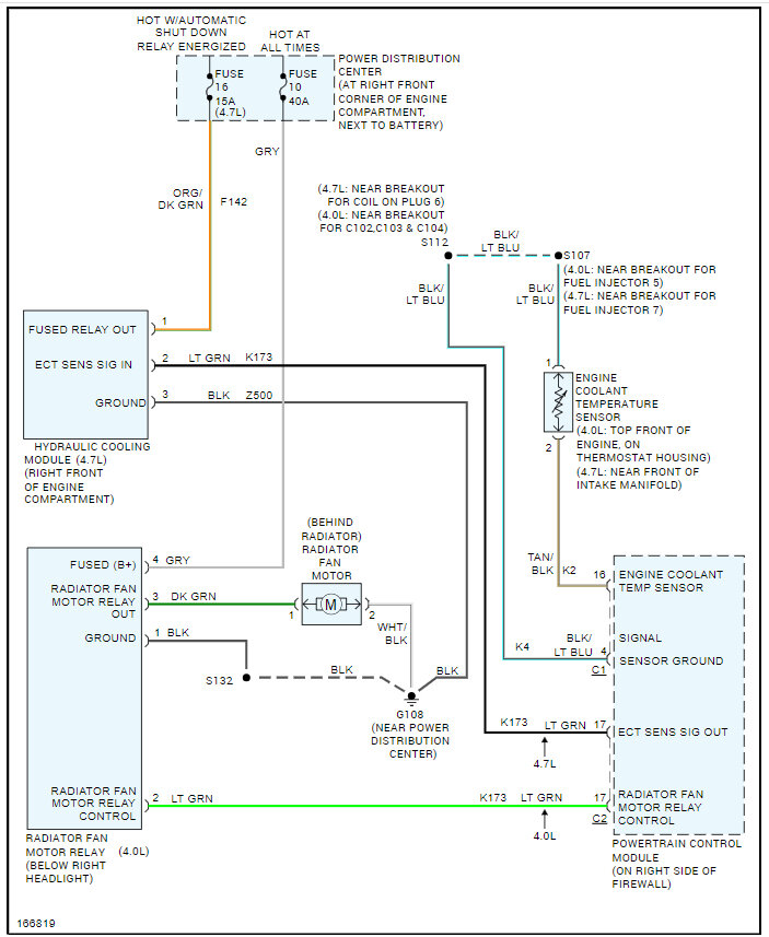

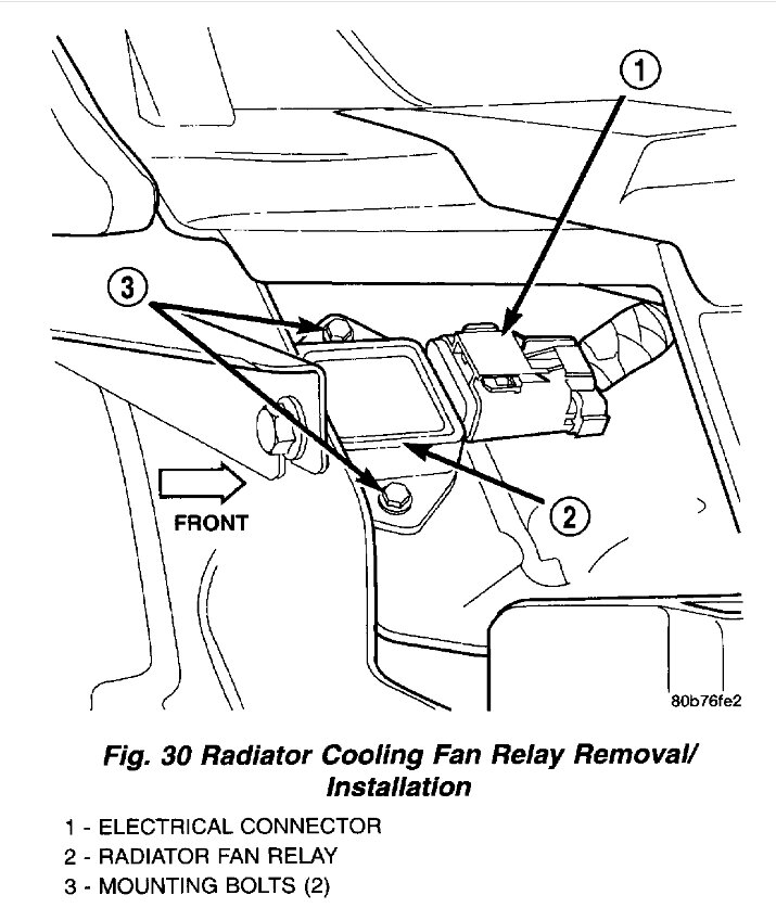

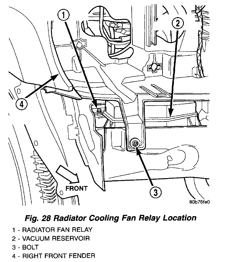

Your cooling fan relay is sticking on which is right below the right headlight, here is the location and I found the cooling fan wiring diagrams so you can see how the system works with the relay location in the images below. It is not a typical relay, but more like a solid state speed control. Check out the images (below). Let us know if you need anything else.
