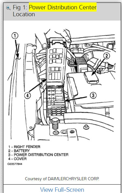

Hello, can you PLEASE help me. I need to replace my relay for my radiator fan and I can not find it. I have printed out a location of where the module should be. I removed the front passenger headlight along with the bumper. and the relay module is not there. I have a 2004 jeep grand cherokee 2wd 6 cylinder. Can you please let me know if this can be any where else?? Help

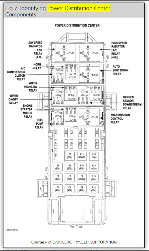

Both low and high speed radiator fan relays are in the power distribution center at right front corner of engine compartment next to the battery.
Here is a guide to help you test them

Thanks for the help I followed the guides and found the low speed relay was out. Once I replaced it the fans started working again.

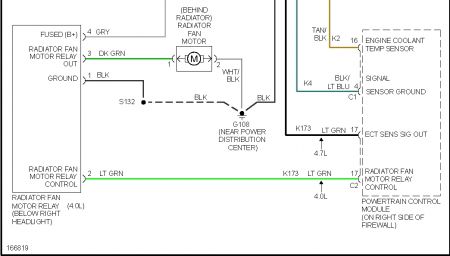

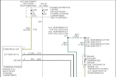

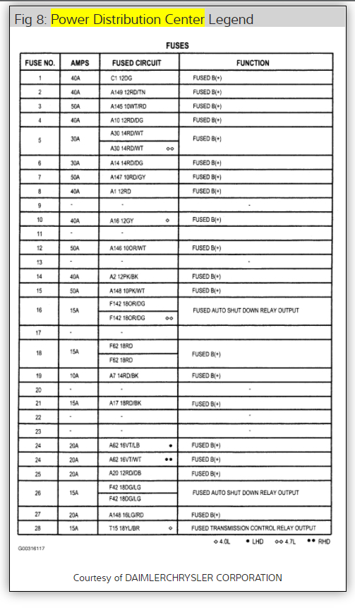

i would like to get a wire diagram of radiator fan system,
also unable to locate physical location of components such as radiator fan relay
Apr 16, 2018 at 5:49 AM (Merged)
BLUELIGHTNIN6
  • 16,542 POSTS
The fan relays are in the PDC under the hood check the post above.
https://images.2carpros.com/forum/automotive_pictures/261618_Noname_2631.jpg
https://images.2carpros.com/forum/automotive_pictures/261618_Noname2_856.jpg
