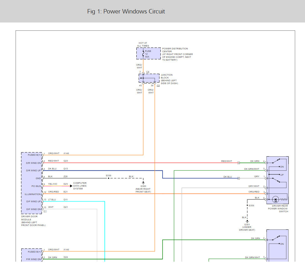

I have a problem with my vehicle it has a six cylinder, all wheel drive automatic, 52,000 miles. None of the windows function, the drivers door lock, or either mirror. The car is behaving as if the door is open when it is shut. The interior lights remain on, but the computer does not say the door is open. I detailed the interior of the car and the following day this problem began. I thought I got Armor-all in the switch, so I bought electrical contact cleaner and tried to clean the switch. I was wondering if anyone can give me some ideas? Also, if anyone knows if I must remove the door panel to access the switch or if I can just remove the plastic trim? I plan on checking for loose wires next.
Thanks
Feb 29, 2008 at 1:16 AM
RTDIXON

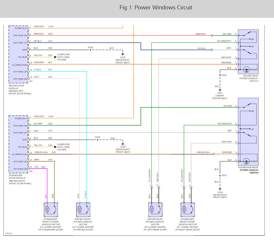

My vehicle developed the exact problem. I fixed a broken wiring in the door near the door jam where it goes through to the body and into the car. It will flex there until the wire breaks. Its an easy fix just remove the door panel and check it out. Here is a guide to get the door panel off:
https://www.2carpros.com/articles/door-panel-removal
Here is a window wiring diagram so you can tell which wire does what.
Cheers
Mar 8, 2008 at 10:33 AM

I just fixed this kind of problem. Check the black wire between the door and the body inside the rubber boot. The boot comes off the door rather easy, but putting it back into place is hard. I soldered the wires and was back in business in under thirty minutes and another thirty minutes to figure out how to get the boot back on. It will go back on using a screw driver (to hold the plastic door piece away from the door) and a tiny pair of needle-nose pliers. Good luck!
Apr 27, 2008 at 9:46 AM
FLY4LIV
I finally fixed it today. It was the orange and white power feed located in the rubber boot between the door and body. After removing the boot to check the wires I noticed the wire was cut clean through. It was not rubbing on anything or kinking so I am not sure why it broke, but it did. I slid some heat shrink over it soldered it together then covered it with the heat shrink. Problem solved, all is working fine. It took about forty minutes total.
