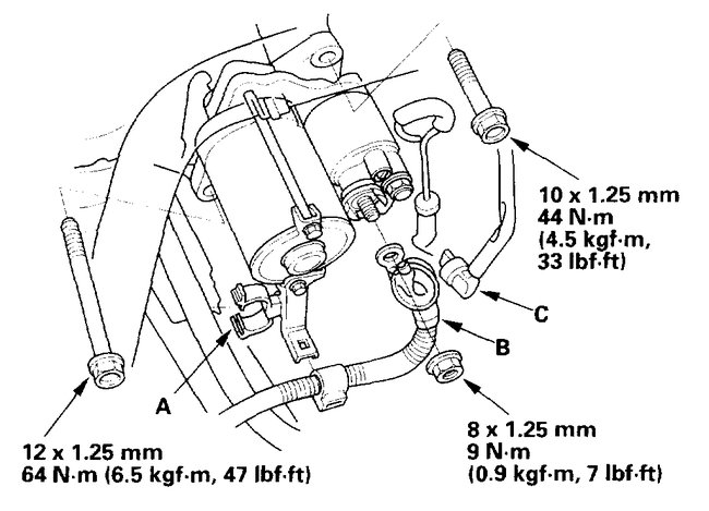

1. Make sure you have the anti-theft codes for the radio and the navigation system, then write down the frequencies for the radio's preset buttons.
2. Disconnect the negative cable from the battery, and then disconnect the positive cable.
pic 1
3. Unlatch the automatic transmission fluid (ATF) cooler hose clamp (A), then disconnect the starter cable (B) and BLK/WHT wire (C).
4. Remove the two bolts holding the starter, then remove the starter.

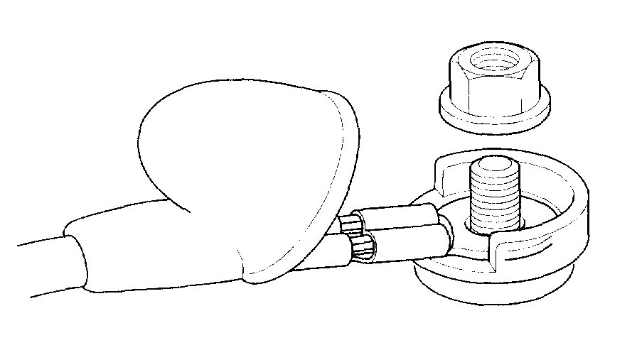

pic 2
5. Install in the reverse order of removal. Make sure the crimped side of the ring terminal is facing out.
