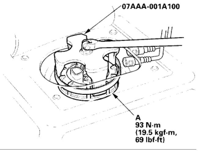

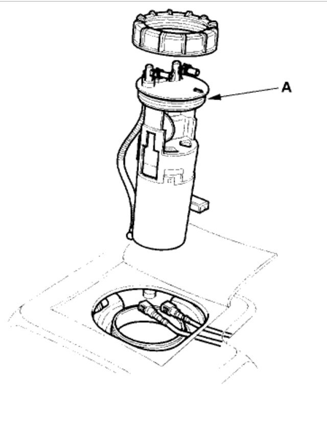

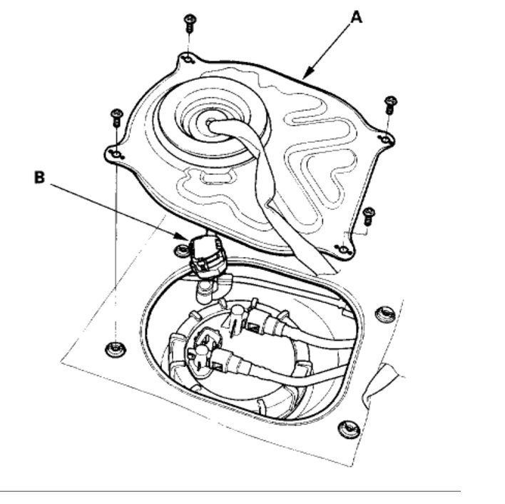

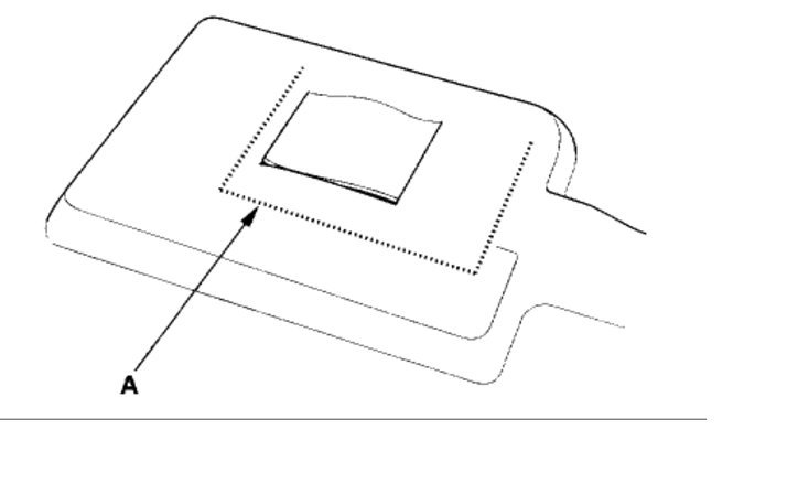

This sound like you have a weak fuel pump that is not pressurizing the system fast enough which is a common problem. Here is a guide that will help you test the pressure and another to help you get the pump changed out.
and
https://www.2carpros.com/articles/how-to-replace-an-electric-fuel-pump
diagrams for your car are BELOW it looks like you can get to it by removing the back seat.
Please let us know what you find ;)
