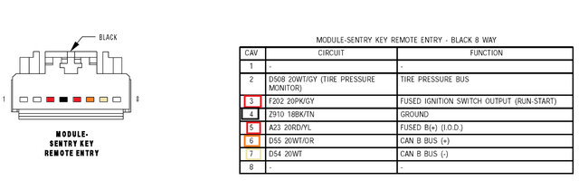

First checking the Radio, test 1-

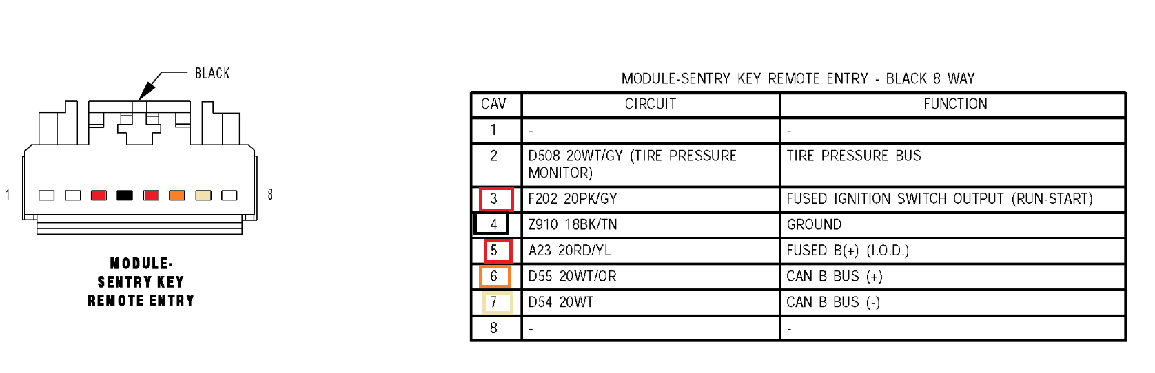

pin 5 (D55) meter lead 1 and the other to a Ground, Key On
CAN B BUS + should be 2.5 volts to 3.0 volts So you will typically read the average of the those two voltages=2.8volts.
Pin 6 (D54) CAN B BUS - should be 2.4 volts to 2.0 volts-again the average will be 2.2volts. Start with that. If you read 0 volts or 12 volts or something else odd, then we know there is an issue. But all the bad wires you're finding under the dash, it sounds like you'll be going through a lot of checks.

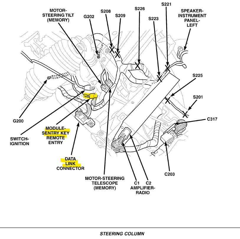

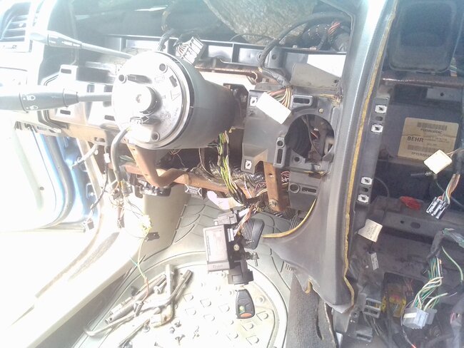

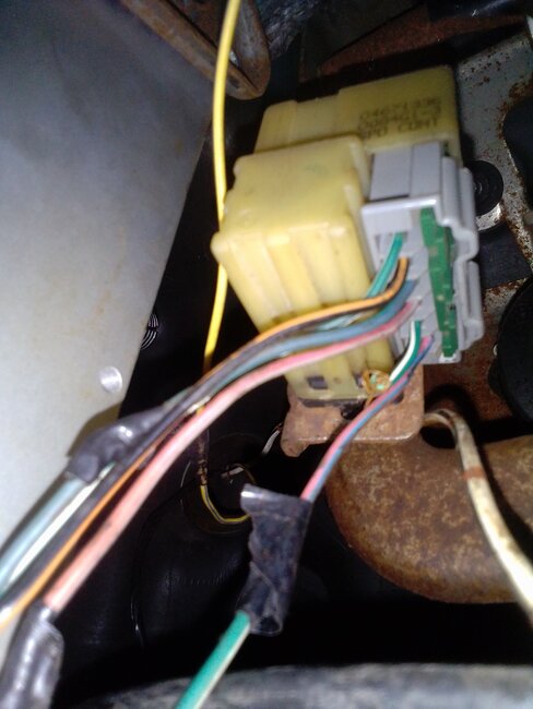

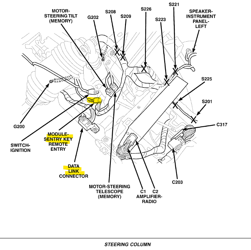

Then the Sentry Key Module is on the Steering Column, in the diagram see where the Data Link Connector is, the module looks to be located just behind that. Look for the connector according to the wire colors, it's a 6-wire connector, I've marked the powers and ground as well as the 2 CAN B wires, again look for the 2 twisted wires, the canbus wires are always a twisted pair.

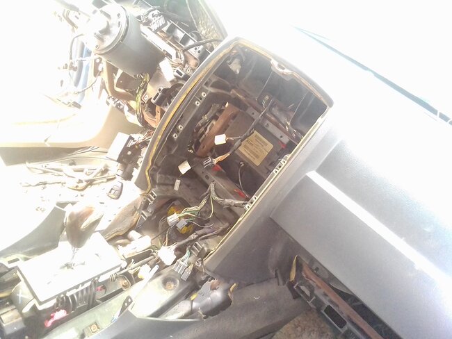

Please in addition, what about at the radio connector, do I also need to check for short to ground or power? If yes, how can I test this using my multimeter or test light? What about at the transponder wiring diagram you earlier sent, do I still need to test anything there? If yes, what should I test for and what values should I anticipate for my test?

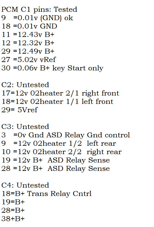

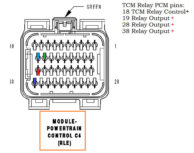

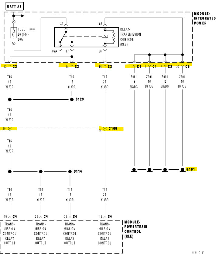

We just first need to know if the CAN B circuits are active or not, some of the codes you are getting now are different than before, so if this vehicle is from another shop, they set those codes trying to figure out what is wrong here. This P0888 code is a TCM Relay code for less than 3 volts going to the PCM.
The TCM and PCM are one unit here. PCM C4 pins 18, 19, 28, 38 all should have power key on.
Does the vehicle run at all right now? And what's the oil level? This other code P2288 is reading as Oil Pressure Too High or Faulty Oil Injector.

Alright, let's get back to this tomorrow, I'm not sure if you still have the old PCM, but these old codes you originally posted look like they tried messing with a new PCM and it didn't work. Here's some testing you can do tomorrow if you want, it's just checking powers to the PCM connectors C2-C4.
I forgot to add C4 pins 12, 13, 14 are all Grounds.

Okay. I asked the client if they've ever been a time that he has a gear issue? He admitted "yes they've been." Then a particular relay from the engine compartment was replaced. The day I asked him that, twice when I was trying to crank the engine it was a no crank no start. The engineer whose garage the car is parked told me that it has occurred before. To fix that, I swapped the starter relay with another relay from the power distribution at engine compartment. The problem was fixed.

When checking the 22 pins radio connector, with my multimeter black lead connected to ground then the other red lead connected to pin 1 when ignition was switched to On position, I got 12.45v. When the red lead was moved from pin 1 to pin 5, I got a 0.00v. Next, to pin 6 I got 0.92v. Finally on pin 12, I got 12.45v.
Additionally, moving my multimeter range to continuity setting, with the black lead connected to ground and the red lead to pin 5, 11, and 22, there was a continuity. When the black lead of the multimeter was still connected to battery negative and the red lead to pin 5, I think they should be no continuity from the wiring diagram you sent.
On the other hand, when the multimeter black lead was moved from Battery negative to positive, and the red lead to pin 1, 6, 12 they were a continuity. When the black lead of the multimeter was still connected to battery positive and the red lead to pin 6, I think they should be no continuity from the wiring diagram you sent. If I'm wrong please correct me.
Furthermore, with ignition On, multimeter black lead connected to CAN B- and the red lead connected to CAN B+, I got 0.29v. Next, multimeter black lead connected to pin 1 and red lead connected to pin 5, I got 12.35v. While the black lead still connected to pin 1 and the red lead connected to pin 6, I got 12.02v.
