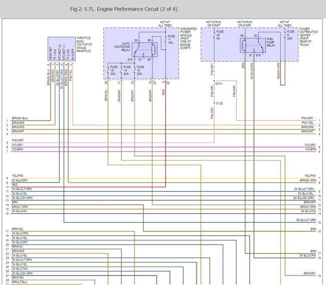

I have a 2005 Chrysler 300c with the hemi 5.7 it turns over but will not start it's getting fire to all 16 plugs and the gas is flowing. Changed the throttle body control because I can hold it open with my hand and the car starts. Can you help!
Wednesday, July 21st, 2010 AT 9:58 PM
30 Replies
KEN L
  • MASTER CERTIFIED MECHANIC
  • 48,363 POSTS
The first thing I would do is scan the computer for codes to see what comes up.
If no codes come up the next place I would go is the auto shut down relay.
Here is a guide and wiring diagrams so you can do some testing.
Please run some tests and get back to us so we can continue helping you.
Best, Ken

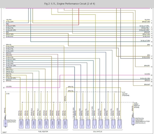

Driving down the road then the rpm went high then car died and now it will not start and I have 9 codes p0016 p0113 p0222 p0223 p0344 p0340 p2111 p2172. I am thinking it is the throttle body.
-1
Tuesday, April 4th, 2017 AT 6:40 PM (Merged)
  • 109,874 POSTS
If all these codes came on at once, I think it is something other than the throttle body. To me, it sounds like an electrical issue. Have you checked body grounds to make sure they are clean and tight? Also, make sure connections at the TB are clean and tight.
GABRIEL1976
How should I check all ground wires is there a way to do it?
KEN L
  • 48,363 POSTS
Hey GABRIEL,
Its also sounds like it could be the computer itself they had problems with those in that car, but you might what to check for a shorted injector which will do the same thing, here is a guide to help you.
https://www.2carpros.com/articles/how-to-test-a-fuel-injector
The system ground all be at the intake manifold and the engine block near the starter.
Let me know what you find.
Best, Ken
