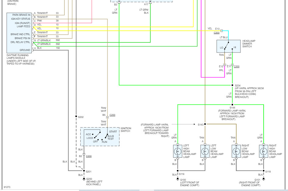

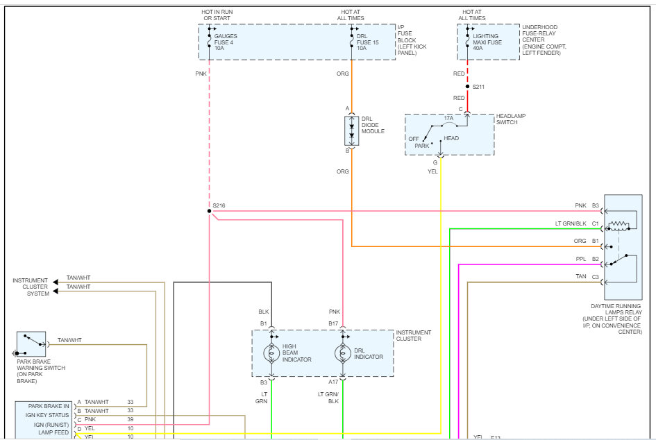

I can pull out my bulb and replace it so does that mean I have composite?
Friday, November 25th, 2022 AT 8:12 PM
  • 109,896 POSTS
Yep. It sounds like you have composite headlamps. If you are able to remove only the bulb and the lamp assembly is separate, that is what you have.
I attached the wiring schematic below. I had to cut it in half to make it readable for you. I did overlap them so you can follow from one to the next.
Let me know if this helps.

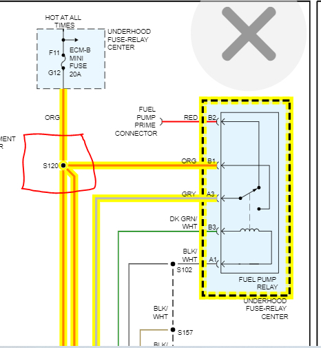

That isn't good. Especially near Christmas. As far as the pump. I'm not sure if you hear the pump prime and nothing more or if you hear nothing. Let me know that.
Also, I attached a pic of the fuel pump relay below. I noticed a splice in the power supply to the secondary side of the relay. I'm questioning if we have a poor connection at that splice.
Do me a favor. Remove the fuel pump relay and there will be one connector pin in the relay box that should have 12v at all times. Confirm that for me. If there isn't one, the splice is where we need to go. Of course, I'm assuming the fuse is good and has power to and from it.
Let me know what you find.
See pic below.

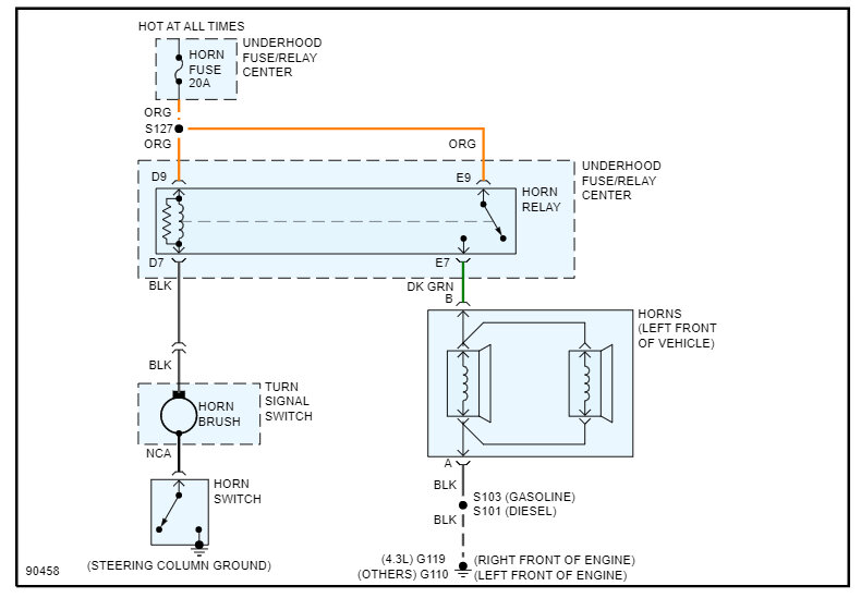

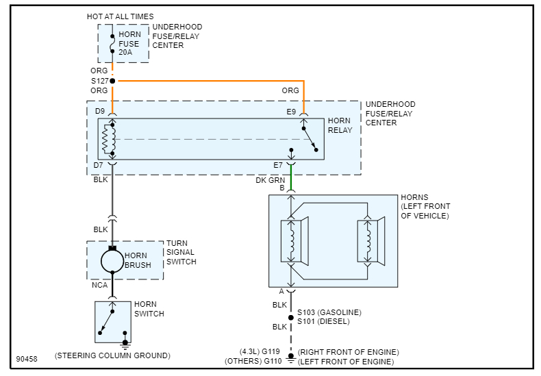

Thanks for getting back to me, sorry it took me a while to respond. I found a pin for the fuel pump relay that has power at all times, but I was a little less than 12 V. 11.7 or something like that. However, my battery was not fully charged at the time because it keeps draining due to a short, so I need to redo that test with a healthy battery. I was wondering what was draining my battery all the time and I remembered that a couple weeks ago someone told me that my horn randomly went off for about 30 minutes while I was gone. My horn itself seems to be damaged now because it only sounds like half its former self. Sure enough, when I went to try and start my van today, I reconnected that battery (I've been leaving it disconnected to try and prevent a strain on it from the short) and I heard a weird gurgling noise coming from near my fuse box. I noticed that my horn relay was hot, so I pulled it out right away and the noise stopped. Whenever I put the relay back in the noise comes back. I don't really know exactly where it's coming from, and it just sounds like a strange gurgling. I also wanted to say that the actual holder of my fuel pump relay has experienced a lot of corrosion in the past and although I've tried to clean it up, I think it has pitting from the corrosion. I'm wondering if this is resulting in a bad connection with the fuel pump relay even though the relay itself is closing. I was wondering if you might be able to send me a wiring diagram that has my horn circuit on it? I was going to try and track down that short. Even though I don't think it's related to my no start issues it's definitely not helping.

I attached the wiring schematic for the horn below. Based on what happened, I suspect the relay simply failed internally. Have you tried switching it with a different one that has the same part number? If there isn't one, here is a link explaining how to test a relay:
Were you able to check the voltage at the fuel pump itself?
See pic below.

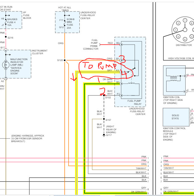

I don't mind at all. From the fuel pump, nothing will have power. Instead, power is sent to it from the fuel pump relay.
Here is how it works. The orange wire from the ECM-B fuse has power at all times but at the relay itself, the circuit (switch) is open.
If you look at pic 1 below, I numbered each wire. For the circuit to work, the number 1 wire receives voltage from the PCM. Wire 2 is used as a ground for that wire. When that happens, it energizes the primary side of the relay causing an electromagnet to pull the switch closed on the secondary side of the relay. Once that switch is closed, power from wire 3 (hot at all times) can go to the pump.
Let me know if that helps or if you have other questions.

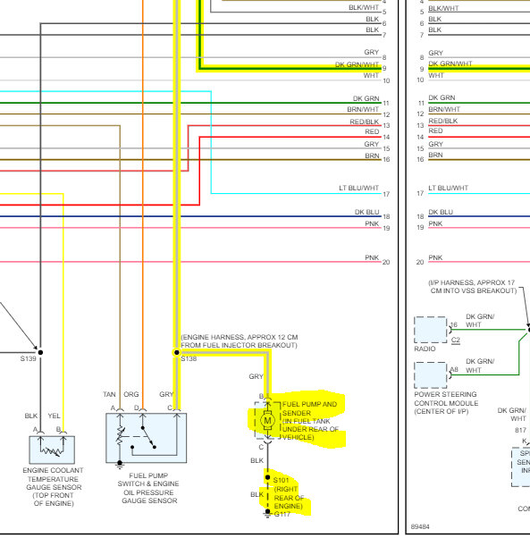

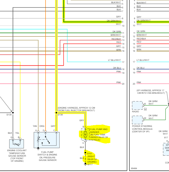

Thank you so much for the wiring diagrams that's very helpful. I see the grey wire coming from my fuel pump connector. So that grey wire should have around battery voltage with my key in the on position, right?
Thursday, December 29th, 2022 AT 11:29 AM
  • 109,896 POSTS
Yes, that is the power source. However, without the engine running (key on) it will only receive power for about two seconds when the key is first turned on. That is the period of time for priming the system. Once the engine starts, the pump runs continuously.
