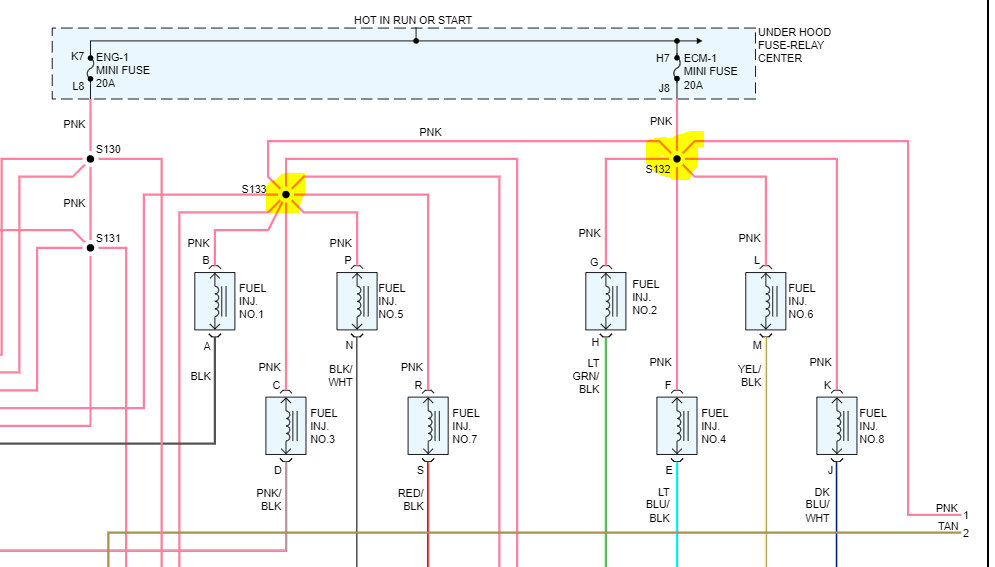

If you suspect the injectors, see if it starts with starting fluid first. If it does and then stalls, then you are likely correct.
As far as the injectors, each one will have a pink wire in its connector. With the key on, all of the injectors' pink wires should have battery voltage. If they don't, wiggle the fuse around first to see if it isn't making a good connection. Also, move the pink wires around because there are two giant splices they are a part of. We could be losing power at the splices. See pic 1 below
The idea that you jumping on the bumper makes it work sounds like we either have a loose or poor connection.
Let me know what you find.

That wiring diagram is very helpful thank you. To clarify, that is specific to my vehicle, right? My fuel injectors themselves are under my intake manifold but the electrical connection for the spider assembly is on top so I believe I can check the wires there. I'm still not having any issues though so I'm not sure if my results right now would reveal what's actually happening during the crank no start moments. I plan on doing the O2S test tomorrow as well as well as pulling out my engine fuse block and looking under it because I noticed some corrosion and rust there and I'm wondering if there are wiring issues underneath it. I'll let you know what those tests tell me.

As far as the wiring is concerned, yes, that is specific to your vehicle. If you need any schematics, let me know which ones and I'll try to get what you need.

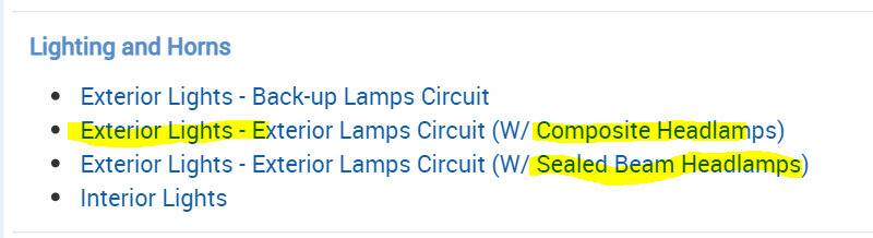

As far as the exterior lighting is concerned, believe it or not, there are two designs. LOL Does the vehicle have sealed beam headlamps or composite headlamps?

Ooof I'm not sure haha. I will check when I get home around 9. Do you know how I can tell? Sorry not familiar with what the difference is.

I can pull out my bulb and replace it so does that mean I have composite?

Yep. It sounds like you have composite headlamps. If you are able to remove only the bulb and the lamp assembly is separate, that is what you have.
I attached the wiring schematic below. I had to cut it in half to make it readable for you. I did overlap them so you can follow from one to the next.
Let me know if this helps.
