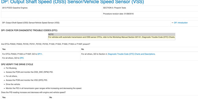

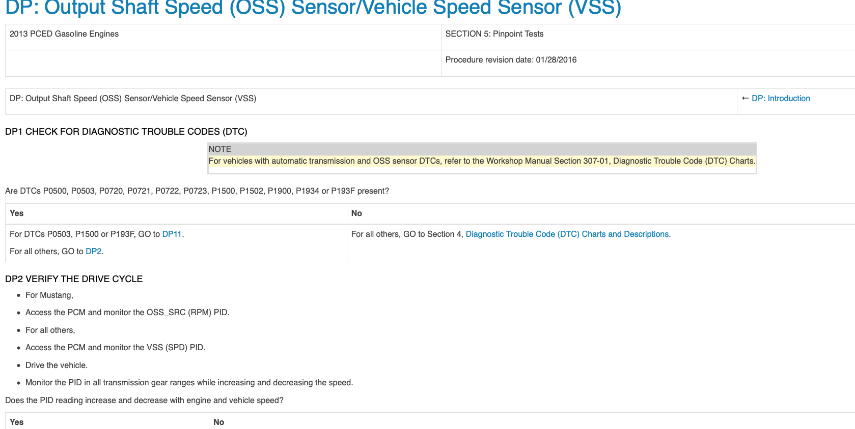

I'm not sure what Transmission it has off hand. As for the OSS PID it didn't do anything or show anything at all, while the VSS was moving up and down. Just so you know, I attached the chitons page I was looking at. So, if it didn't show anything does that mean it's the sensor?
Saturday, April 23rd, 2022 AT 3:25 PM
Perfect. That is what I attached the last time as well, so we are on the same page.
Correct. If it didn't move at all then that is the cause of the code as the code is telling you that the PCM didn't get any signal from the sensor when the other one was showing RPM.
Normally this is a sensor but that is why we would do the rest of the testing because it could be a wiring issue or even a PCM issue but that is less likely.
