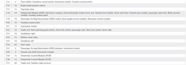

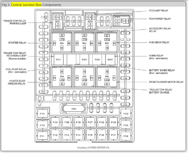

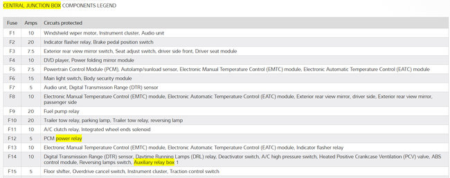

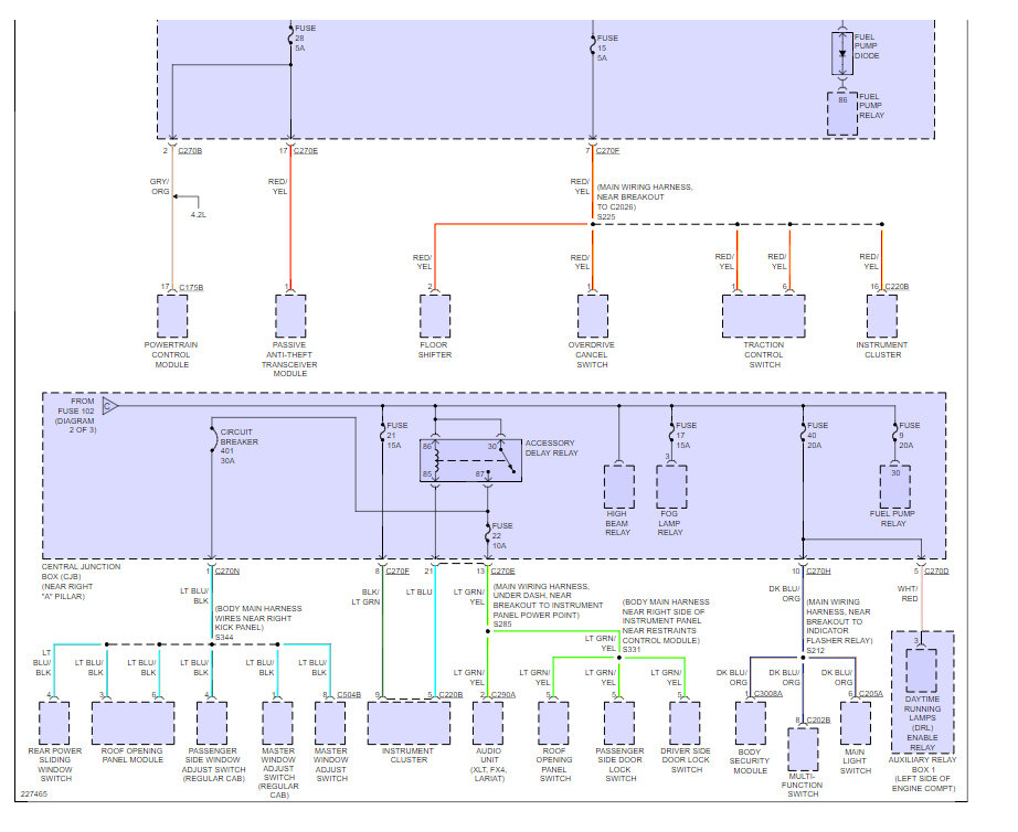

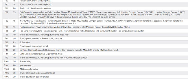

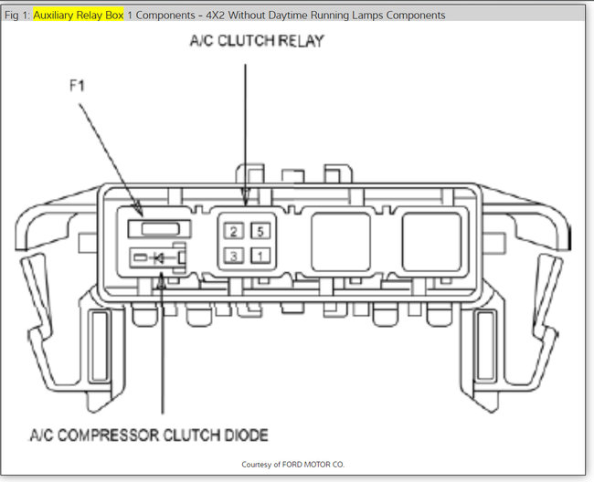

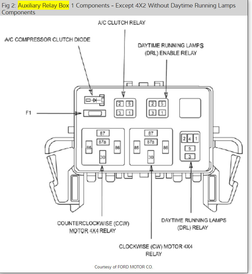

There is an accessory delay relay that powers the items you are talking about I think is going out.
Here is a power wiring diagrams and the guide to test the relay with the relay location.
Feb 2, 2018 at 9:18 AM
MICK1064
You guys are the best! that was the problem as soon as I found the relay and removed it I could see where it was super heated. Thanks again you guys are the best!
