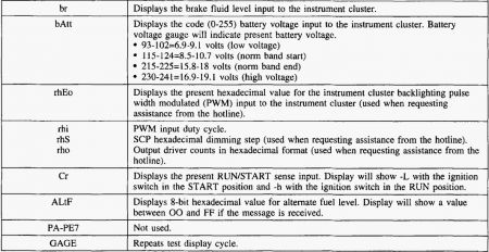

It take 8 seconds after I turn on my ignition for my gauges in my truck to start working. After 8 seconds, my gauges seem to work fine. Also, my check engine light doesn't come on when I turn on my ignition and my low fuel light doesn't work. I took my instrument cluster apart and checked all the bulbs and all were fine. I might have a messed up circuit on my instrument cluster board but I'm not sure. Any advise is greatly appreciated.

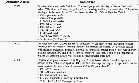

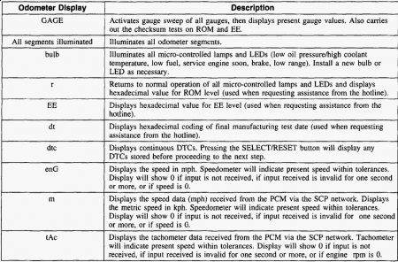

Instrument Cluster Dealer Test Mode To enter the Instrument Cluster Dealer Test Mode, depress and hold the instrument cluster SELECT/RESET button and then turn the ignition switch to the RUN position. Continue pressing the SELECT/RESET button (five seconds) until tESt is displayed in the odometer. The SELECT/RESET button must be released within three seconds of the odometer displaying tESt to begin the dealer test mode. Depress the SELECT/RESET button to advance through the following steps until dtc is displayed. Depressing the SELECT/RESET button will display any continuous DTCs stored before proceeding to the next step. Fig. 10: Odometer Display And Description Chart (1 Of 2) Courtesy of FORD MOTOR CO. Fig. 11: Odometer Display And Description Chart (2 Of 2) Courtesy of FORD MOTOR CO. Turn the ignition switch to the OFF position or press and hold the SELECT/RESET button for three or more seconds and release to exit Instrument Cluster Dealer Test Mode. If no DTCs related to the concern are retrieved, proceed to the Symptom Chart to continue diagnostics. Page 1 of 1 INSTRUMENT CLUSTER-CONVENTIONAL - F150 -2003 Ford Pickup F150 5/17/2009

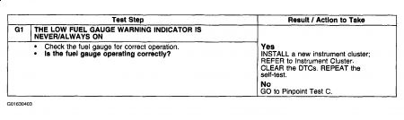

I did the test and came up with the following dtc codes:
d262
9356
I have no idea what these 2 codes are and I'm looking for some advise to why these codes are appearing.

What I found is the cluster itself is most likley the bad part, comes up as if the fuel gauge works, but the low fuel light is never/ or always lit, the cluster needs replacing.
