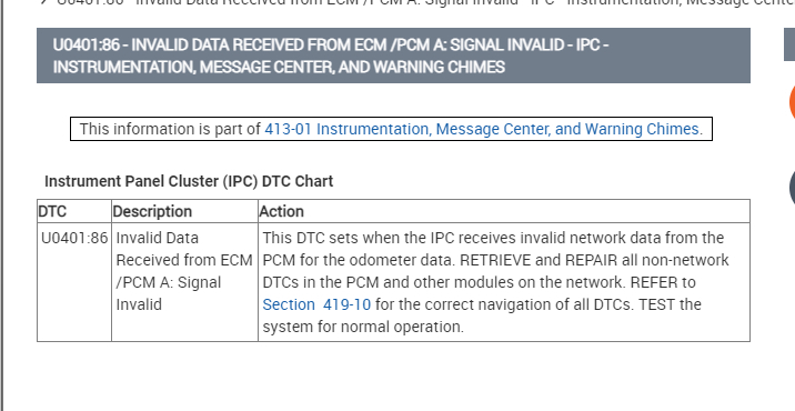

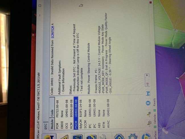

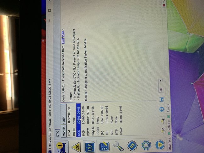

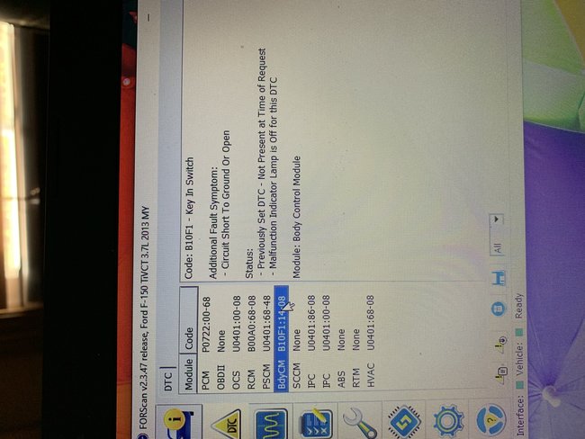

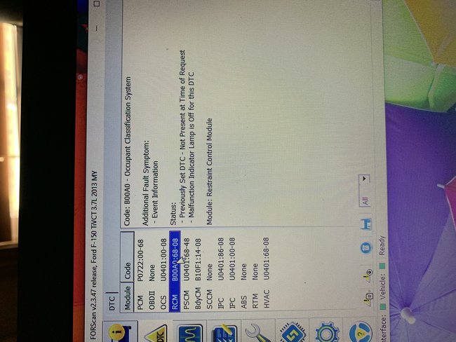

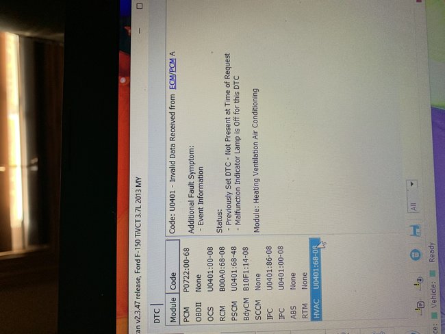

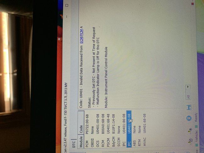

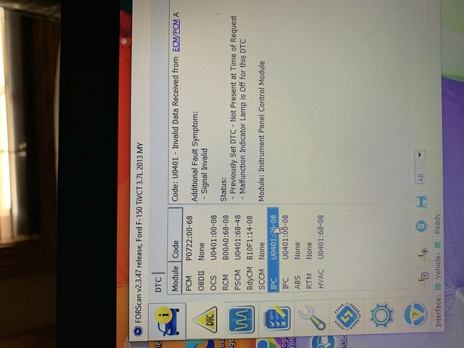

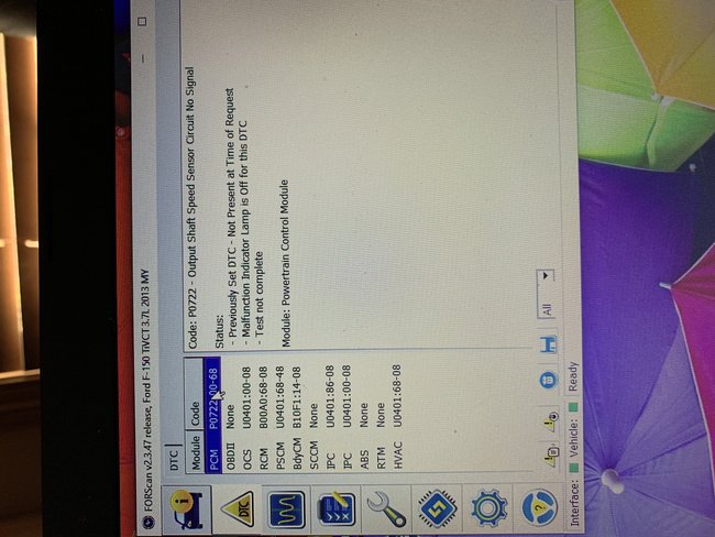

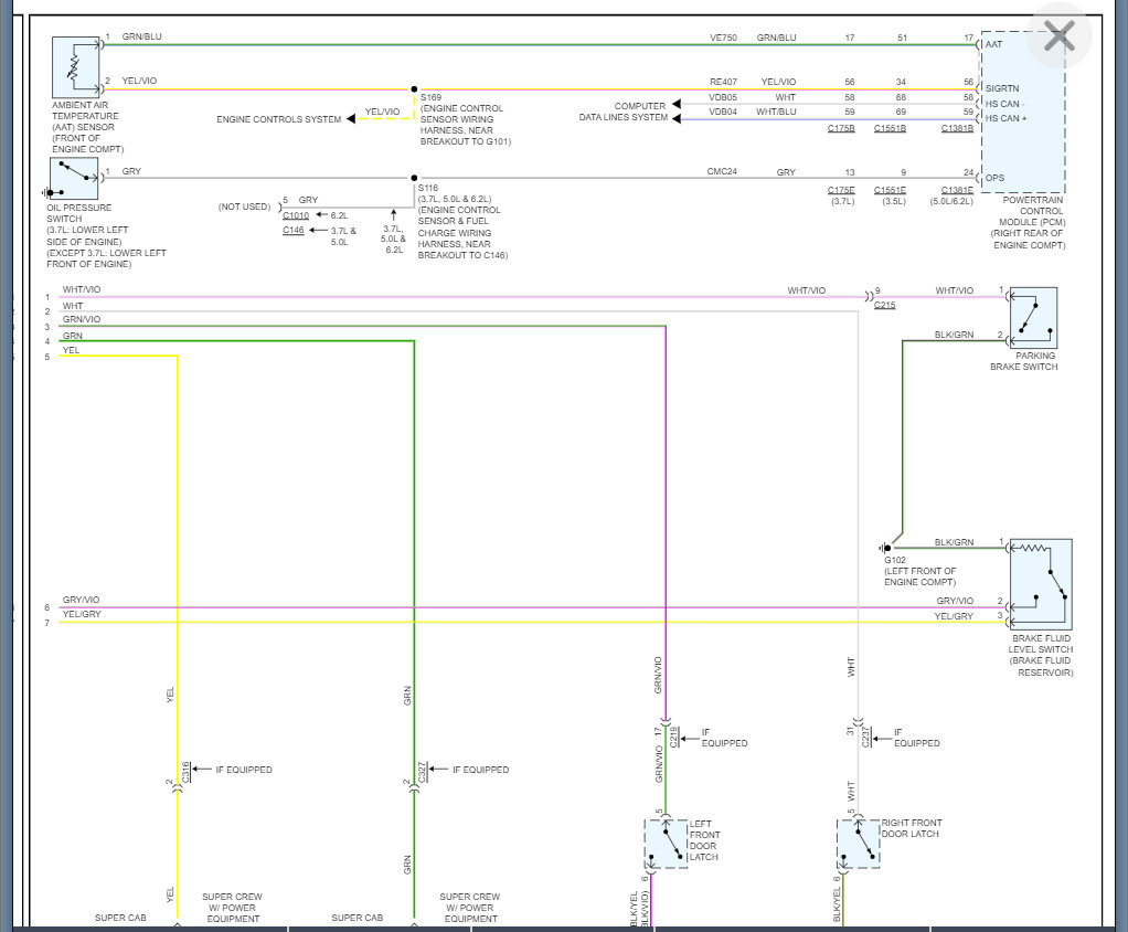

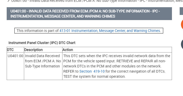

Okay, so I downloaded some software called Forscan that does a lot of different things. Even lets me do some tests and if I upgrade the software, I can do things that would probably get me into lots of trouble.
Anyway, I scanned the truck and got several DTC's. I'm hoping you can decipher them and let me know what the issue is. I've included screenshots of each of them with the provided info. They don't all seem to go to the same issue, but several of them talk about an ECM/PCM issue.
Apr 20, 2022 at 6:30 AM

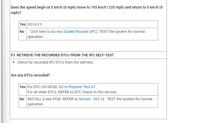

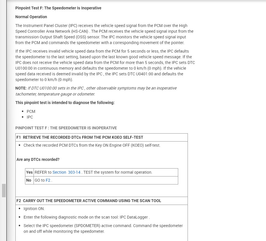

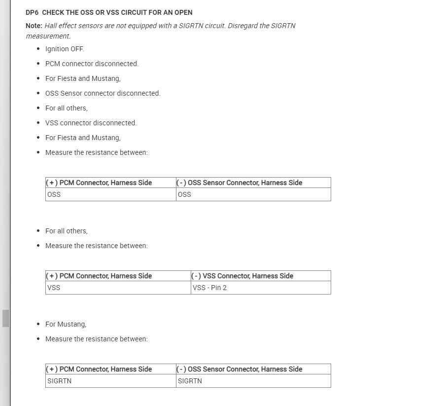

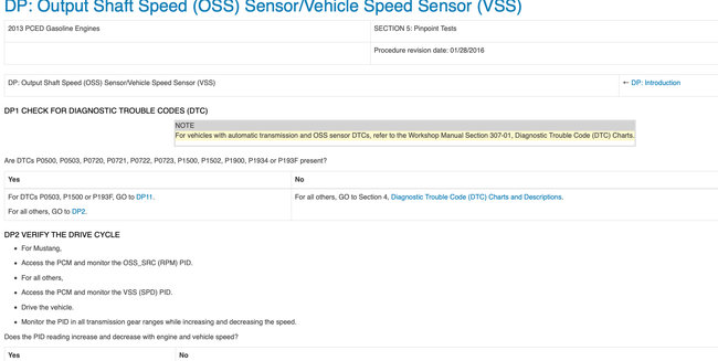

Okay. That really helps. Basically, this is telling you that the PCM or the cluster are the issue.
So that means we need to run through this info and find out which it is. However, to your point, there are other modules reporting the PCM is sending invalid data so that means the likely cause is the PCM.
However, I suspect the turn signal issue is not related at all based on this info.
Apr 20, 2022 at 7:02 AM

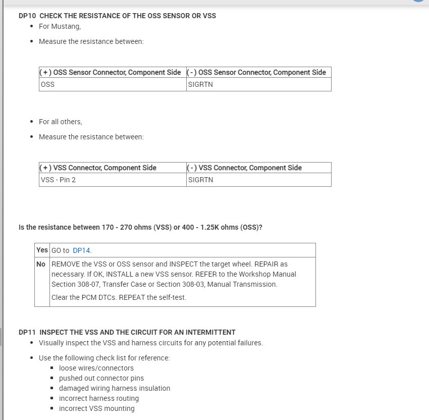

So, are you saying I need to try and do the tests listed in the images you included? Is that the next step? What's your feeling on this, is it something I'm going to be able to figure out and repair or is it most likely going to need to end up in a shop before it's all done?
Apr 20, 2022 at 7:08 AM
DGREGORY70
  • 46 POSTS

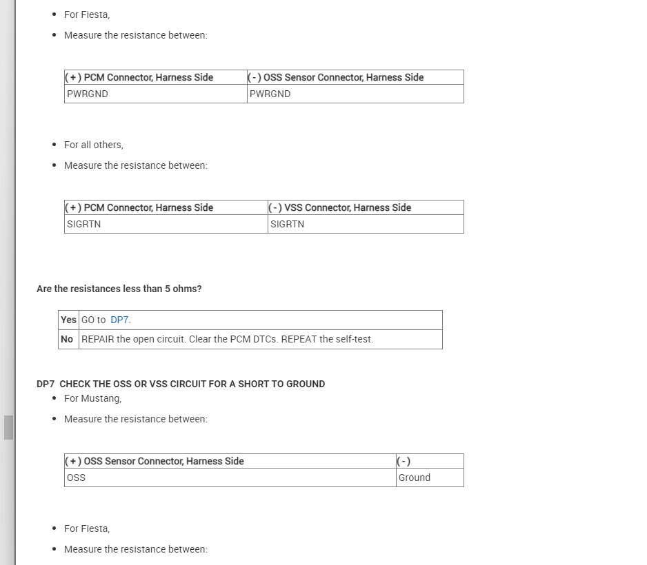

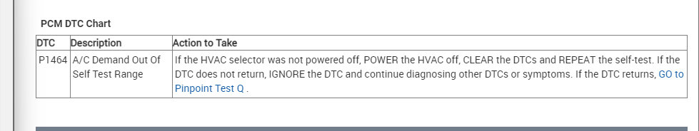

So, starting to look through your documents, step one, I already did a Key on engine off test. IT did record a DTC, P1464:00.
Apr 20, 2022 at 7:13 AM
DGREGORY70
  • 46 POSTS

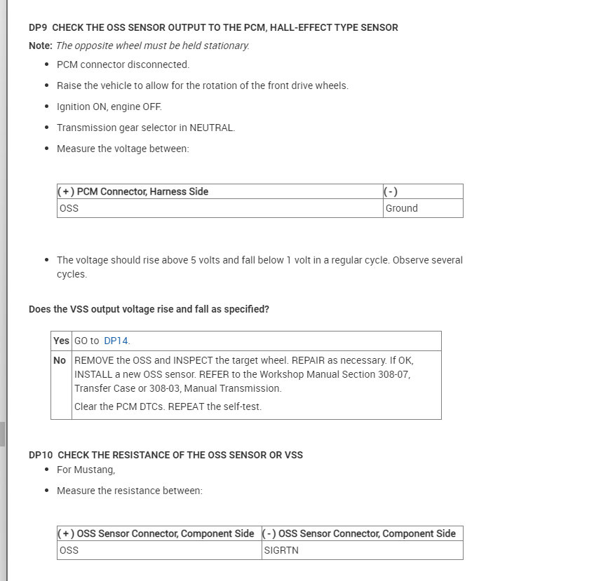

So i'm supposed to refer to 303-14, what is that?
Apr 20, 2022 at 7:14 AM

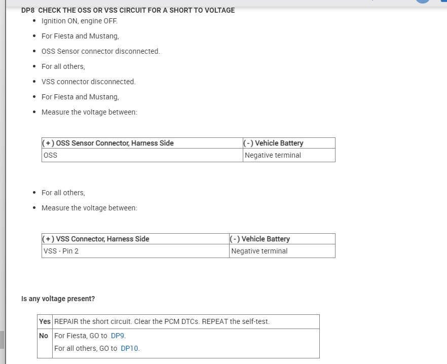

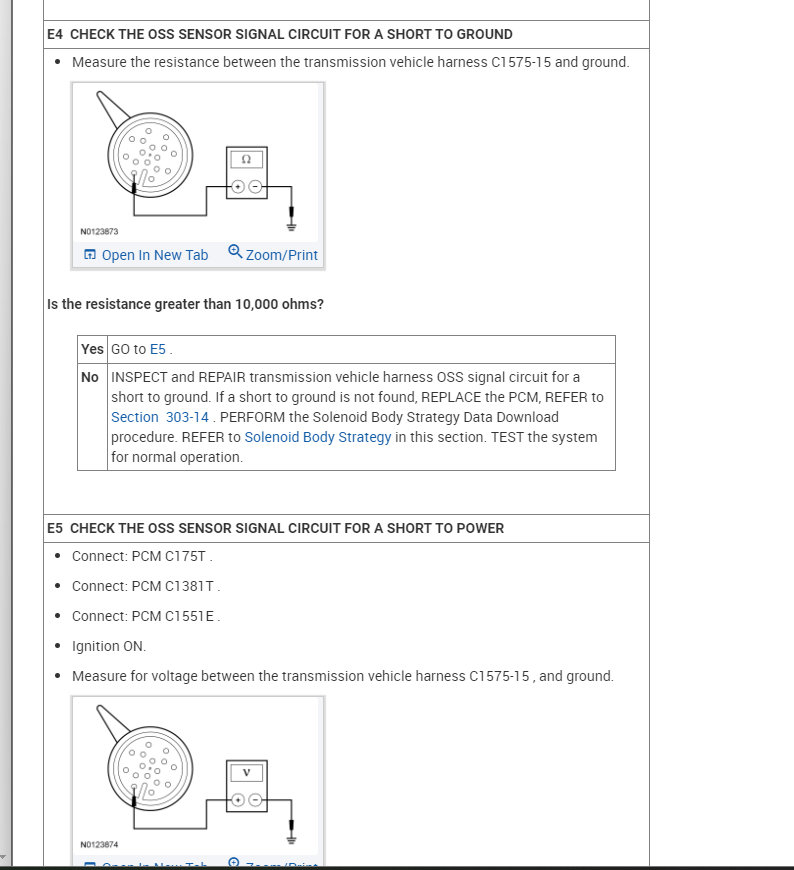

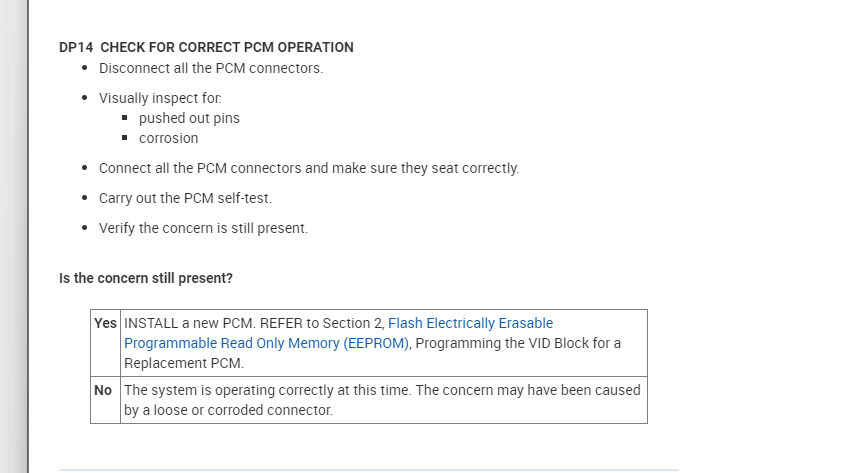

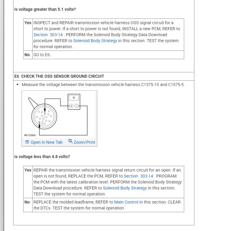

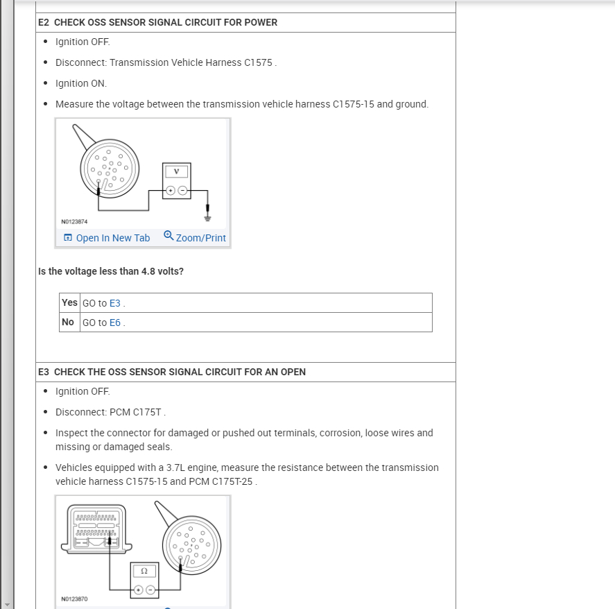

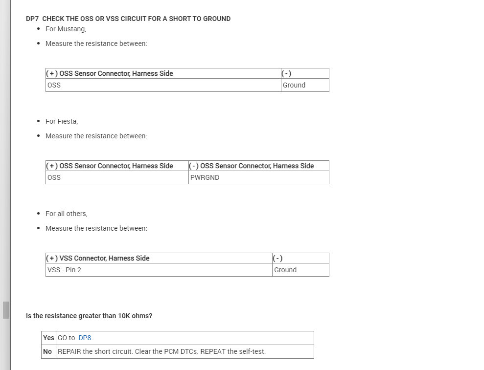

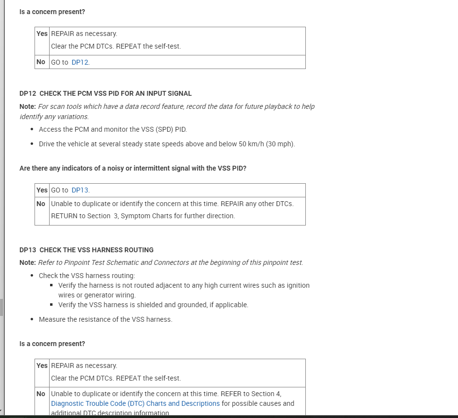

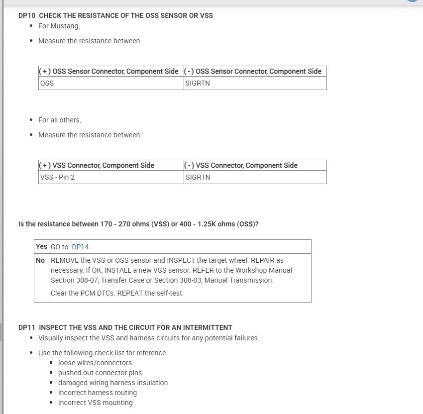

Correct. Since we have codes to go off of, we need to follow that testing. As for if you will be able to do it, I would not be able to answer that. It is not a heavy diagnosis on this, but it will require some more info.
I would read through it and see what you think but based on this, if you have other PCM codes it tells you to fix those. Which I just realized I did not attach the testing for the PCM code which is what you start with.
If you have an issue with the output shaft speed sensor then that will cause the issues you are seeing but as I stated, the PCM is likely the cause which will cause this code as well.
However, read through all these attachments and see if this is something you feel like you can tackle. If not, then a shop would be the best call.

Okay. Yes. Sorry for the confusion. I sent that info prior to you sending me the results of the self-test with the P1464. I did not see that info when I sent this other testing.
Hopefully, this will straighten it out. You have the U0401 codes and that tells you to run the tests that you ran and got the P1464. However, as you will see below that was most likely due to the system not being turned off. So that is an erroneous code. So the U0401 is telling us to address any other PCM codes which would be the OSS code. That is what I attached next. So I would suggest running through the testing for the speed sensor code and see if that leads to the PCM needing to be replaced. That is the likely cause as the other modules that are setting the same code against the PCM.
Hope this helps.

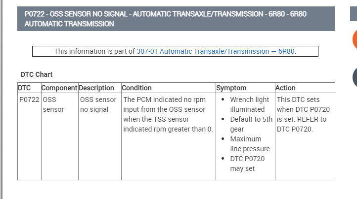

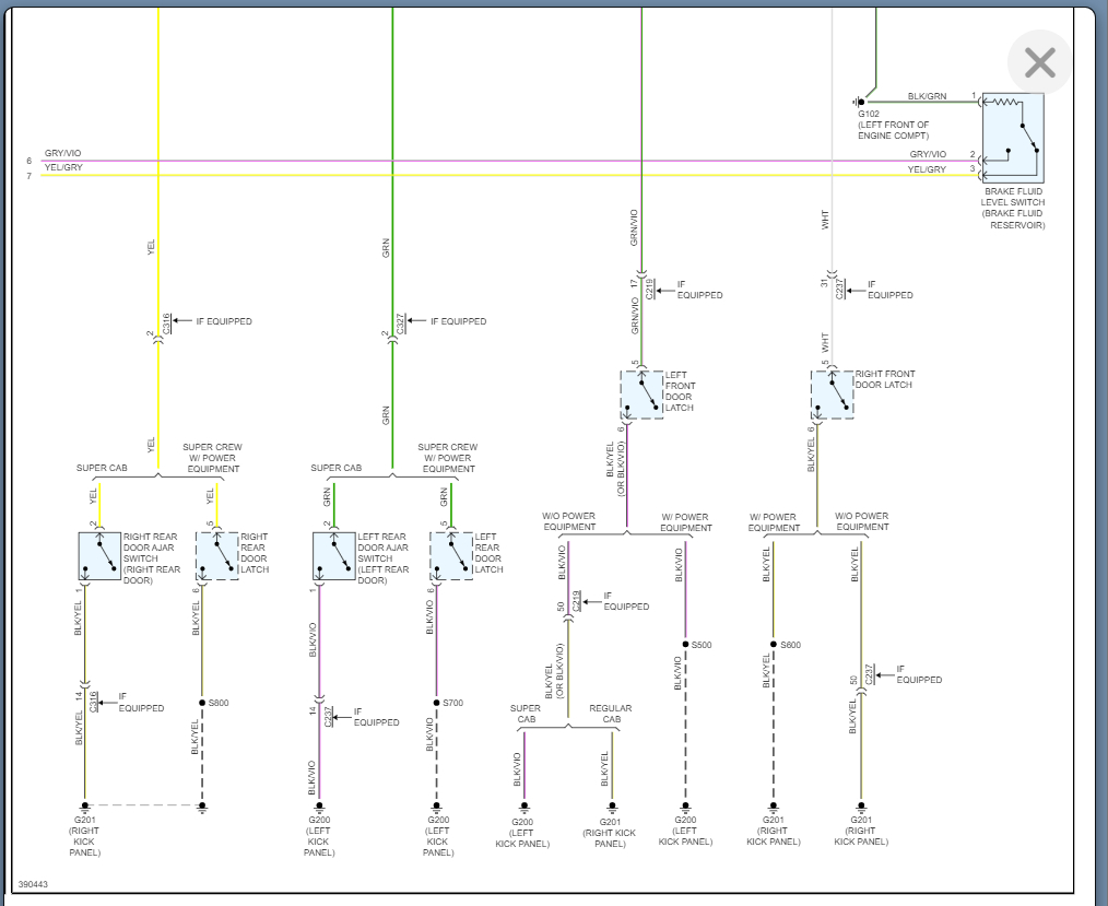

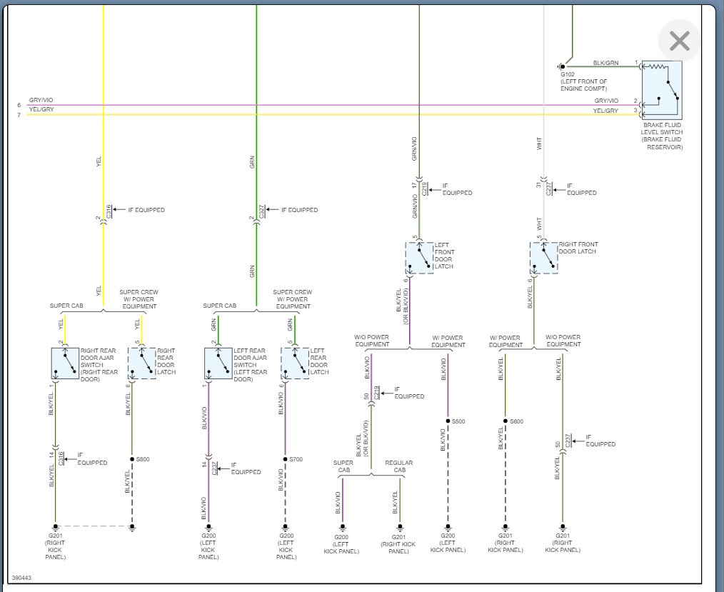

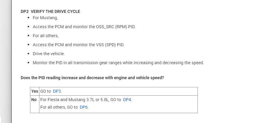

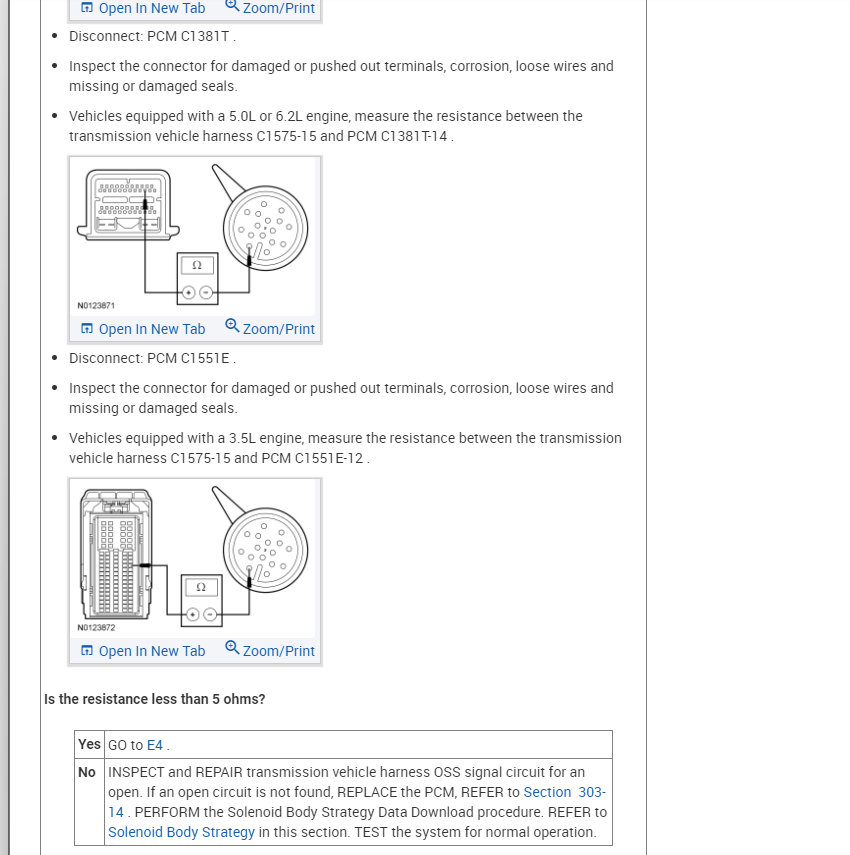

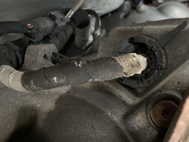

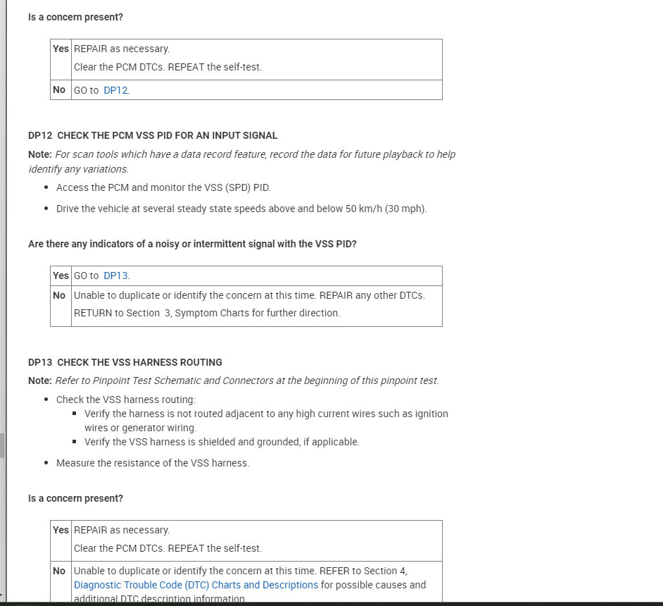

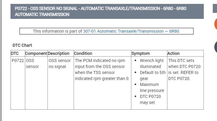

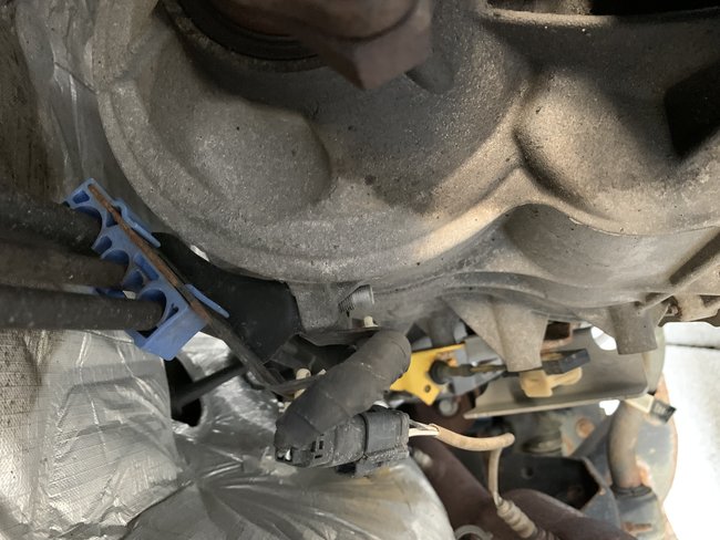

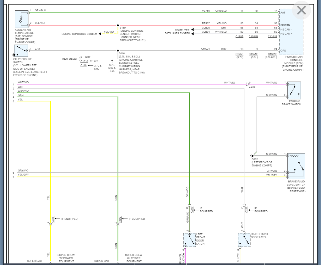

Good morning. So, I was able to road test the truck today and check the PID. I found an online Chilton's manual and according to it, for my vehicle I needed to monitor the VSS
PID for the P0722 DTC. I set up the scanner to monitor the VSS and OSS_F just in case. The VSS modulated up and down while driving, the OSS stayed flat. So, If I did this correctly does this mean the sensor is working correctly? If that's the case, what's your gut feeling, do I need to run through the remaining pinpoint tests or just replace the PCM/ECM? I can do the tests, but there's not a lot of room while lying under the truck. If i do need to go that route, can you look at the two attached pictures and let me know which one is actually the VSS? I thought it was on the driver side near the output shaft, but those wires went to an O2 sensor. So, I'm thinking it's the one on the passenger side. Also, on the passenger side it looks like the wires are pretty thin and kind of exposed when going into the transmission or module (look at the yellow wire if you can zoom in). Is that correct, wouldn't there be some sort of boot or something to protect them from the road and the elements?
First picture is the driver side, second is passenger.
Thanks
Apr 23, 2022 at 1:07 AM

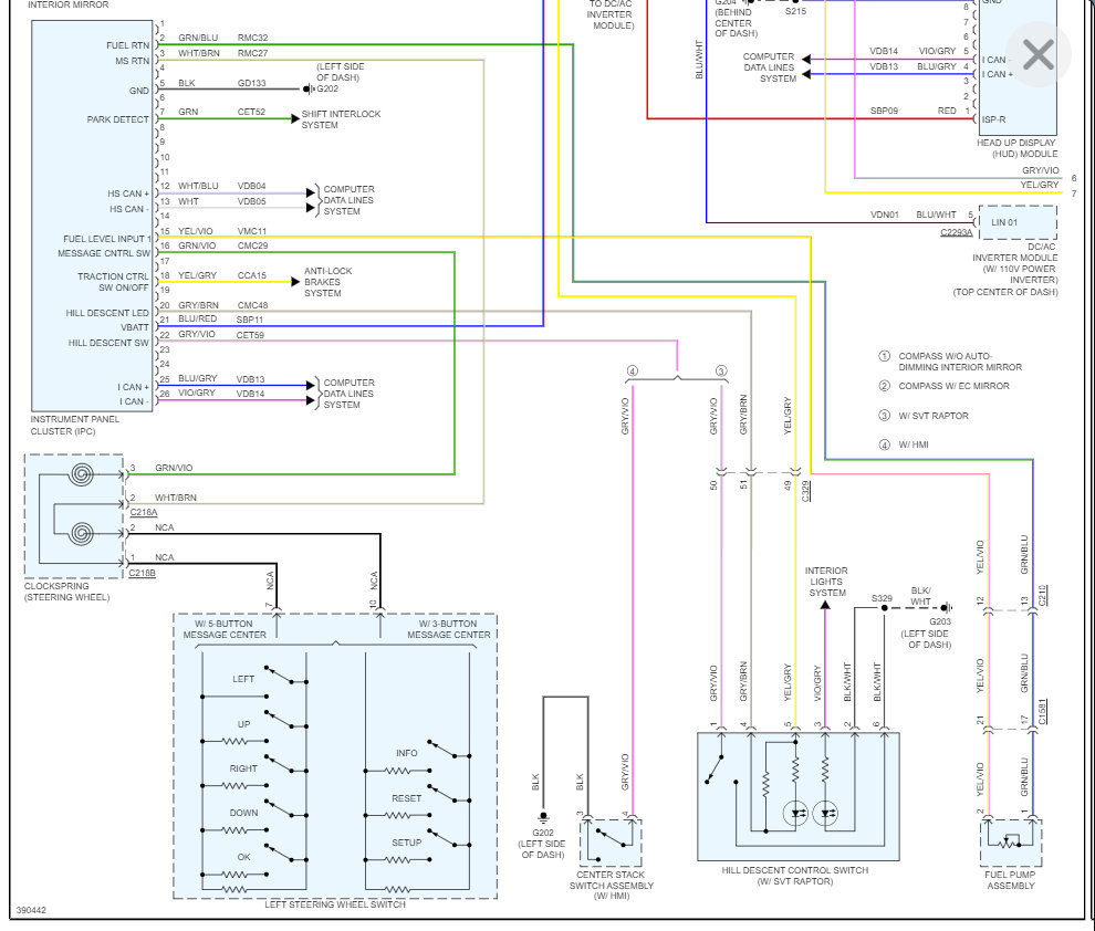

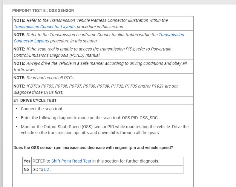

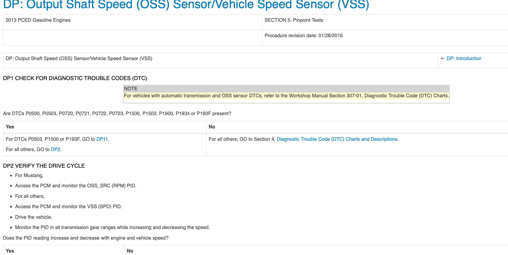

Just to be clear, when the OSS stayed flat, do you mean it just did not jump up and down like the VSS, but it has a rise and fall that was smooth in relation to the vehicle speed?
The reason I ask is because this code is telling you that the OSS gave an input of 0 RPM when the other sensor was indicating that there was RPM.
I am attaching the info for what you did, and it basically is the first part. Notice how it says both sensors needs to rise and fall with the vehicle speed.

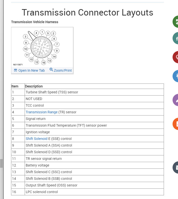

As for the connector, this is the larger transmission harness, and I am attaching the pin info.
I think the sensors on this transmission are internal to the transmission pan.
Do you have the 6R80 transmission?
Apr 23, 2022 at 5:07 AM
DGREGORY70
  • 46 POSTS
I'm not sure what Transmission it has off hand. As for the OSS PID it didn't do anything or show anything at all, while the VSS was moving up and down. Just so you know, I attached the chitons page I was looking at. So, if it didn't show anything does that mean it's the sensor?
Apr 23, 2022 at 8:25 AM
Perfect. That is what I attached the last time as well, so we are on the same page.
Correct. If it didn't move at all then that is the cause of the code as the code is telling you that the PCM didn't get any signal from the sensor when the other one was showing RPM.
Normally this is a sensor but that is why we would do the rest of the testing because it could be a wiring issue or even a PCM issue but that is less likely.

Hey, I just wanted to update you on this issue. I’m pretty sure it’s the OSS sensor. I then discovered it was internal to the transmission and realized I wasn’t going to be replacing it myself. So, I called a local transmission shop to get an idea of the cost and he said it was about 1600 for him to fix because it was part of the valve body, not a separate part. But he told me to call Ford first because they have a “customer satisfaction program” for this issue, which was something I’d never heard of. Anyway, the dealership is looking at it tomorrow and as long as the code is still present, and the VIN and mileage is what I told them they’ll take care of it.
Just wanted to let you know and thank you for your help.
Apr 28, 2022 at 12:07 AM
Oh wow. I didn't know they had this either as I looked for TSBs and didn't see any. However, most likely this is just a known issue that they are sensitive to and will help when one fails, or I just missed the TSB.
However, I agree that this sounds like it as well. Thanks for the update and let us know what they find with this as I am sure that it will help others in the future.
