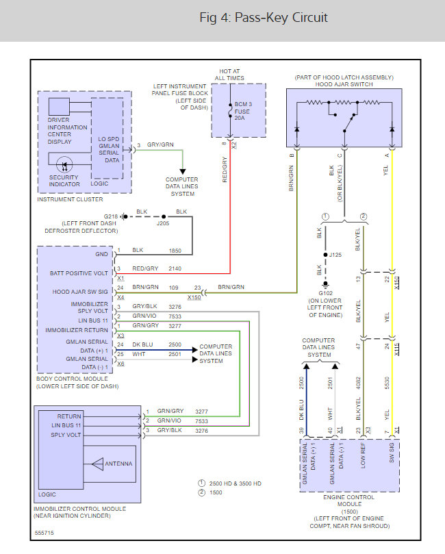

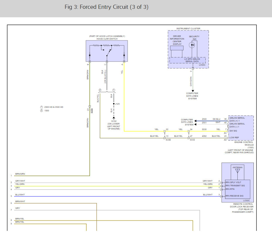

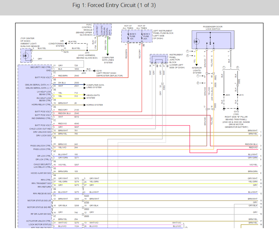

I have a 2018 Chevy Silverado Z71 4x4. When I turn off the ignition, intermittently I cannot restart the engine for 10 minutes. All lights on the dashboard light up, to include the security light, and work normally even though the engine will not crank. There are no warning lights or alarms before or after I turn off the ignition. After 10 minutes the engine cranks and starts normally. Remote start is inop for the 10 minute interval. Using my spare key and FOB does nothing, for 10 minutes.
I have had it to 2 dealers and both say there are no trouble codes, they cannot duplicate the no crank condition, and the system is working fine. Since it usually does it upon returning home I thought it was the vibration from the dirt road I live on. Not the problem. Then I thought my electric gate or garage door opener was the problem (one service tech also thought that was the problem). Not the problem either. It is now intermittently doing it everywhere I go, not just my driveway.
Jan 25, 2019 at 2:51 AM
  • 55,421 POSTS

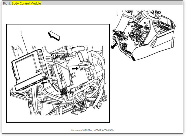

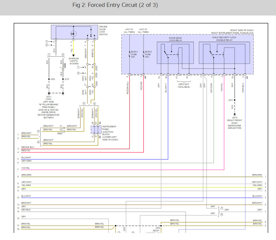

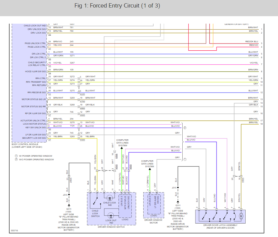

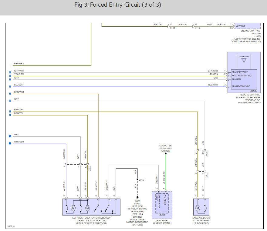

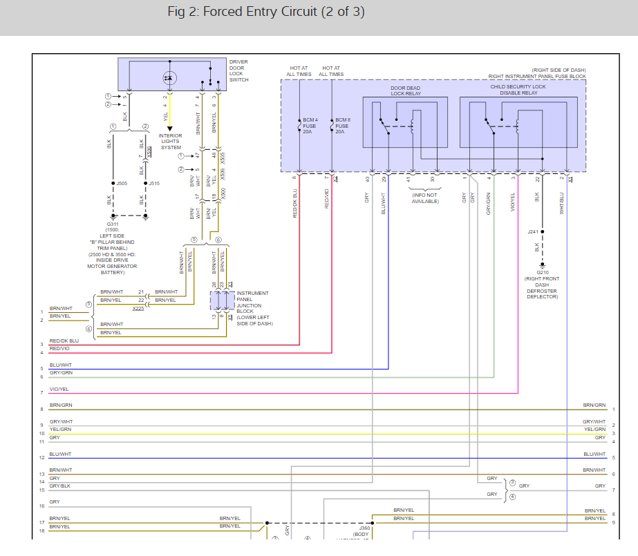

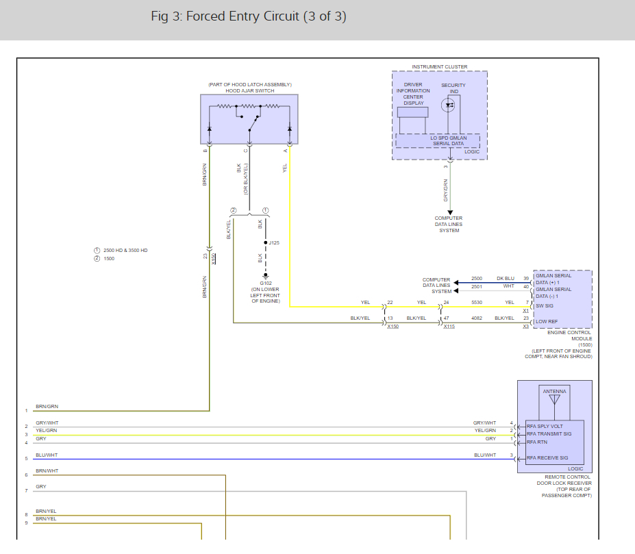

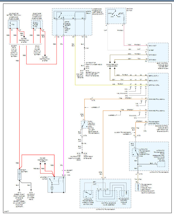

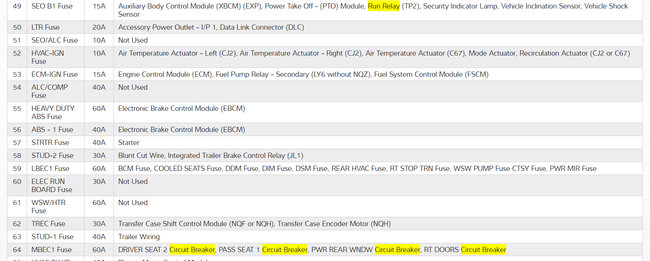

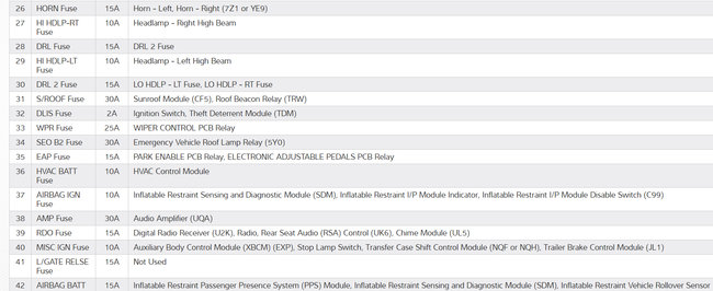

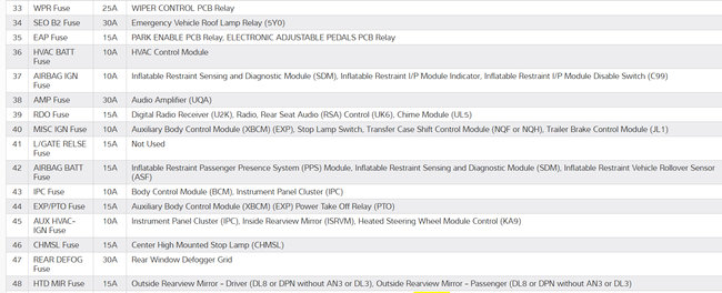

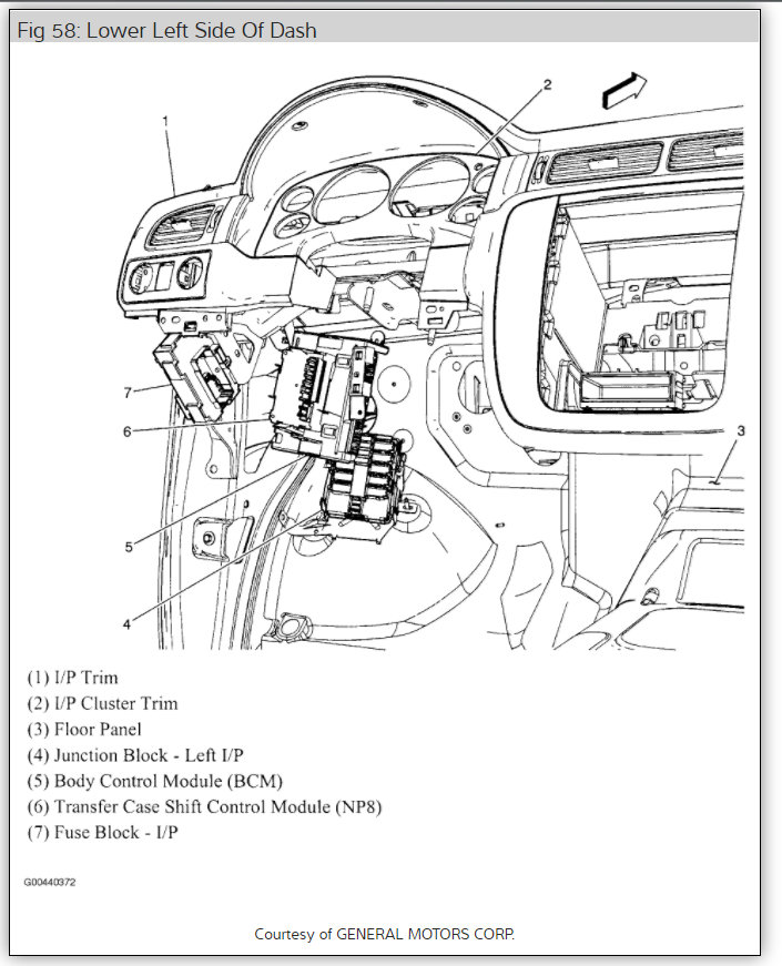

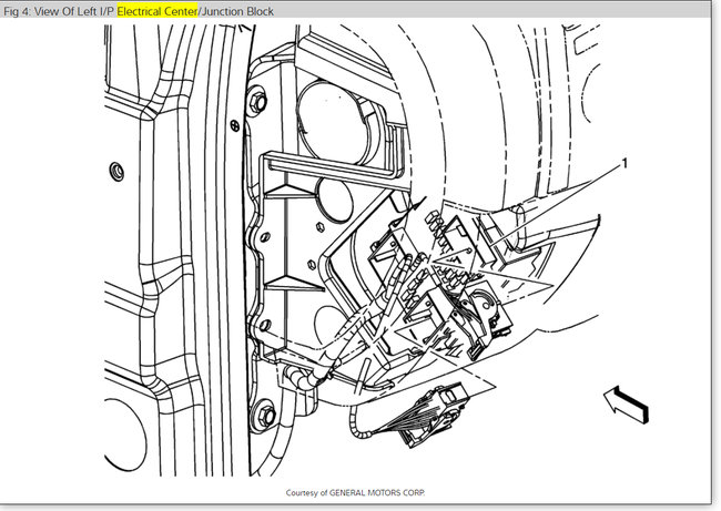

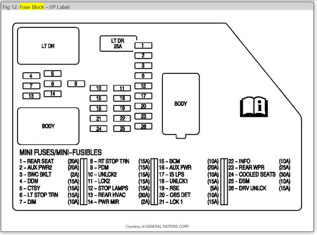

It sound sliek the BCM is having a problem which is where the security is held. The 10 minute reset gives it away to me. Here are the security and immobilizer wiring diagrams so you can see how the system works with the BCM location so you can change it out. It will need to be programmed in should cost about $130.00.
Check out the diagrams (Below). Please let us know what you find. We are interested to see what it is.
Jan 26, 2019 at 4:13 AM
HUNDS
Thanks for the help. The wiring diagrams are particularly helpful since GM will not release data for 2018 service manuals to Helm for sale to the public until Apr 2019. The dealer service dept. explanations were just not satisfactory. I'll let you (and the dealer service techs) know what I find.

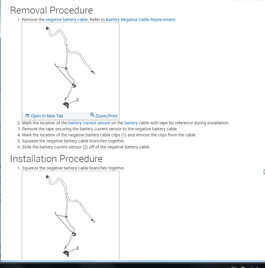

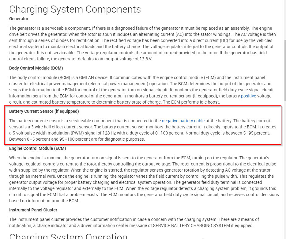

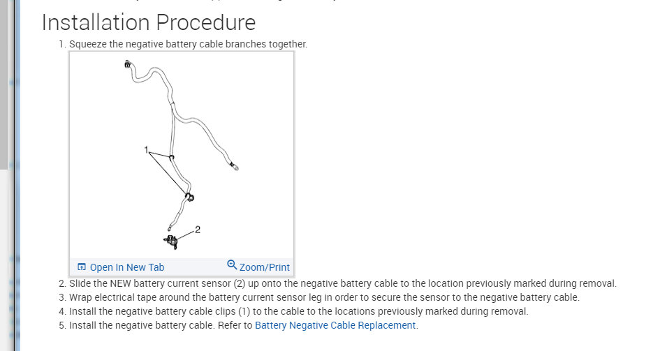

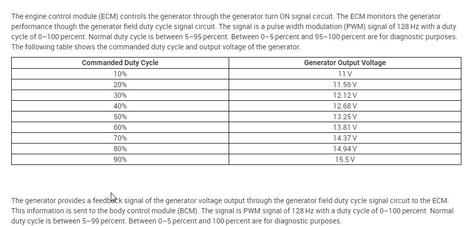

We need to determine if your vehicle has a battery sensor on the negative battery terminal of the battery.
This is used to determine the load on the battery so that it knows how much to duty cycle the generator. In other words, when all the accessories are turned off the draw on the battery is low and so the voltage regulator is duty cycled low. When you add the accessories the duty cycle should go up so that the voltage regulator puts out a higher voltage. The fact that it is dropping when you add the accessories back in, show that the regulator is not increasing the output. This is either due to a faulty regulator or the battery sensor is not accurate.
You can verify this by monitoring the voltage in the BCM with a scan tool.
Let me know what questions you have. Thanks

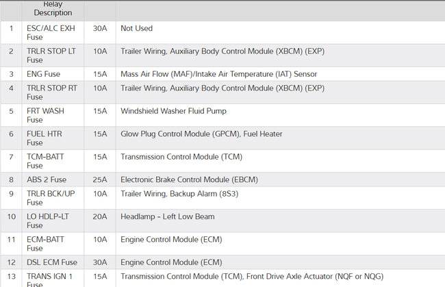

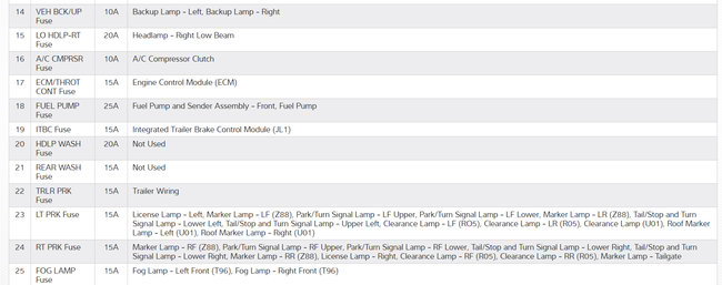

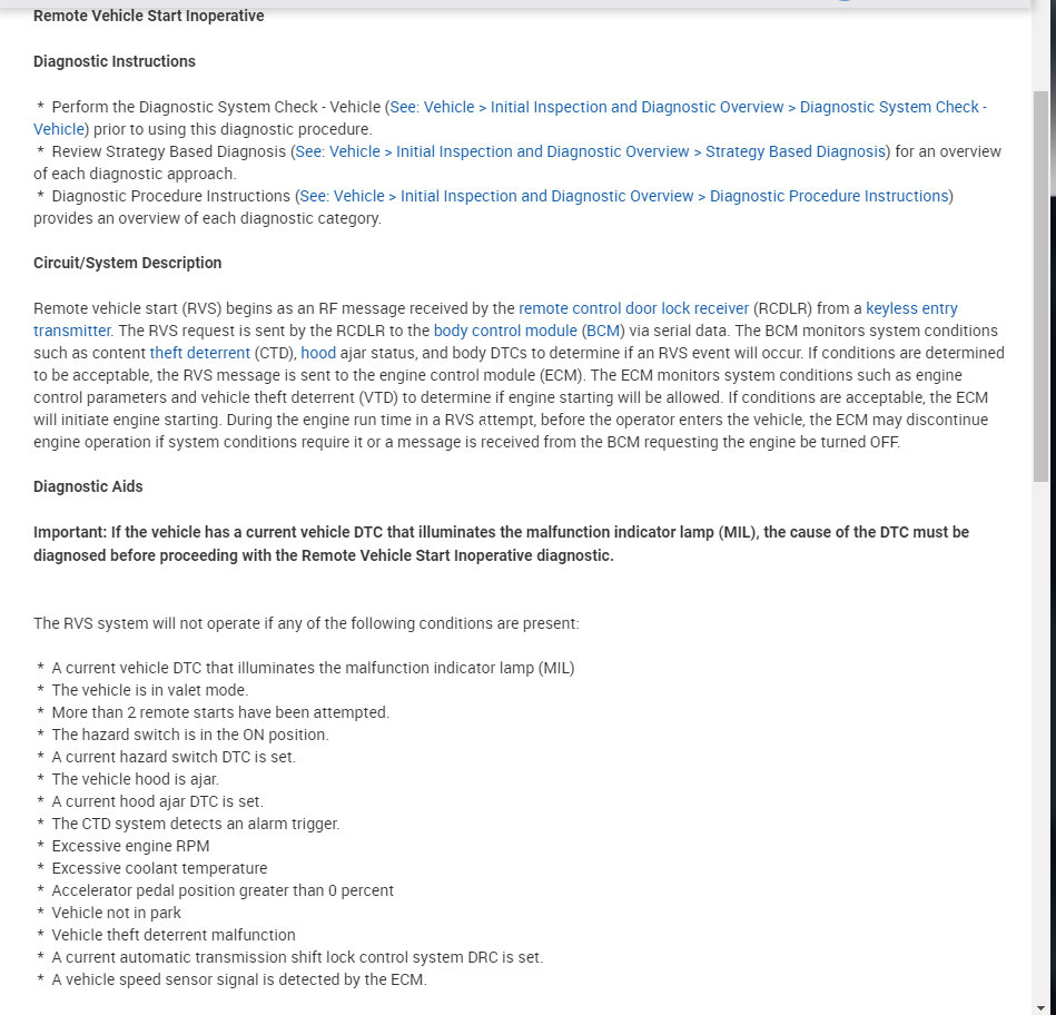

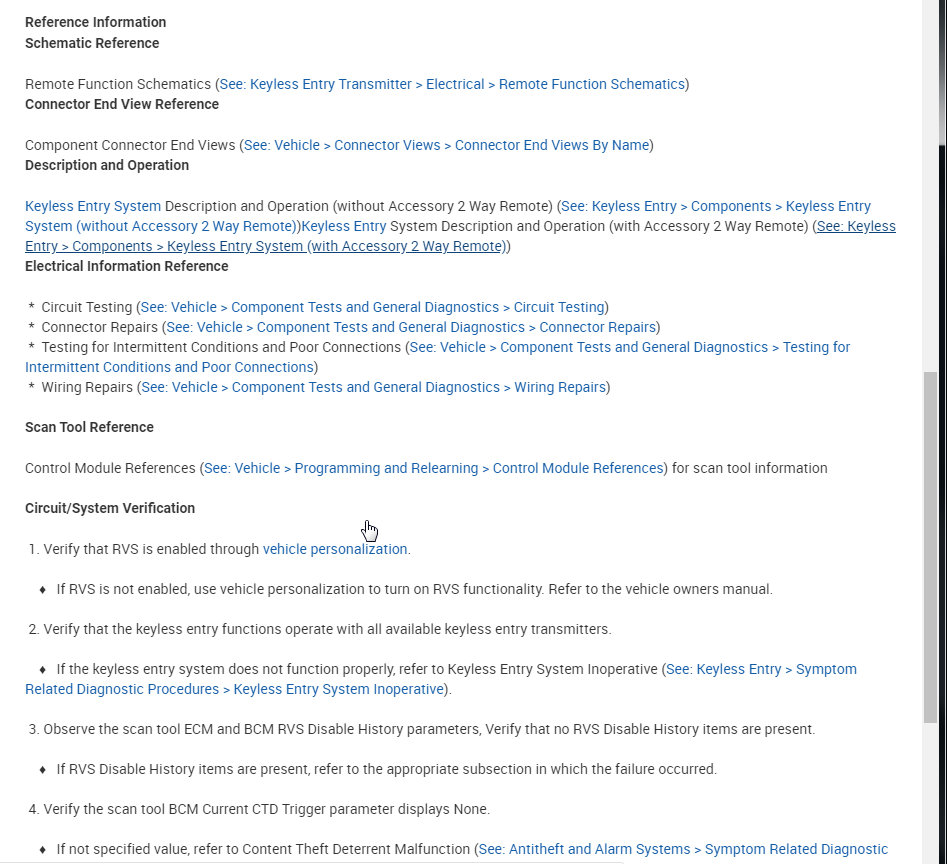

When i try to use my remote start the fuel pump primes but the engine does not turn over.
Jan 25, 2021 at 3:38 AM (Merged)

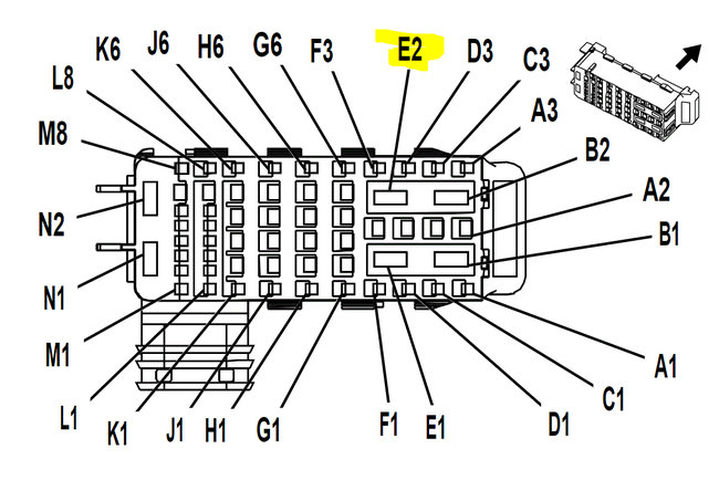

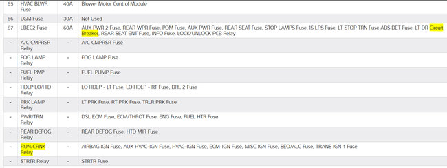

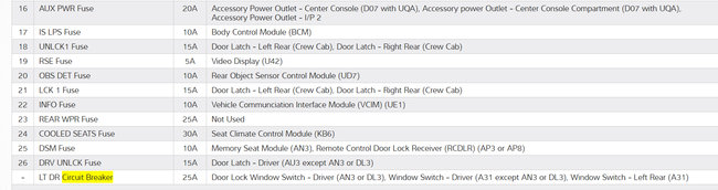

There are a number of reasons that this happens. See the attachment for the list of inhibit events. Basically there is one of these that is causing the remote start from starting the engine.
There is no easy way to know which one other than checking each of them. Let me know if you have questions. Thanks

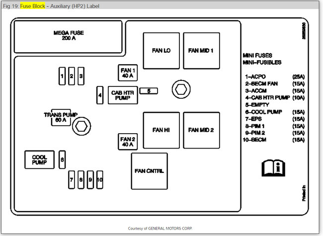

TWY
Engine does not turn over but lights come on. I jumped in to go down to the store and it started no problem but then shut off and now will not start again. Checked the fuses and all seem to be fine not sure what is wrong?
SATURNTECH9
  • 30,869 POSTS
Can you hear the fuel pump run in the tank for 5 seconds when the key is turned on with cranking the engine over? If not lets check the fuel pump relay. Here is a guide to help test the relay with the location below.
This guide can help as well

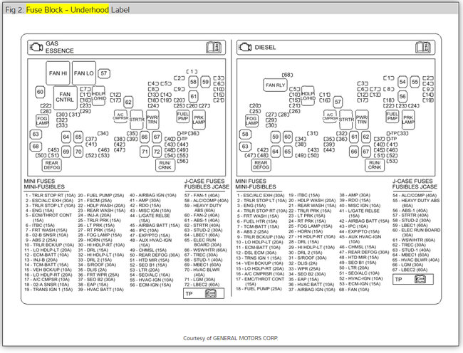

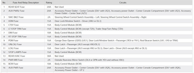

BGUIDRY84
Hello, when I tried to start it this morning it would not turn over. I have good voltage, lights, radio and other accessories work find. When I turn the key all I hear is a humming sound for a couple seconds (I'm assuming that's the fuel pump). Could it be the starter?
Apr 23, 2021 at 5:05 AM (Merged)
  • 110,243 POSTS

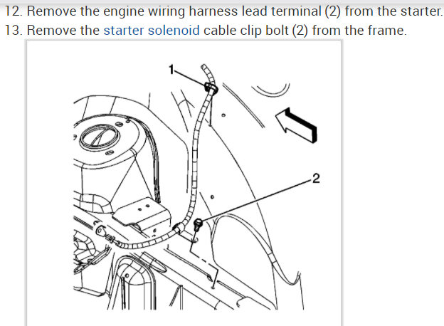

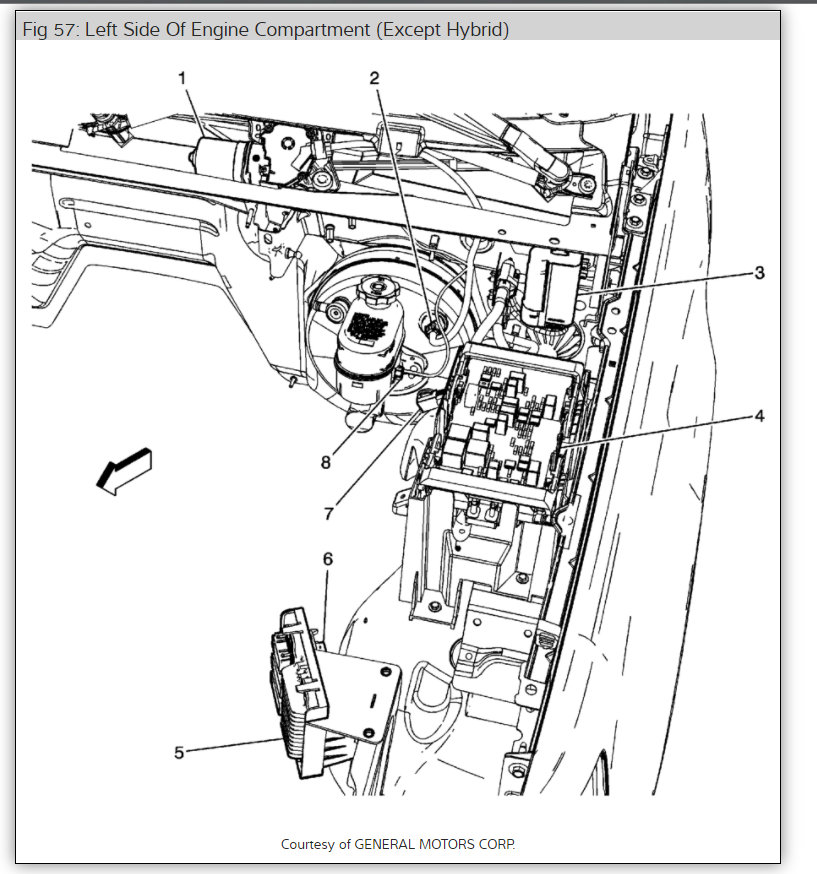

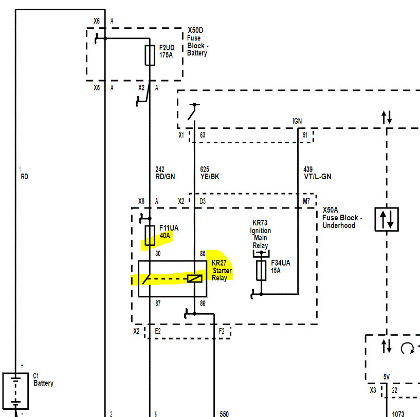

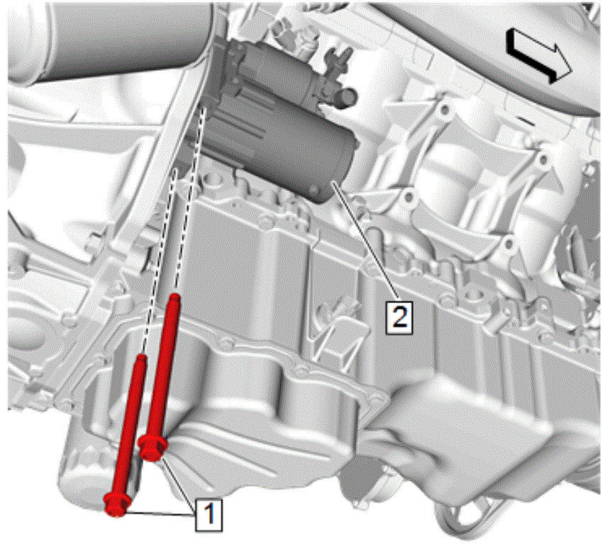

It could be the starter. Let's check a few things first. There is a 40amp starter fuse in the under hood fuse box. I did my best to help you locate it. If you look at pics 1 and 2, they show the wiring schematic (pic 1 and highlighted) and pic 2 ( highlighted the fuse). See if the fuse is good. If it is, confirm there is power to and from it. Here is a link to help with that:
If it checks good, switch the starter relay with a different one in the box having the same part number.
If that doesn't change things, we need to see if the starter motor is getting power. On the starter, there will be a heavy gauge wire that always has 12v right from the battery. There will a smaller gauge wire that should have 12v when the key is in the start position. Have a helper turn the key to start while you check the smaller wire for power. Here is a link to help you check the starter:
If it does have power, replace the starter. If there is no power, let me know.
Here is a link the explains in general how to replace a starter. You can use it as a guide.
___________________________________________________________

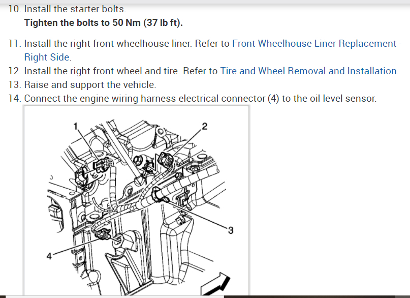

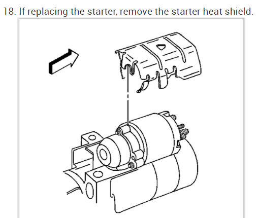

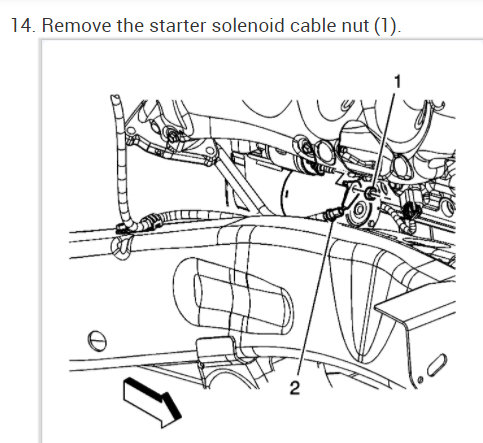

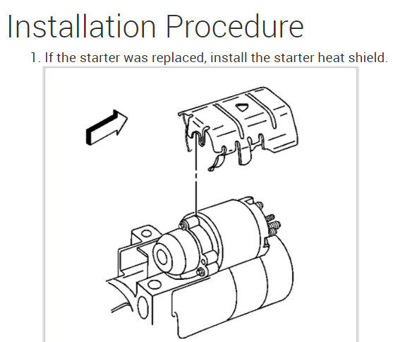

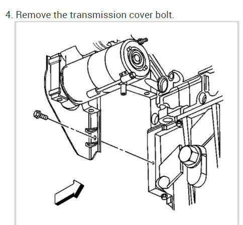

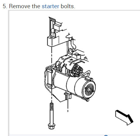

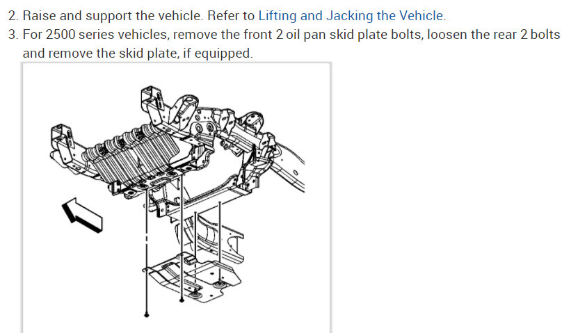

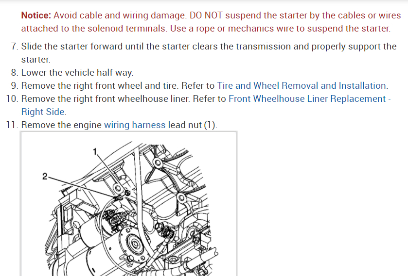

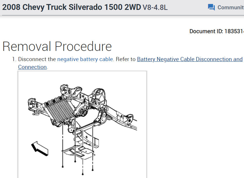

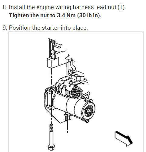

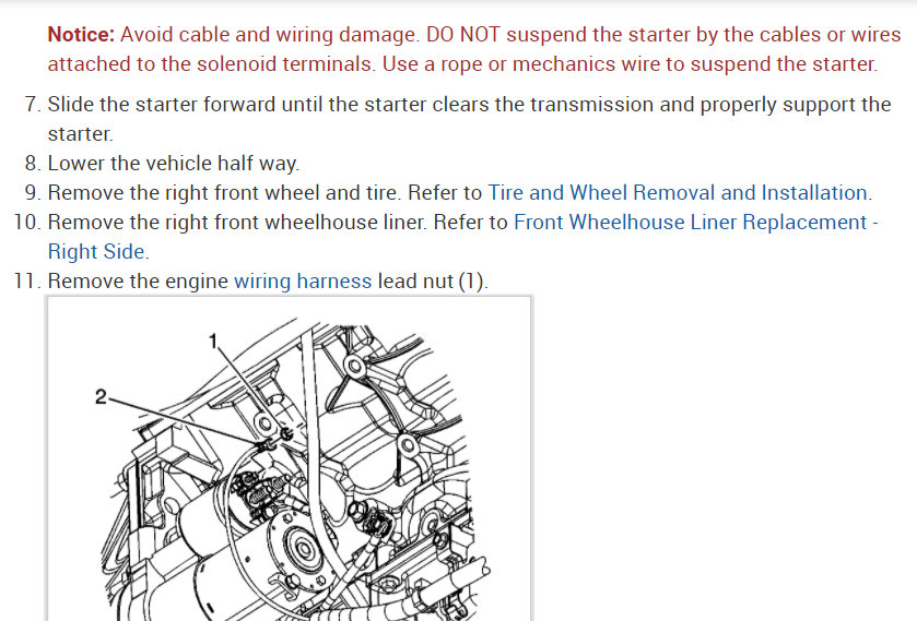

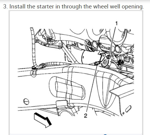

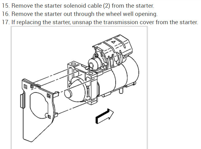

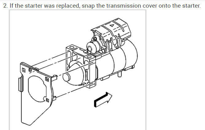

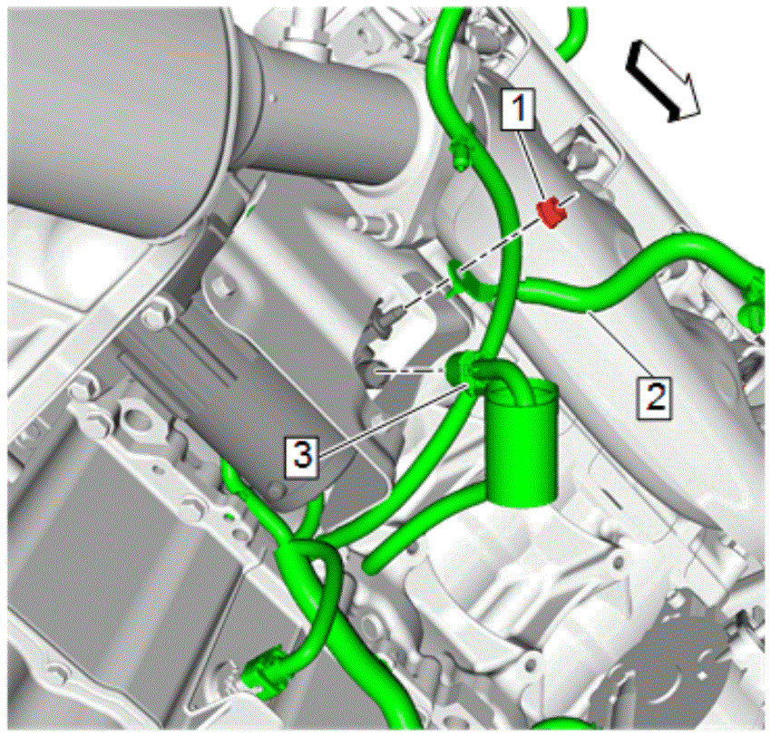

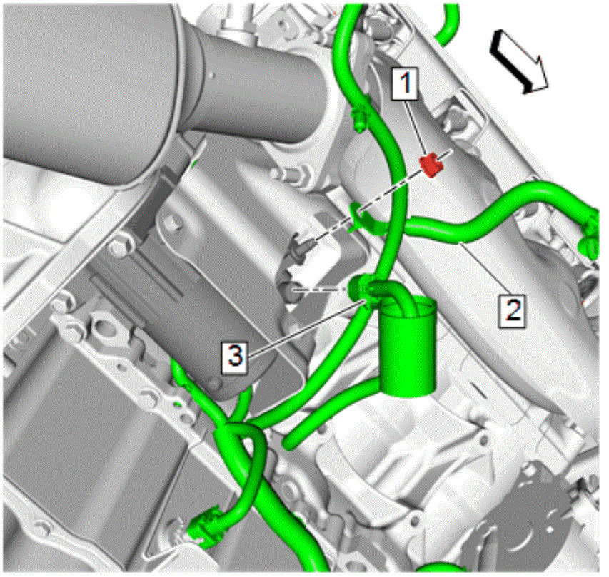

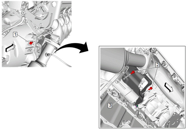

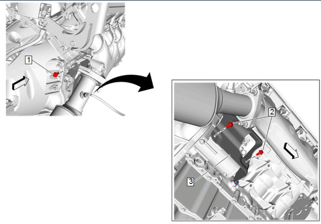

Here are the directions specific to your truck for starter replacement. The remaining pics correlate with the directions.
2015 Chevy Truck Silverado 1500 4WD V8-5.3L
Starter Replacement
Removal Procedure
Disconnect the battery negative cable.
Raise and support the vehicle
Remove the terminals from the starter solenoid. Note: The battery must be disconnected before doing this.
pic 3

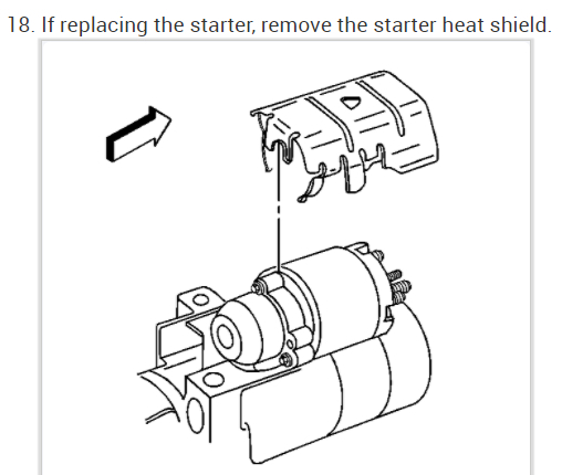

Generator Battery Control Wiring Harness Remove
Electrical connector (3) disconnect
Starter Heat shield (3) Remove
pic 4
Starter mounting bolt remove
pic 5

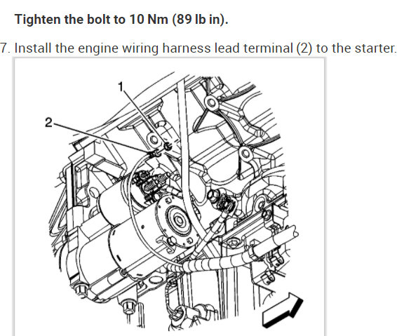

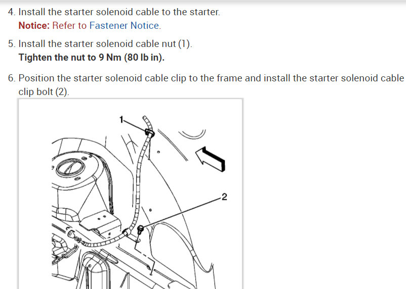

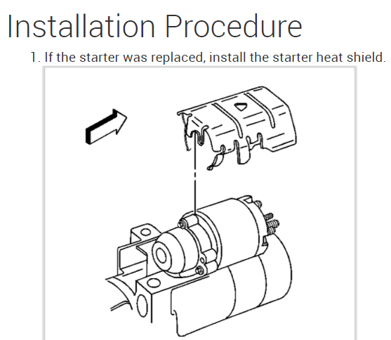

Installation Procedure
Install starter
pic 6
Starter Mounting Bolt install and tughten to 37 lb ft
Starter Heat Shield (3) Install
pic 7
Generator Battery Control Wiring Harness (2) Install
pic 8
Battery positive cable nut (1) starter solenoid install and tighten to 80 lb in
Electrical connector (3) connect
Connect the negative battery cable.
I hope this helps. Let me know if you have other questions or need help.

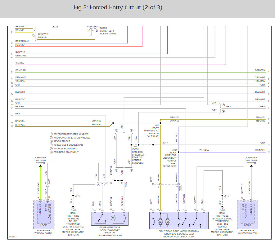

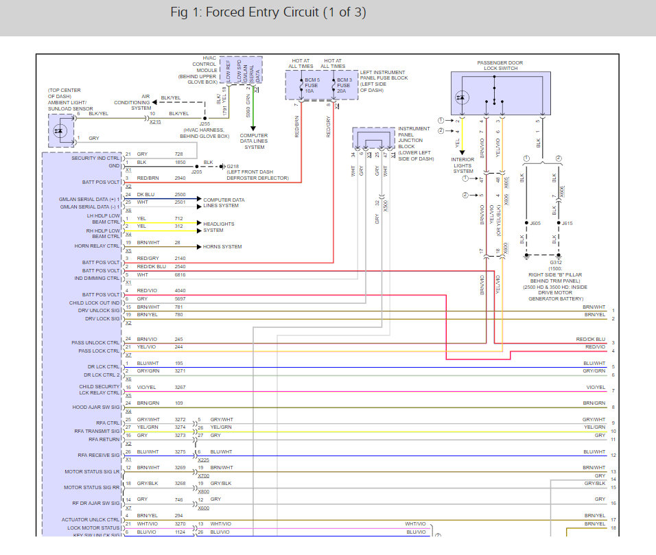

I had a garage change coil pack 8 and do spark plugs and wires now my truck listed above wont start, just ticks. he is telling me it's starter, but never had starter problems before and check engine light stays on even with keys not in ignition.

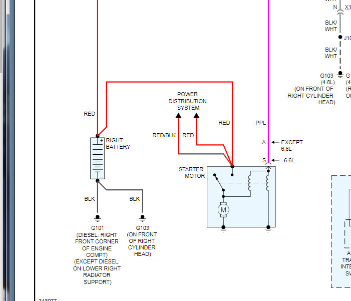

If it just clicks then this is could be the starter but if the light is staying on then we need to check codes to find out if there is another issue.
However, here is another guide that will help with this if it is a starter issue:
I attached the wiring diagrams below for us to check voltage at the starter as well if we get to that point.
Basically, i think we need to start with codes and go from there. Let me know what questions you have. Thanks
