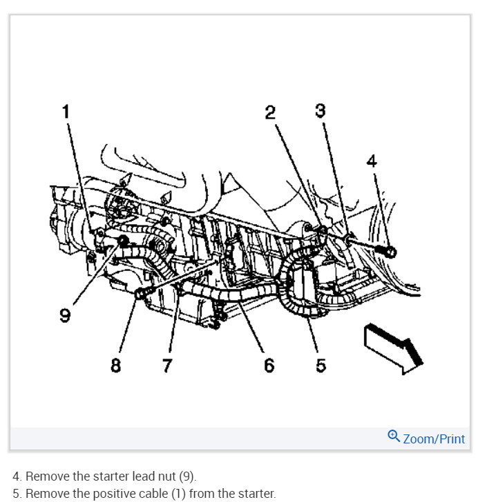

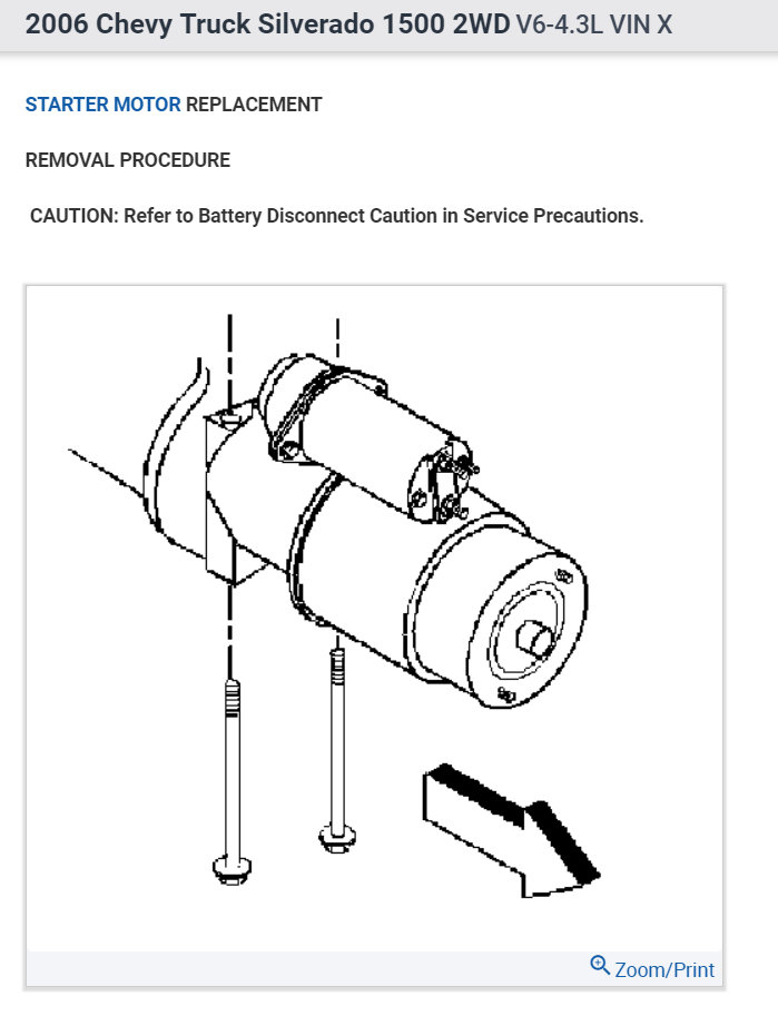

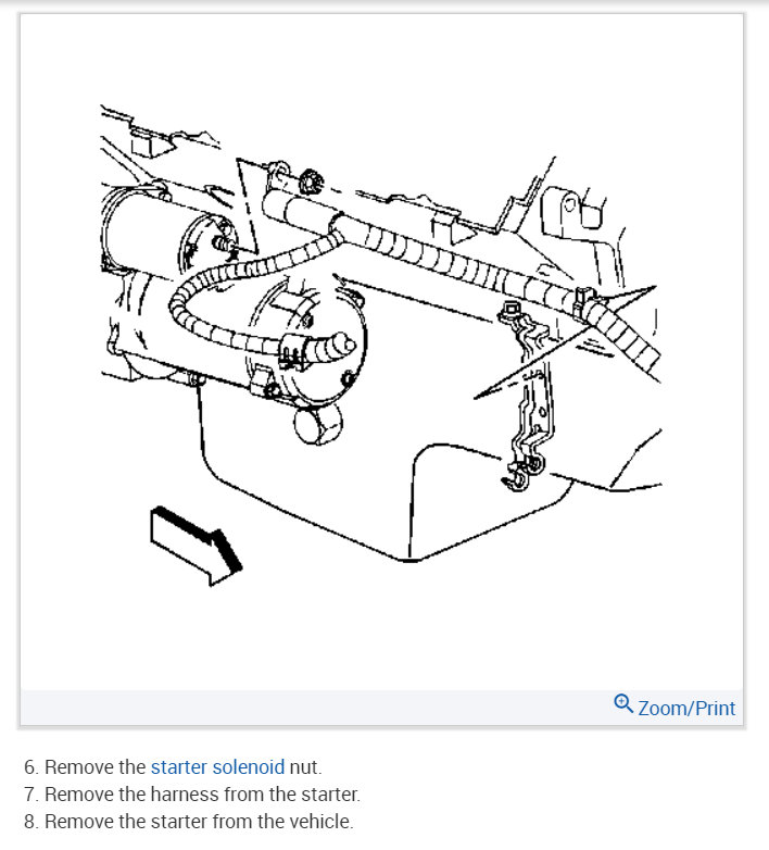

It sounds like the starter is going out or a battery that shorts internally when it gets hot. When it will not crank over try this guide to test the battery.
See if the lights stay bright when you crank it. If the do I would replace the starter. Here is a guide to show you step by step and diagrams below so you can see what it will be like for your truck:
You can get a AC Delco unit for $134.00 on Amazon
https://www.amazon.com/gp/product/B007QBU4UW/ref=as_li_qf_asin_il_tl?ie=UTF8&tag=2carprcom-20&creative=9325&linkCode=as2&creativeASIN=B007QBU4UW&linkId=a993f6e9122be849361b4bf806afb9df
I do not think the blanket will help I would take that back. Check out the diagrams (below). Let us know what happens and please upload pictures or videos of the problem.

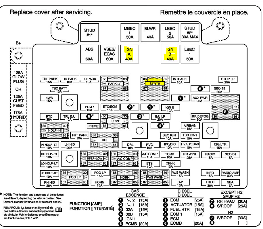

  • 110,248 POSTS
Lets focus on one area, the starting issue. Once that is figured out, chances are it will fix the other issue.
First have you checked for diagnostic trouble codes? IF you haven't you really should scan the computer. I realize most people don't own a scanner, but often times, a parts store will do it for free.
Next, we need to see if there is power to the starter. The large wire at the starter gets 12v all the time, and is most likely not the problem since you can jump it there. The smaller wire on the starter (S - Terminal) should also get 12v but only when the key is in the start position. You will need a helper to check that.
Next, confirm the following fuses are good in the under hood fuse / relay box. See pics 1 and 2. I also need you to check the starter relay.

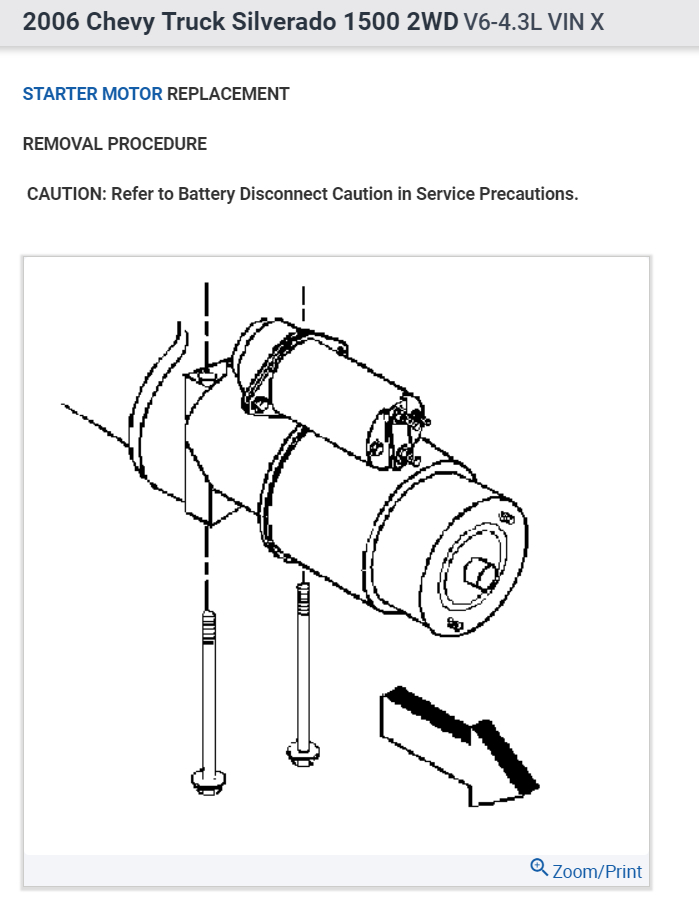

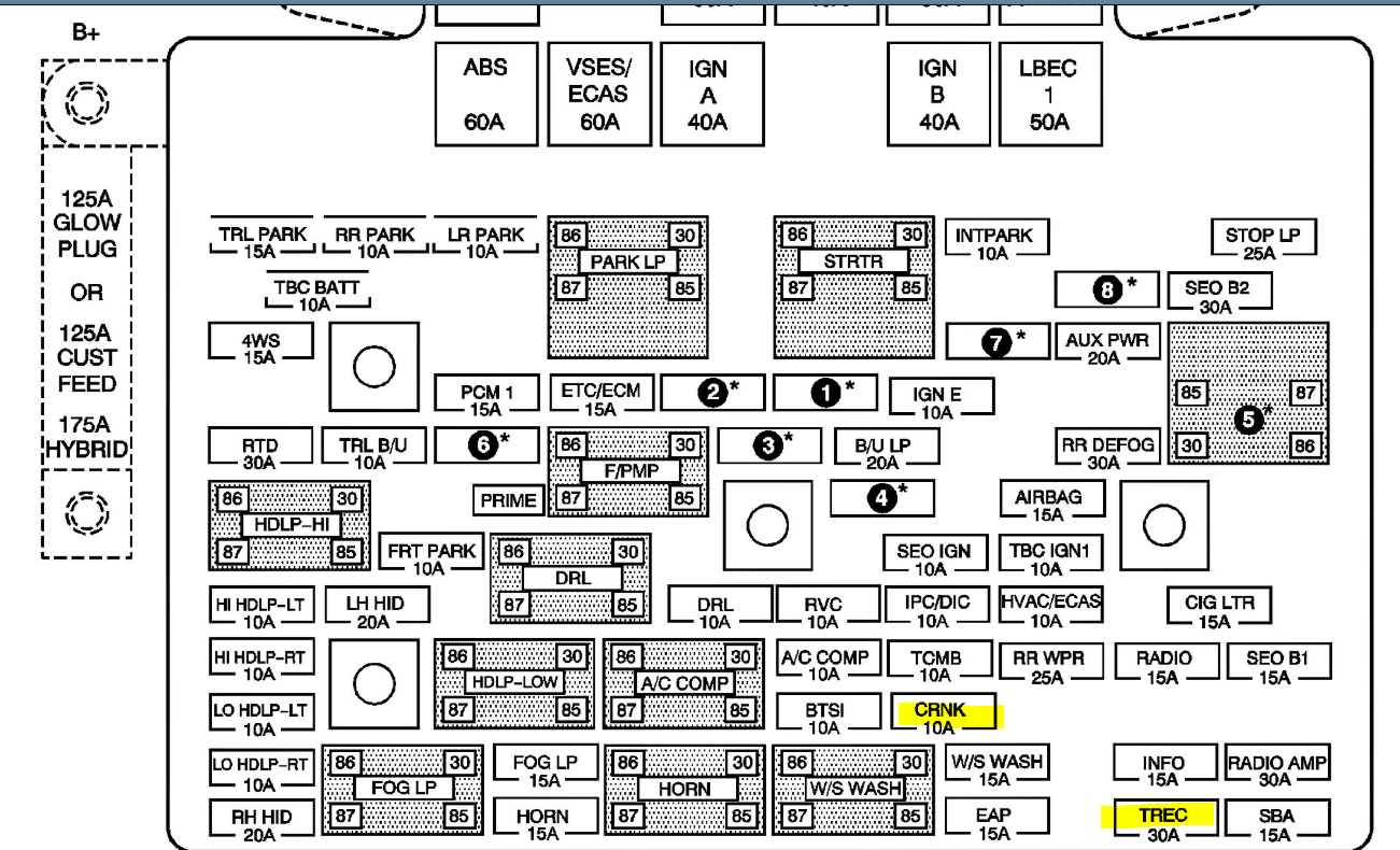

  • 110,248 POSTS
I have attached a few pics below. Before going to the relay sockets, check the fuses I circled in the pic.
look at pic 4. I placed a + where there should be power when the key is on but not in the start position. The two sides of the relay that I circled power when the key is in the start position and allows power to flow to the starter relay.
One other thing. Confirm the wires on the PCM in pic 3 are not damaged. I have seen them fail.
