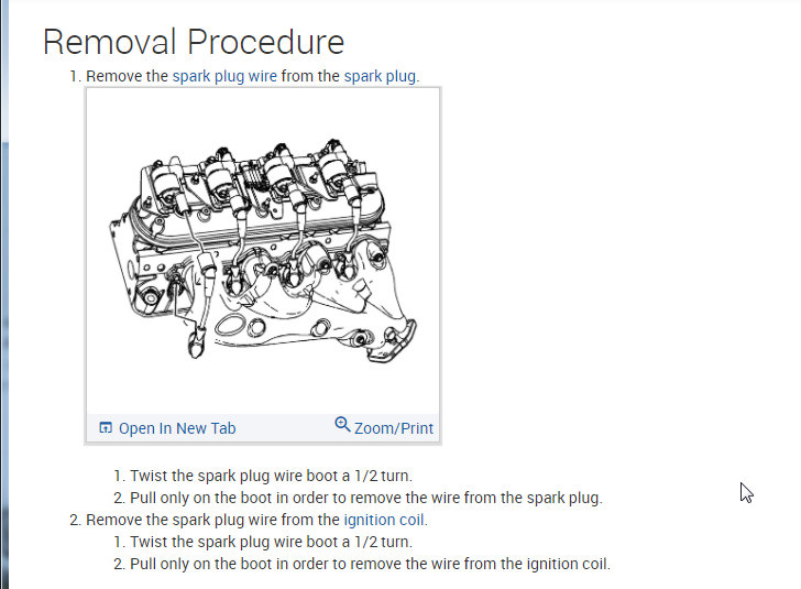

Okay. So you have a dead miss on cylinder 8. Have you looked under there to make sure the spark plug boot is fully seated? The most likely cause of this is either the coil was not the issue and it still have another issue or when he reinstalled it, the plug wire/boot did not clip onto the plug and it is misfiring.
