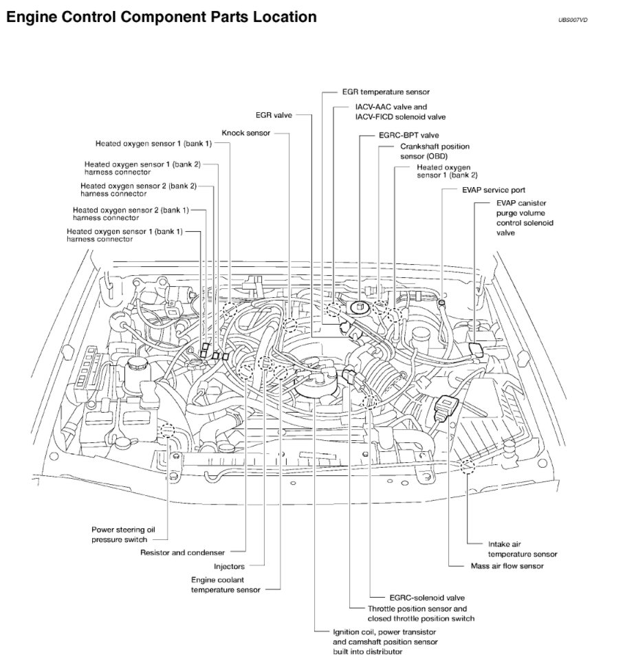

Hie my wife drives a nissan xtail 2004 a/t recently the car wont start for 3 days now and we thought the radio we changed before caused the problem and we did put back the original radio but still it didnt start, the plugs wont fire the starter cranks but the engine wont fire we checked the fuses all are well fuel full now we dont what to do please help.

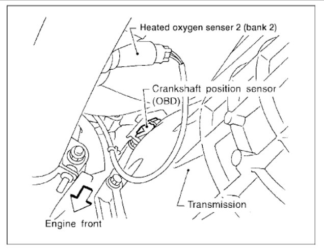

This sounds like you have a crankshaft angle sensor that has gone out. Here is a guide that will show you what you are in for when changing the sensor.
and
Here are some diagrams that will show you what the job is like on your car.
You will need to lift the car to change it becasue it is up on the bell housing of the transmission. Here is a guide to help you do it safely.
Please let us know what happens so it will help others.

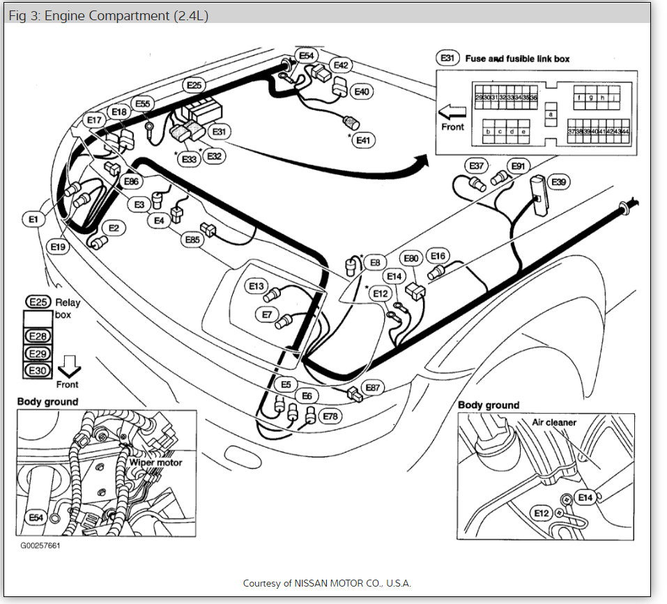

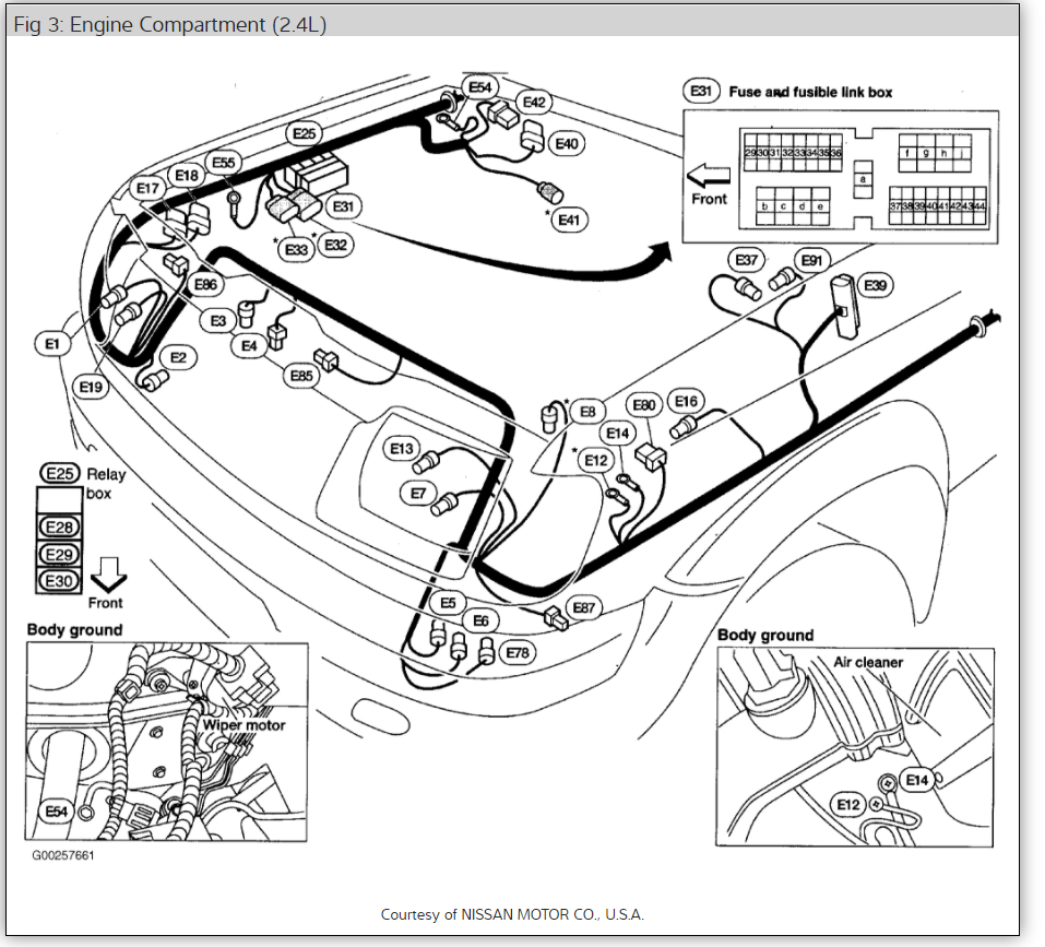

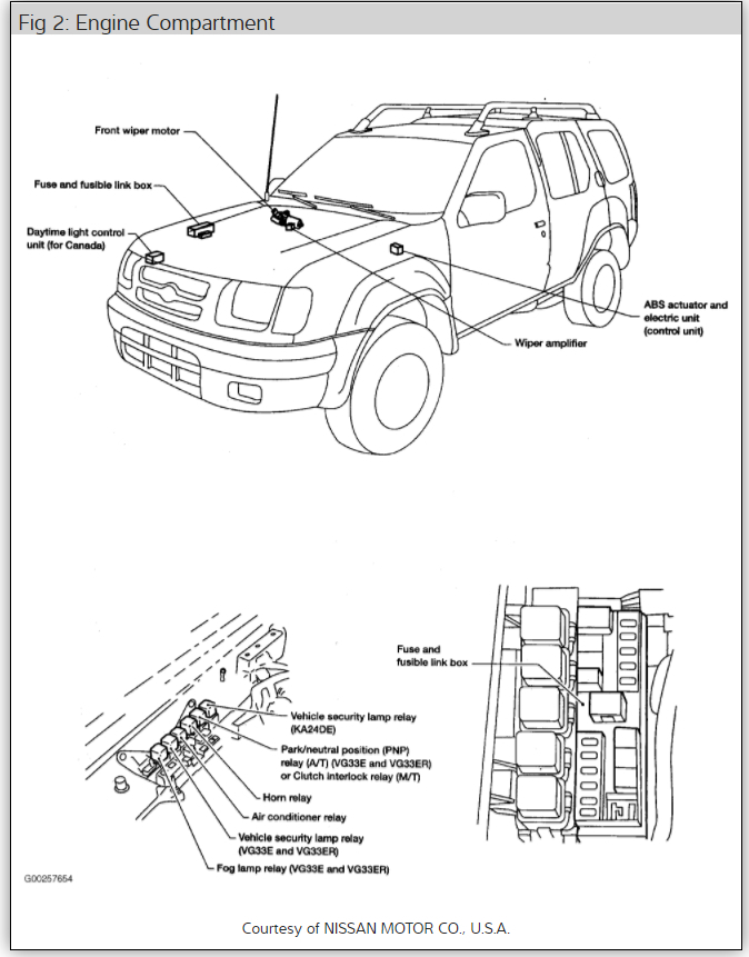

EMMANUEL KAWALA

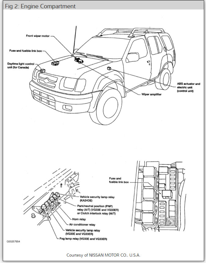

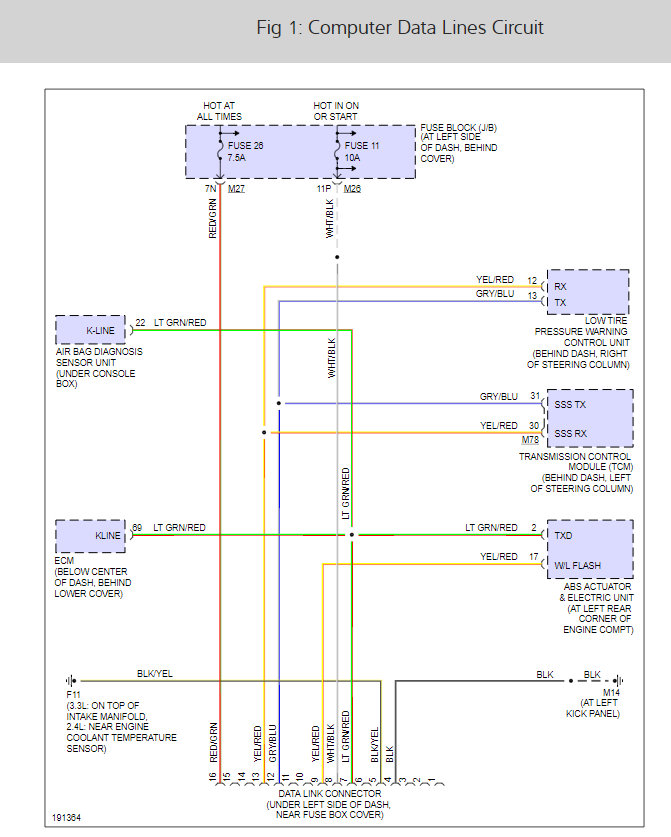

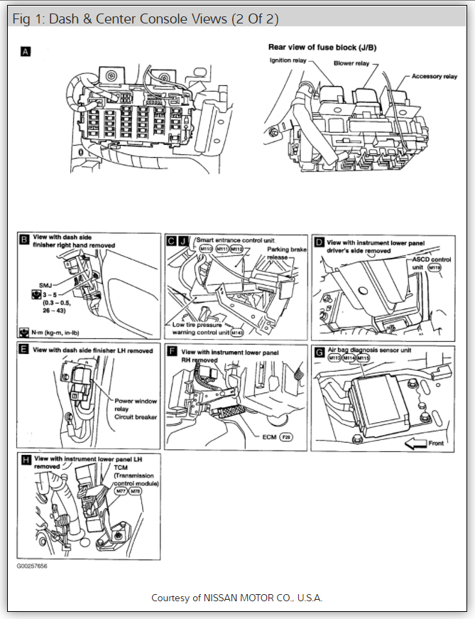

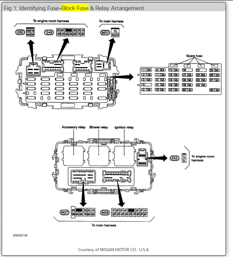

Hi, am trying to diagnose using OBDII/EOBD diagnosing equipment and it's failing to connect saying linking error what could be the problem.
-1
Monday, October 5th, 2020 AT 11:20 AM (Merged)
KEN L
  • MASTER CERTIFIED MECHANIC
  • 48,363 POSTS
It sounds like you have a fuse out here is a wiring diagrams so show you how the ALDL is wires and which fuses power it.
