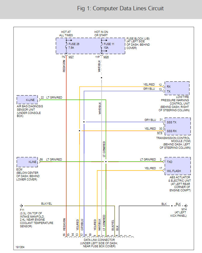

JACQUES ROELOFSE

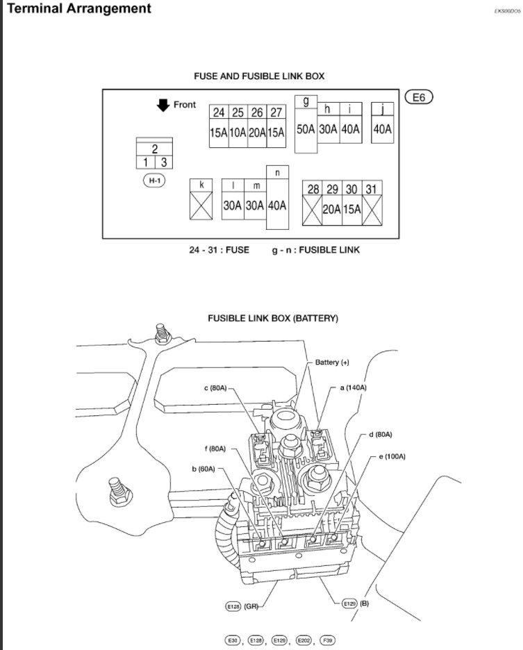

Hi all i am new. I have a big problem my engine management light does not come on even if the accessories is turn to on it work before all of the sudden it stall. Scanner cannot connect because of this and the car does not start. Any ideas and help? Please Thanks
Oct 5, 2020 at 11:18 AM (Merged)
MHPAUTOS
  • 31,937 POSTS
There should be a fuse for the DLC or the globe may have blown this will shut down the data link access in many cars. i am looking for the fuse location, but my data base is down just now, i will keep trying and advise ASAP.

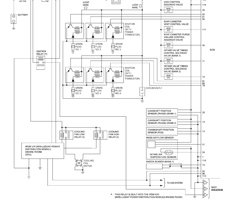

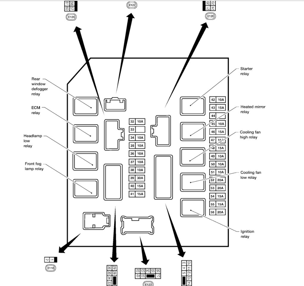

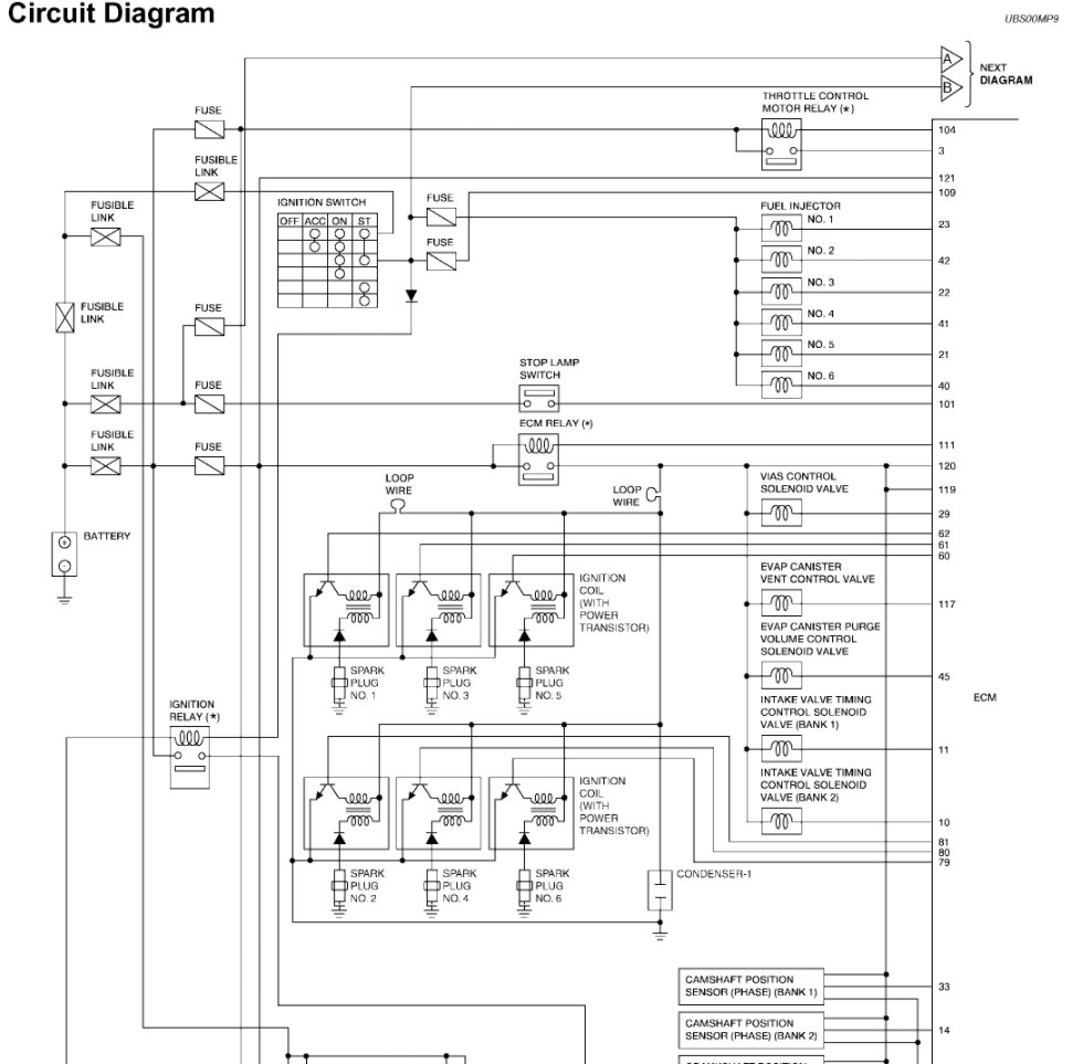

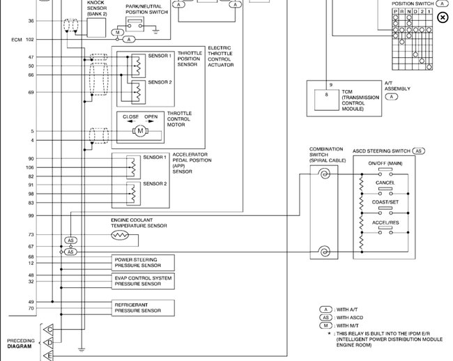

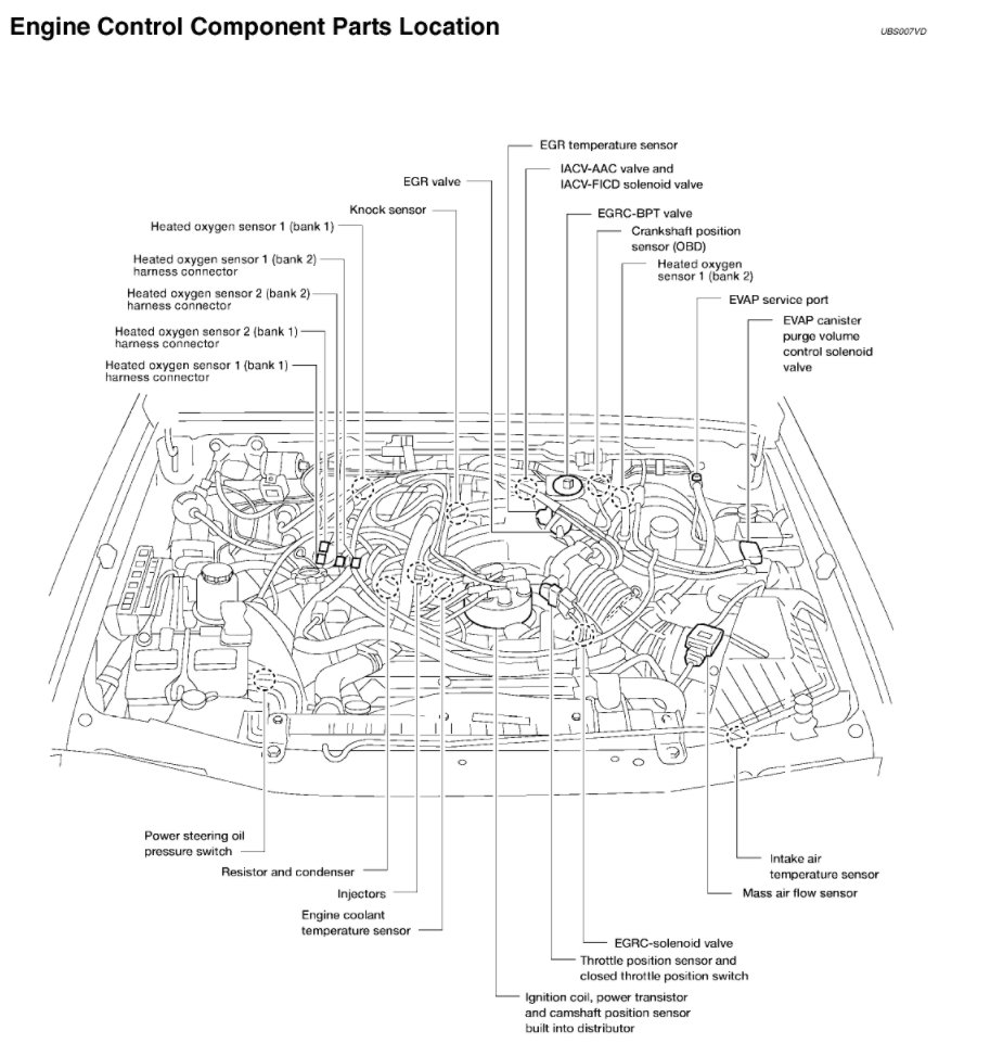

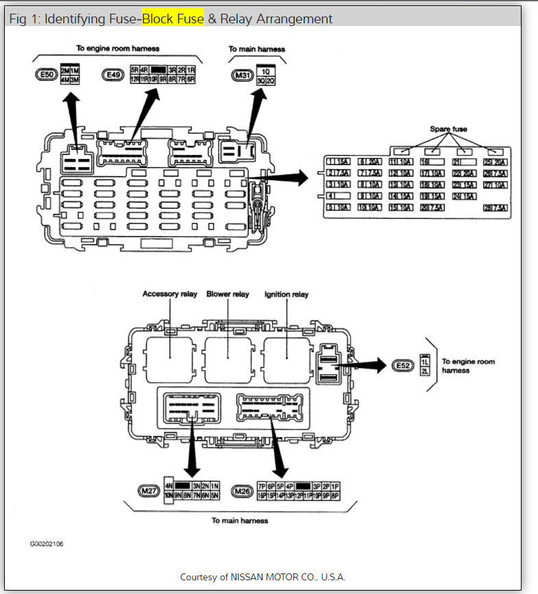

  • 54,178 POSTS
It sounds like you have one of three problems, first you have lost a fuse or relay. IF these check out okay I would suspect a burnt out ECU. Here are some guides and engine wiring diagrams (below) so we can do some testing.
and

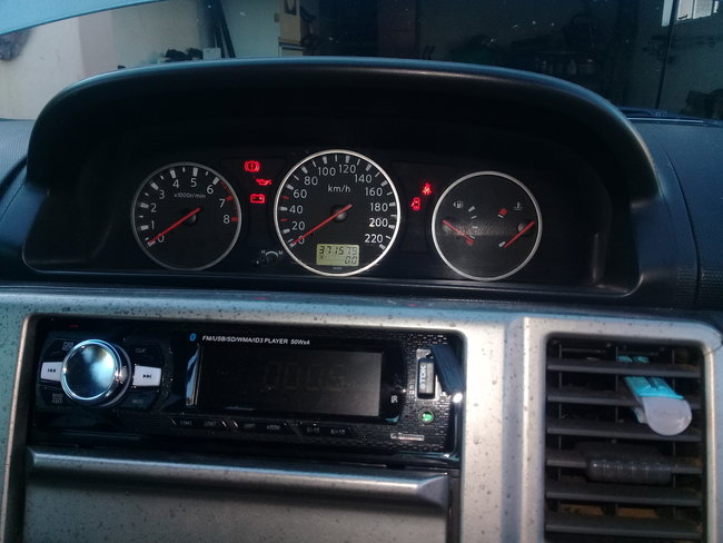

JOETECHPRO
  • 705 POSTS
Hey MICHAELHOLLAND,
Can you please confirm that the security light is out when cranking?
Example of security light in picture attached below.
When cranking this dash light should not be illuminated or the vehicle immobilizer is preventing starting.
Regards, Joe

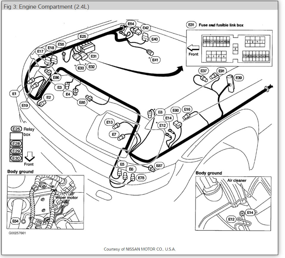

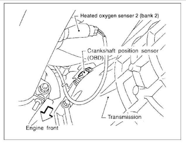

hie my wife drives a nissan xtail 2004 a/t recently the car wont start for 3 days now and we thought the radio we changed before caused the problem and we did put back the original radio but still it didnt start ,the plugs wont fire the starter cranks but the engine wont fire we checked the fuses all are well fuel full now we dont what to do please help.
Oct 5, 2020 at 11:20 AM (Merged)

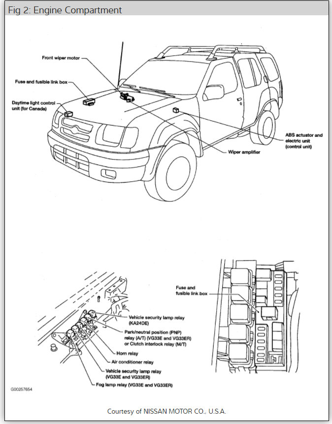

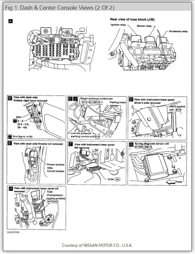

  • 54,178 POSTS
This sounds like you have a crankshaft angle sensor that has gone out. Here is a guide that will show you what you are in for when changing the sensor.
and
Here are some diagrams that will show you what the job is like on your car.
You will need to lift the car to change it becasue it is up on the bell housing of the transmission. Here is a guide to help you do it safely.
Please let us know what happens so it will help others.

EMMANUEL KAWALA

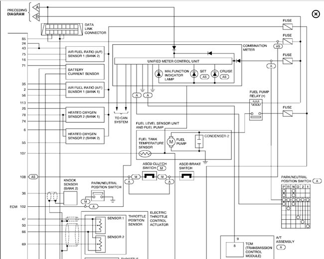

Hi, am trying to diagnose using OBDII/EOBD diagnosing equipment and it's failing to connect saying linking error what could be the problem.

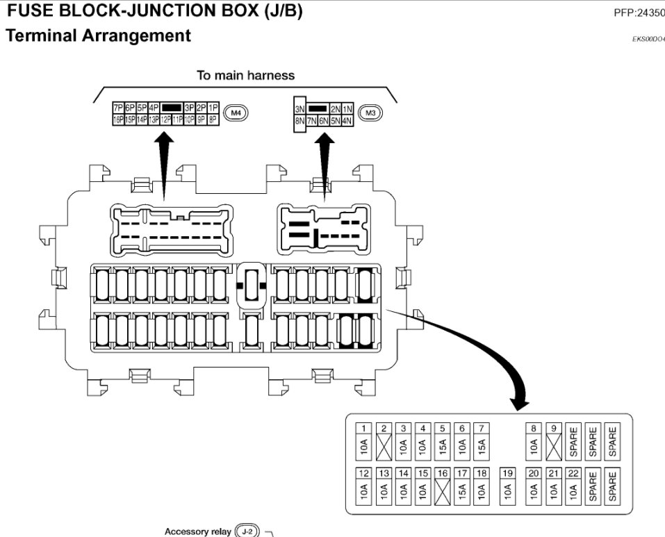

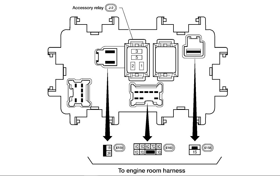

  • 54,178 POSTS
It sounds like you have a fuse out here is a wiring diagrams so show you how the ALDL is wires and which fuses power it.
