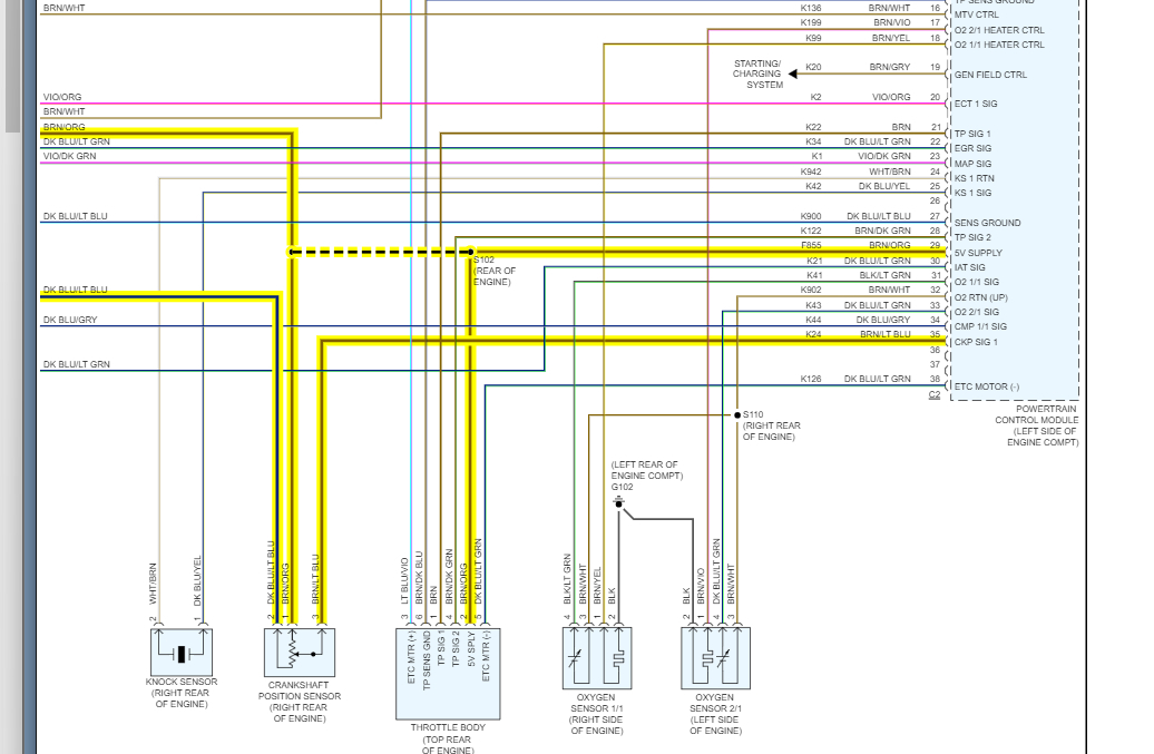

If you have no spark, then we most likely have a crank sensor issue.
Here are a couple guides that will help with this:
https://www.2carpros.com/articles/car-not-running-advanced
Basically, the crank sensor is what tells the PCM when to fire the coils so if we have injector pulse but no coils then we most likely have an issue with the crank sensor.
So, this means we need to make sure we have checked the injectors to see if they are in fact pulsing.
https://www.2carpros.com/articles/how-to-test-a-fuel-injector

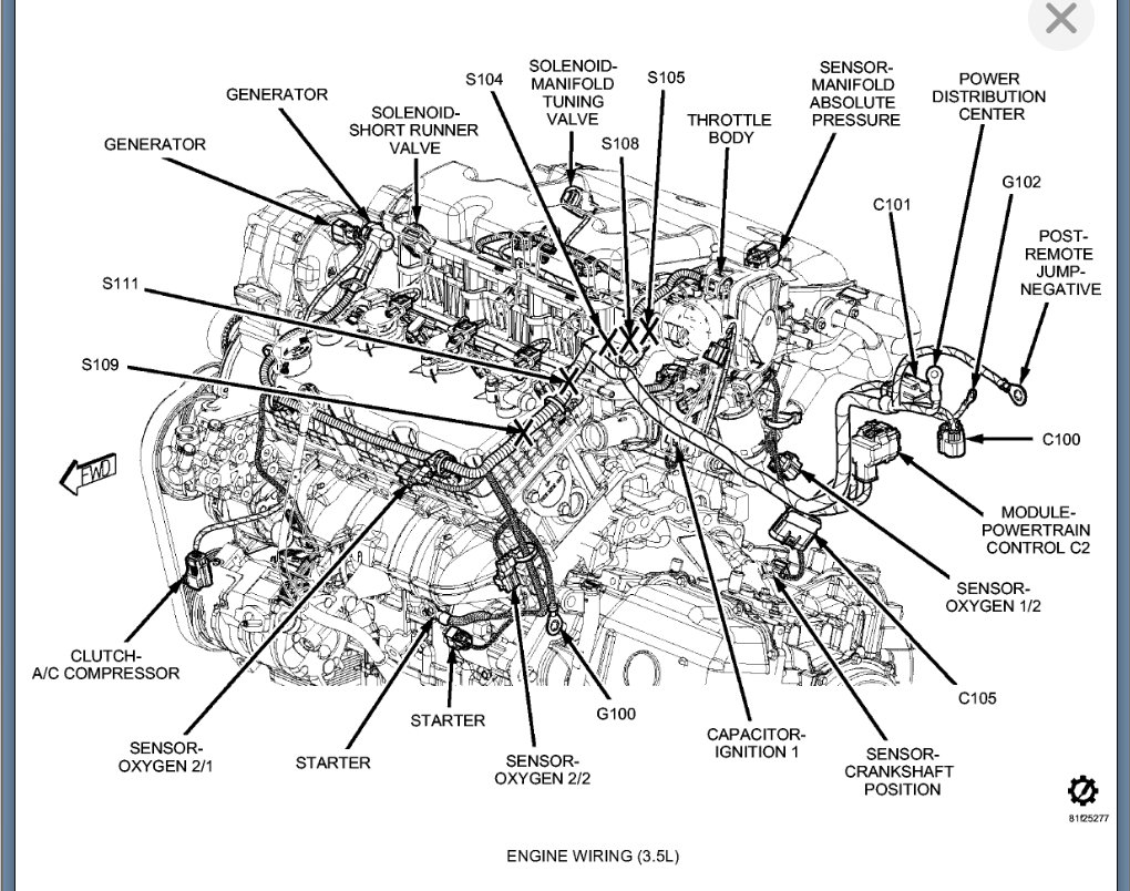

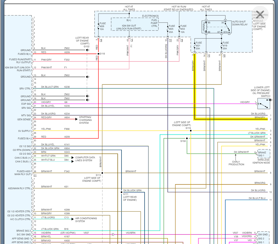

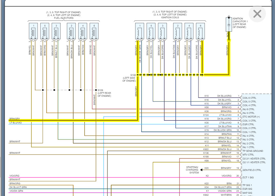

I attached the wiring diagram below but let's start with this and go from there.
Thanks

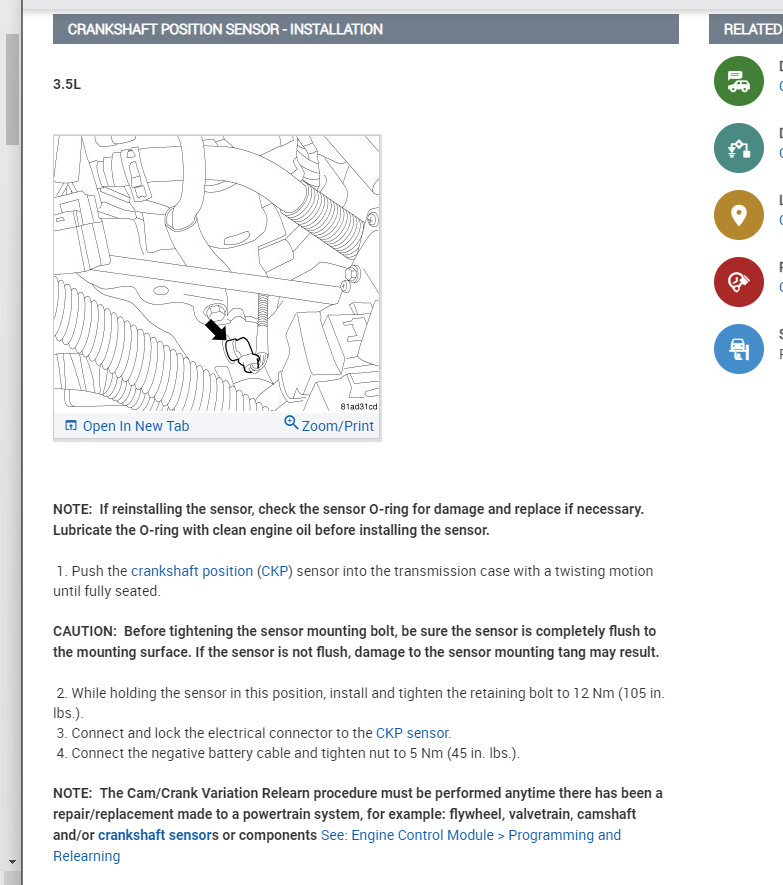

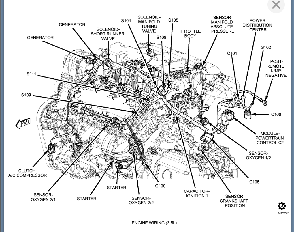

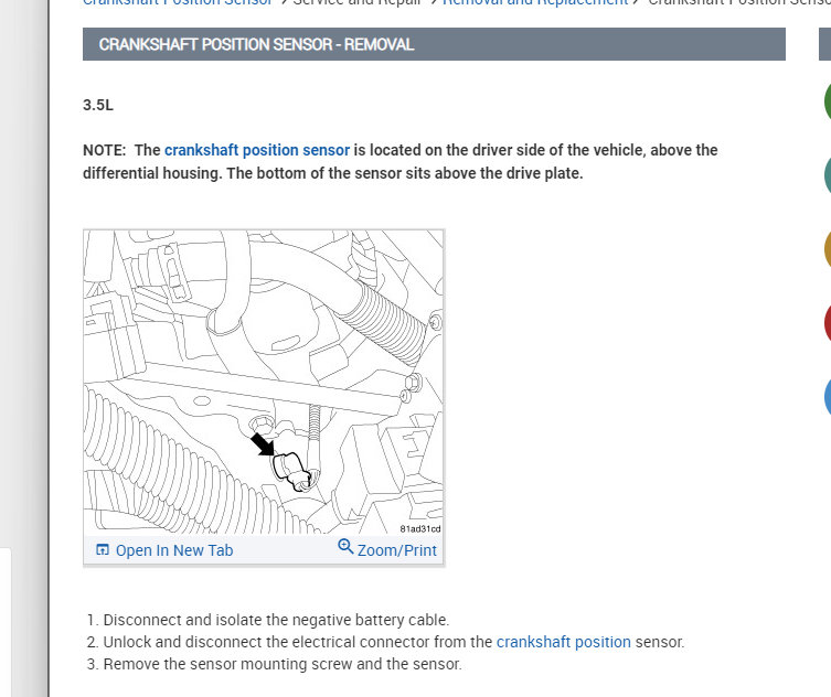

Where’s the sensors locates,is the one on back of the engine belt housing?
Jun 18, 2022 at 3:49 AM
KRZYSZTOF
  • 32 POSTS
It is getting gas, spark plugs are wet.
Jun 18, 2022 at 3:50 AM

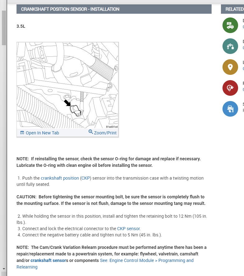

Sorry. I thought I included that. Please see the attached for the details on the location.
Please let me know if you have other questions or what you find.

Correct. Even if it is out of time, you should have spark when the crank passes by the tooth on the tone wheel.
So, if spark is the only thing not there, I suspect the crank sensor failed. Clearly that would be a coincidence, but the PCM needs the crank signal to determine when to fire the plugs.

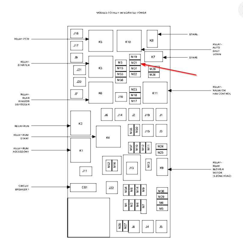

Okay. How sure are you that you are getting injector pulse? Clearly, we have made an assumption somewhere that led us down the wrong path.

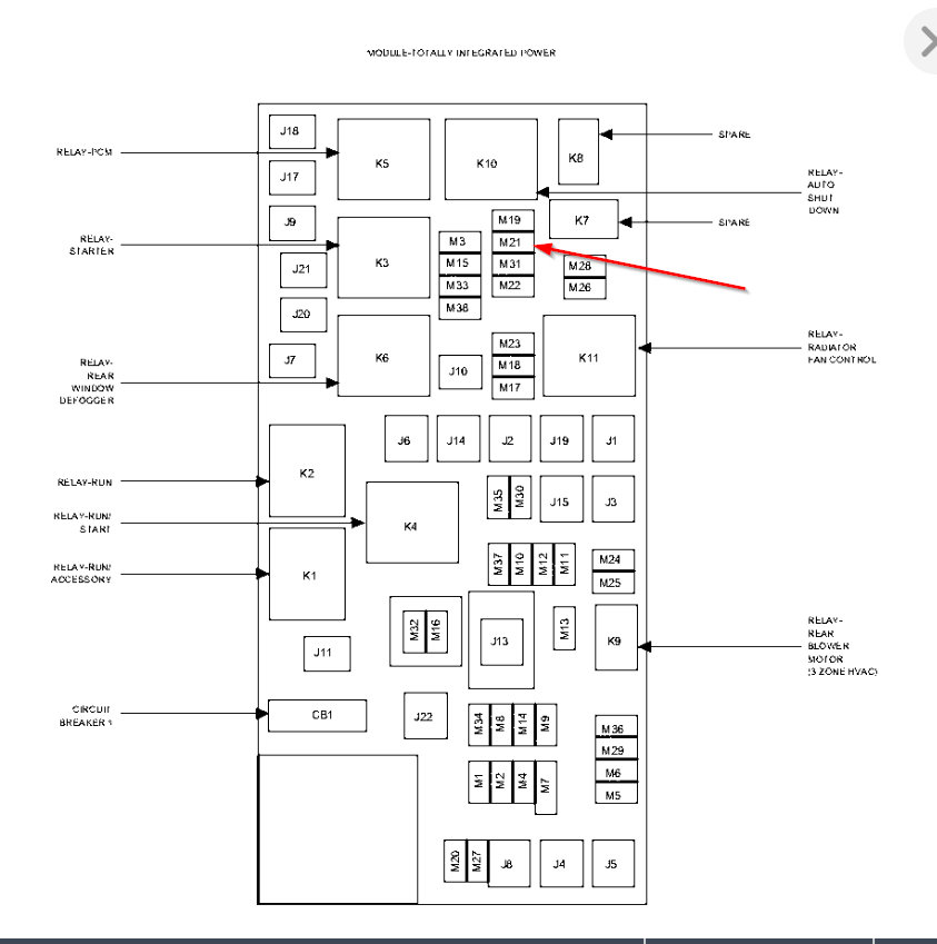

Go to fuse M21 in the TIPM which is under the hood, and check for power on both sides of the fuse when you are in key on and cranking the engine. This is the ASD relay that feeds this fuse. The relay also feeds the injectors so if we have no injector pulse then the relay could be the issue.

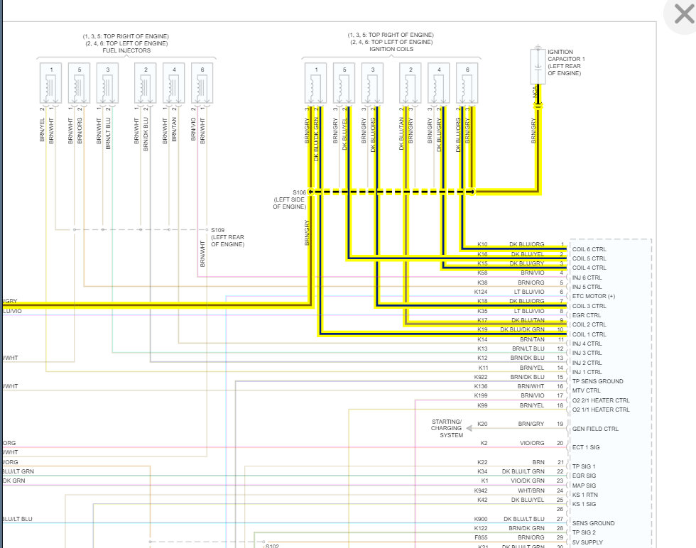

Otherwise, we should have power on both sides of the fuse which means the coils are getting 12-volts, but the PCM is not commanding the high voltage spike. If that is the case, then there is another reason that the PCM is preventing spark.
However, if the PCM is not the issue and you put a crank sensor in it then I have to suspect that we have an issue with getting power to the coils through this fuse.
Jun 24, 2022 at 4:45 AM

No. If spark is the only thing, then I would go to the coil and check for 12 volts first.
I assume you mean the wireless ignition node. The module that picks up the key signal.
If the engine cranks, then this is not the issue. The WIN is nothing more than the receiver that picks up the signal from the coded key to make sure it is a good key to start the engine. The starter would not turn if the WIN didn't send the signal.
I still think we have an issue with either getting power to the coils or the PCM is not seeing something it needs to fire the coils.
I would take that wiring diagram and just check for voltage at the coil.

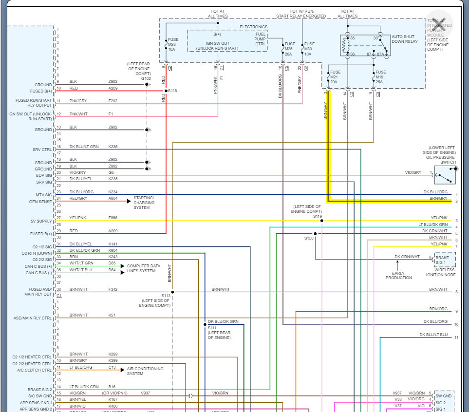

Okay. It could be a harness issue, but did you check fuse M21 in the TIPM and make sure that this was not the issue?
Thanks for the update.
Jun 25, 2022 at 7:14 AM
KRZYSZTOF
  • 32 POSTS
Hi Kenny, I did not check that fuse coz it not state in TIPM box ignition, so I check that fuse and is blown tomorrow I check rest. thanks
Jun 25, 2022 at 10:36 AM
Okay. So, if you find the fuse below blown then that explains the no power. So, we need to replace it and check the operation.
It is a good idea to check the rest but clearly replacing that fuse should fix this issue as long as it doesn't blow again. If it does, then we have something that is drawing too much current causing them to blow.
Jun 25, 2022 at 10:48 AM
KRZYSZTOF
  • 32 POSTS
Hi Kenny, this morning’s I was checking all fuses and yes, I found m21 blown I replaced with good one and car start, yahoo. thanks for all you help and God Bless you. And speaking to you next time with problem.
