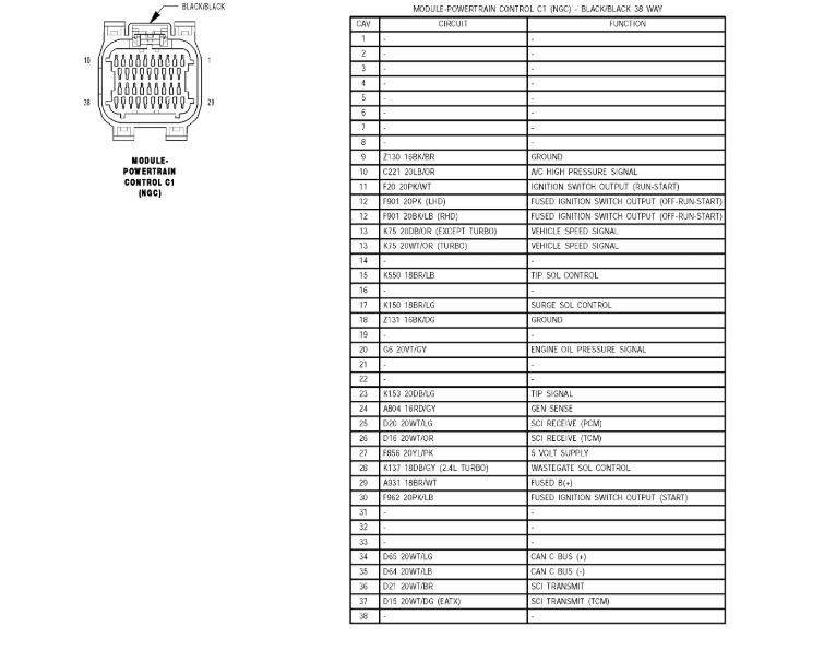

Is at pin 30 the PCM receives power from the TIPM?
Sunday, July 8th, 2018 AT 1:19 PM
  • 52,797 POSTS
No, pin 30 gets power from the ignition switch.
Sunday, July 8th, 2018 AT 1:24 PM
ZEMORZEMOR
  • 486 POSTS
On the pinout diagram it shows it is coming from the TIPM.
Sunday, July 8th, 2018 AT 1:25 PM
  • 52,797 POSTS
The diagram I sent you says ignition fused feed. Check the fuse for this.

Okay I will. The other thing is how to check PCM connectors have no bad connection?
Sunday, July 8th, 2018 AT 2:00 PM
  • 52,797 POSTS
Remove the connectors and look for any loose, damaged or burned pins. Use some dielectric grease for a better connection.

So is the TCM part of the PCM or the TIPM is the TCM?
Sunday, July 8th, 2018 AT 2:15 PM
  • 52,797 POSTS
The PCM is also the TCM. The TIPM is another module that controls body functions as well as powers to components.
Sunday, July 8th, 2018 AT 2:17 PM
ZEMORZEMOR
  • 486 POSTS
And the PCM and the TCM communicate internally on the motherboard the communication does not uses any external wires right?
Sunday, July 8th, 2018 AT 2:21 PM
  • 52,797 POSTS
They control outputs based on inputs.
Internally they talk between themselves, yes.
