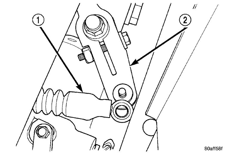

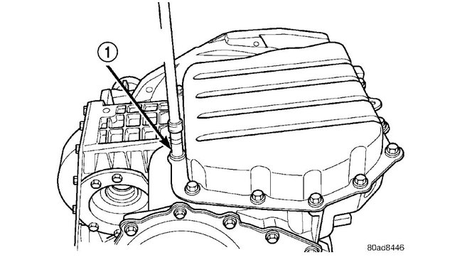

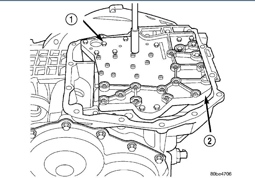

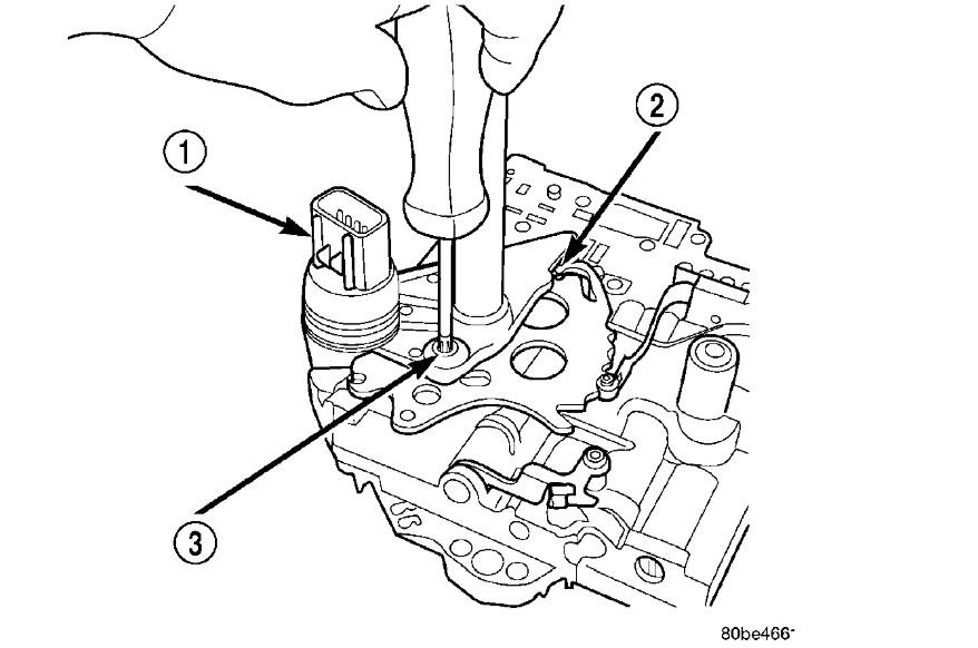

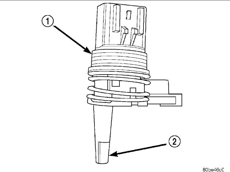

Is the range sensor and transmission temperature sensor share the same connector? Can you tell me where the transmission temperature sensor connector is at?
Jul 5, 2018 at 1:08 AM
The temperature sensor is part of the range sensor.
Yes, they share the same connector.
Number two in the picture. The rest is the range sensor.

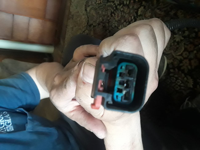

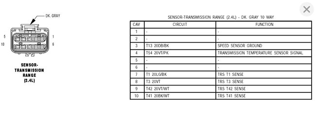

How many pins the connector has and which ones are for the temperature sensor?
Jul 5, 2018 at 1:19 AM
Diagram attached of the connector and pins.
If you have a scan tool, you can read the actual temp through the scan tool to see if it is working

I have a code reader but does not show the transmission temperature. I want to check resistance of the sensor so number four is temperature signal wire and they both sensor shares a ground right?
Jul 5, 2018 at 1:30 AM
Code reader is not a scan tool.
Check the resistance from the terminal to a good ground. since it is a temperature sensor, it will vary according to temperature.
There is no chart for resistance according to temp that I can find. thats why you need a scan tool to monitor the actual reading and compare to the temp of the fluid with a lazer temp unit.
Transmission temperature sensor:
The TRS has an integrated thermistor that the PCM/TCM uses to monitor the transmission's sump temperature. Since fluid temperature can affect transmission shift quality and convertor lock up, the PCM/TCM requires this information to determine which shift schedule to operate in. The PCM/ also monitors this temperature data so it can energize the vehicle cooling fan(s) when a transmission overheat condition exists. If the thermistor circuit fails, the PCM/TCM will revert to calculated oil temperature usage.
Calculated temperature:
A failure in the temperature sensor or circuit will result in calculated temperature being substituted for actual temperature. Calculated temperature is a predicted fluid temperature which is calculated from a combination of inputs:

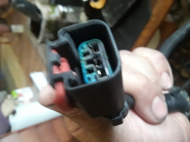

I thinking there is a problem either at the sensor or its connector, because when code p0882 shows up all the gears P N R 3 2 1 on the dashboard are selected.
Jul 5, 2018 at 2:05 AM
Very possible. Wiggle the connector outside the transmission and see if you can recreate the issue.

That sensor may be the issue if the connector is okay with no damaged pins or wires.
