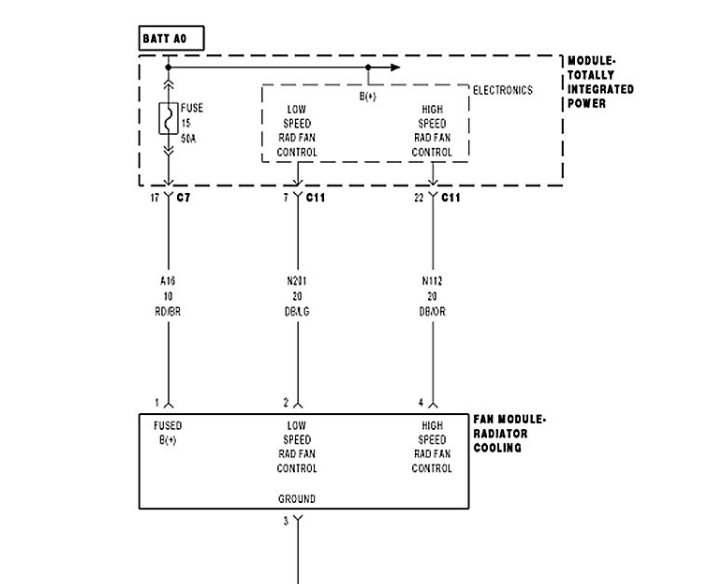

I replaced the connector solder the wires and heat shrink them. P0218 came back I think not sure, only when the AC is on. when I turn the AC on I checked the coolant temperature with code reader it was 221 and kept climbing. I did not hear the high speed fan turns on. Only heard the fan running one speed.

Yes, the fan turns on but does not seem it is high speed. I just jumped the fan pig tail. I jumped the middle pin ground with the right pin fan turned on. After jumped ground with left pin fan turned on, however they seems they are same speed.
Jun 26, 2018 at 1:16 PM
Check the dark blue/orange wire for power. that is the high speed motor control. It comes for the TIPM. If it has power, then the fan motor is bad. If it does not then the TIPM is bad.
Jun 26, 2018 at 1:20 PM
ZEMORZEMOR
  • 486 POSTS
There are two relay on top of fan. When AC on both relays are closed. I guess the high speed in this car and fan is running I did not check yet at the fan harness if there are power in both wires.
Jun 26, 2018 at 3:41 PM
Check the powers per the diagram I sent you and let me know.
Jun 26, 2018 at 3:46 PM
ZEMORZEMOR
  • 486 POSTS
The car fan is 3 pins and the diagram has 4. Also, in the diagram is not showing relays which I have in car.

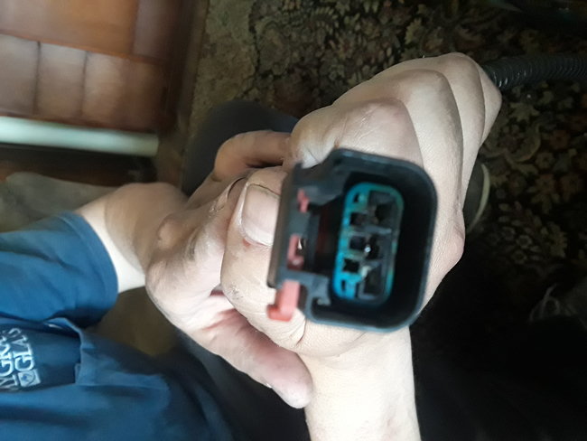

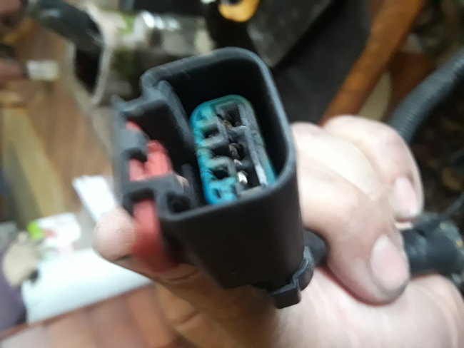

There is burnt wire harness side not fan side they are thick wires.
Jun 26, 2018 at 4:10 PM
Can you post a picture?
Did you check the voltage?
Jun 26, 2018 at 4:12 PM
ZEMORZEMOR
  • 486 POSTS
Inside the connector is black aka burnt. I did not check voltage I think needs to be replaced, spliced or something else.
Jun 26, 2018 at 4:15 PM

Here is the pictures.
Jun 28, 2018 at 1:59 PM
ZEMORZEMOR
  • 486 POSTS
Here is the pictures. The tab inside that hold the pin is broken. I went to the junk yard and replaced the harness. It has two relays and two connectors.
Jun 28, 2018 at 2:02 PM
Those connectors are no good. They are burned up from high resistance.

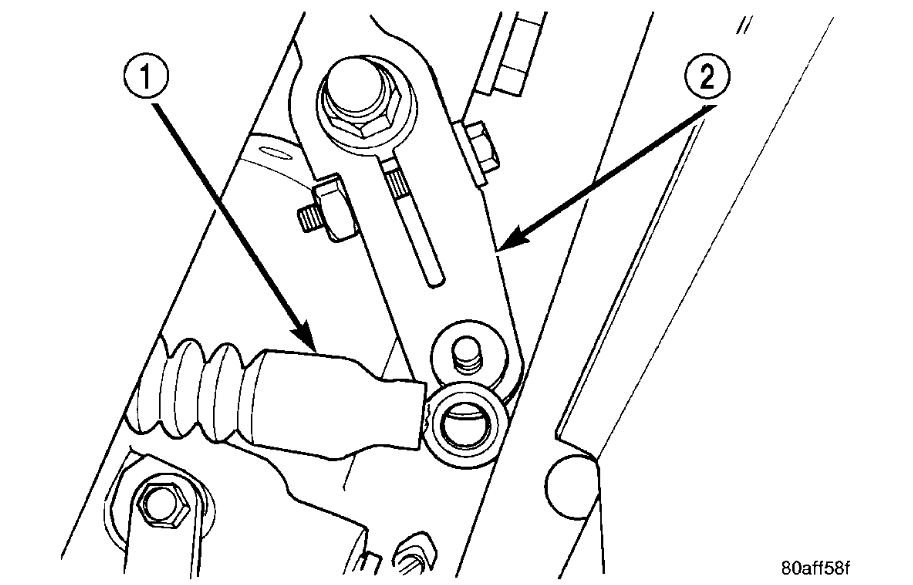

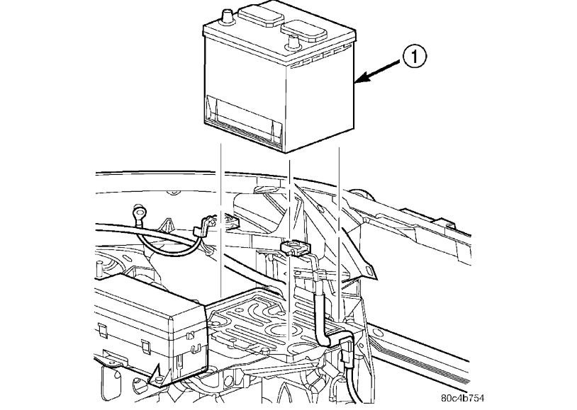

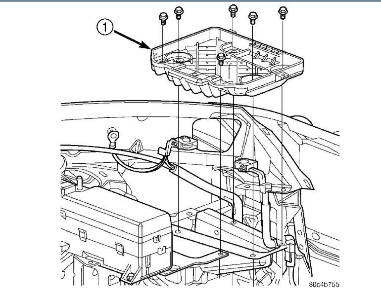

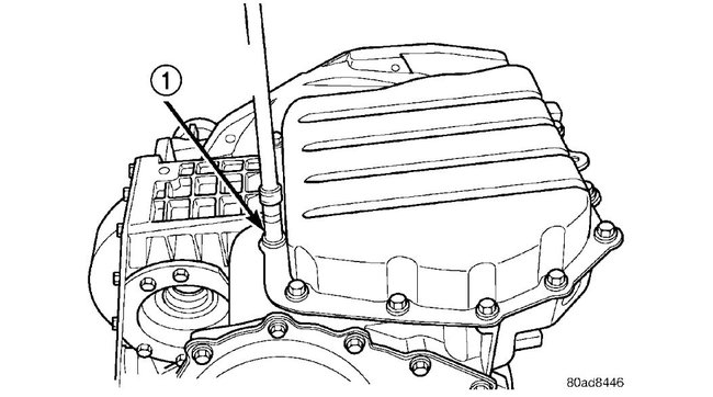

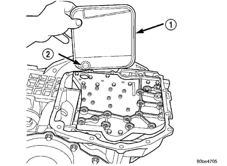

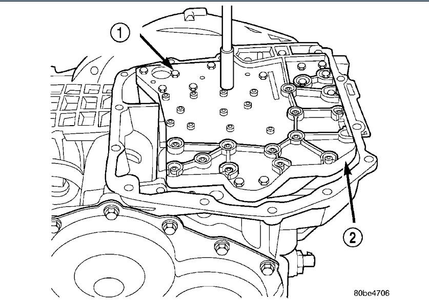

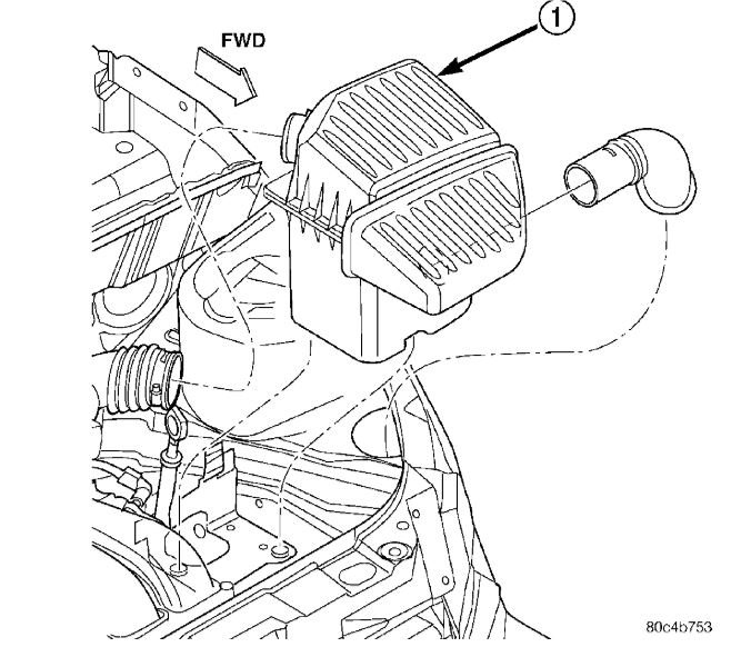

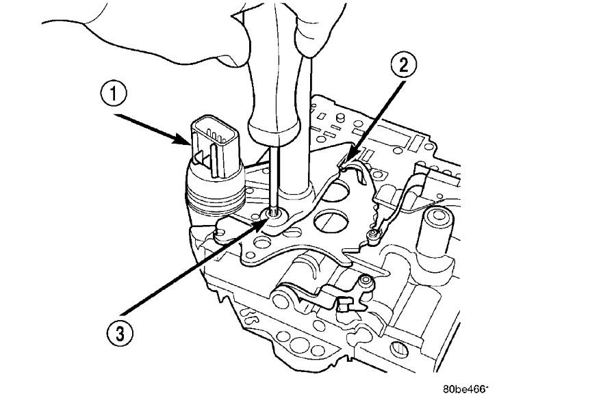

Removal:
The valve body assembly must be removed to gain access to and replace the transmission range sensor.
1. Disconnect the battery cables.
imageZoom/Print
2. Remove air cleaner assembly (1).
imageZoom/Print
3. Remove the battery hold down clamp and remove the battery (1).
imageZoom/Print
4. Remove the battery tray (1).
imageZoom/Print
5. Disconnect gearshift cable (1) from manual valve lever(2).
6. Remove manual valve lever.
7. Disconnect transmission range sensor connector.
8. Hoist vehicle.
imageZoom/Print
9. Remove oil pan bolts (1).
imageZoom/Print
10. Remove oil pan (1).
imageZoom/Print
11. Remove oil filter (1).
imageZoom/Print
12. Remove the valve body-to-transaxle case bolts (1).
imageZoom/Print
13. Remove park rod rollers (1) from guide bracket (2) and remove valve body from transaxle.
imageZoom/Print
14. NOTE: To ease removal of the valve body (1), turn the manual valve lever fully clockwise to low or first gear.
CAUTION: The valve body manual shaft pilot may distort and bind the manual valve if the valve body is mishandled or dropped.
imageZoom/Print
15. Remove manual shaft seal (2).
imageZoom/Print
16. Remove TRS retaining screw (3).
imageZoom/Print
17. Slide Transmission Range Sensor (1) up the manual shaft and remove.
