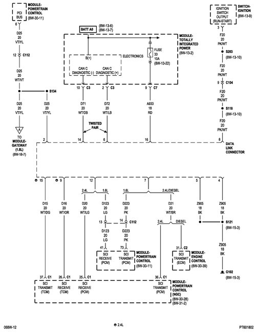

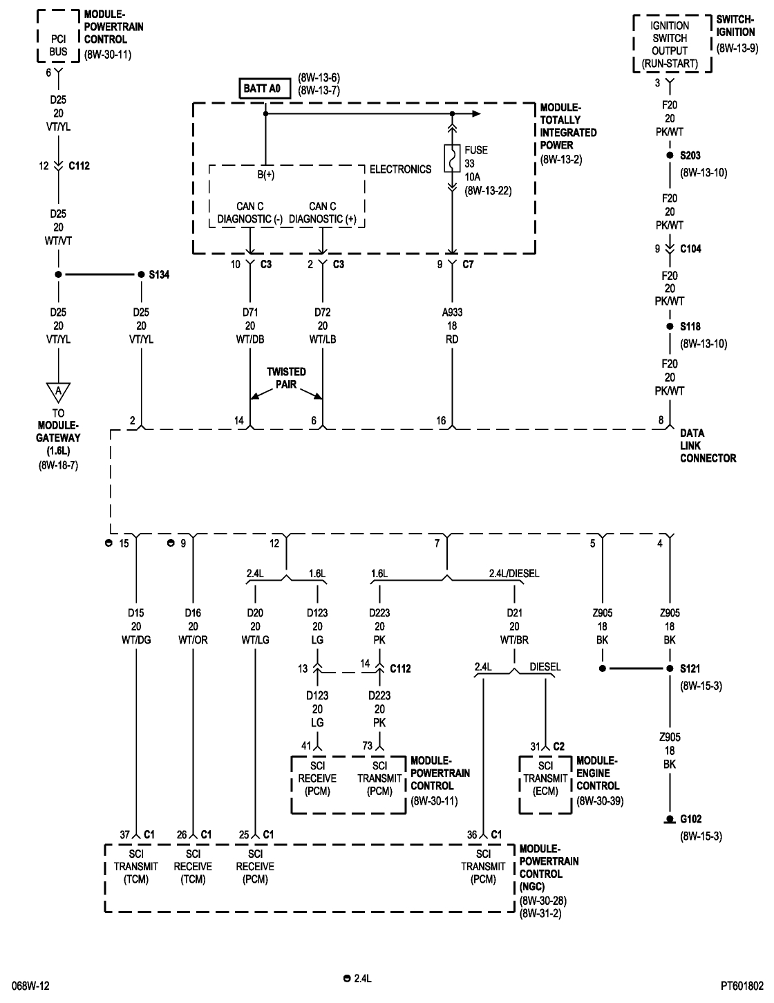

where is location of the CAN bus? I had communication codes U0001, U0014 P700 and another i do not remember.

I do not see any code info for U0014. U0001 is for the PCM losing communication through the C bus line. I would recommend you take it in to a shop or the dealership for proper diagnostic. Any module on that circuit that goes down could take down the rest of the modules. Lets do a CAN scan which is the future of automotive repair you can get a CAN scanner from Amazon for about $50.00 here is a video to show you how.
https://youtu.be/u-4syLc-ifQ Here is a description oft he CAN Bus system.

All models have a central CAN gateway or hub module integral to the TIPM that is connected to all three CAN buses. The TIPM is located in the engine compartment near the battery. This gateway physically and electrically isolates the CAN buses from each other and coordinates the bi-directional transfer of messages between them. On models with the 1.6 liter engine a separate, dedicated gateway module secured to the floor under the driver side front seat in the passenger compartment coordinates the bi-directional transfer of messages between the PCI bus line from the PCM and the CAN bus connected to all of the other nodes in the vehicle.

If there are intermittent or active faults in the CAN network, a diagnostic scan tool connected to the Diagnostic CAN-C bus through the 16-way Data Link Connector (DLC) may only be able to communicate with the TIPM. To aid in CAN network diagnosis, the TIPM will provide CAN-B and CAN-C network status information to the scan tool using certain diagnostic signals. In addition, the transceiver in each node on the CAN-C bus will identify a "bus off hardware failure," while the transceiver in each node on the CAN-B bus will identify a "general bus hardware failure." The transceivers for some CAN-B nodes will also identify certain failures for both CAN-B bus signal wires.

yep it was the TIPM was out I got a new one all fixed.
