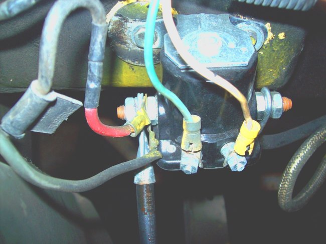

CJ MEDEVAC
  • 11,004 POSTS

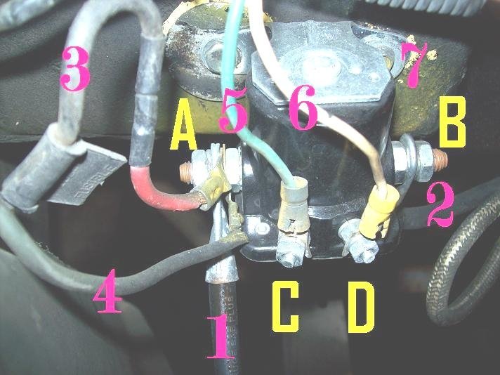

just in case fusible links are still questionable.
i copied this from another post i answered.
i have a 1977 jeep and a 1946 jeep.
i feel sure you don't have a ford type solenoid like mine, but the fusible links still should be in your system at similar locations.
anyway, in an attempt to familiarize you with fusible links see my pic at the bottom and what i'm pasting in below.
pasting:
"ford type" solenoid system, your acces., may vary
1) positive cable from battery
2) out to starter motor
3) on my jeep, this goes to the alternator
4) this feeds my fusebox (all of my accessories)
5) "s" wire is from key, 12v only while you are "cranking"
this wire activates the solenoid's electromagnet, which in turn, connects---a & b internally (only the 2 large gauge cables can handle the amperage the starter "pulls").
when the solenoid is activated, it throws 12v to starter using the large gauge cables (1) pos from batt--thru solenoid internal connection--(2) to the starter, while key is in "cranking" mode.
this is the total reason for a solenoid, because it would not be practical, to run the heavy cables to and from your key switch.
6) "i" wire (optional), feeds coil "full 12v", only while "cranking", after you release the key, the coil reverts back to reduced voltage, supplied by your key in the "run" position.
7) the solenoid's "mount" needs to ground, unit must have a good ground (battery to engine, engine to frame, frame to body [all must connect, somehow] )
(3 & 4, on my jeep) are fusible links, all are not marked, my #3 is, #4 is not....its sort of a "wire" fuse.
if they are good, tugging on them will be just like a wire, when they are "burned up", they will stretch out like a rubber band.
should one of these puppies be burned up, it is really important that it be replaced (not bypassed) with the same amp fusible link that was there!
nothing like taking a shortcut then watching your vehicle burn to the ground!
keep us (motor master and me) posted on progress!
the medic

No the distributor cap can not cause the engine to not turn over. And the pics that CJMedevac posted does show a good pic of a fusible link (the block with the tag on the left side of the solenoid) of a similar type the your truck should have however like I said yours will be right off the starter since your solenoid is connected directly to the starter. Make sure you are checking for power on the side of the block that leads away from the starter.
