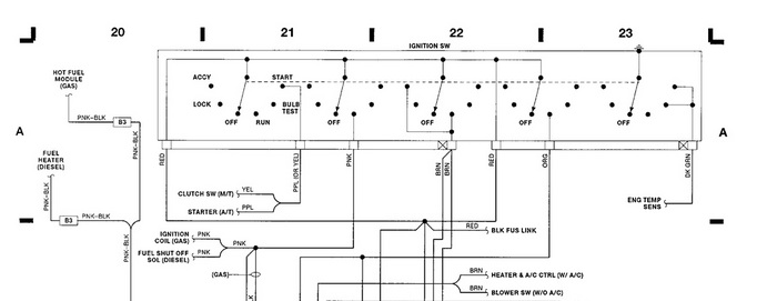

KITKAT_LEO
  • 1991 CHEVROLET TRUCK
Ok very frustrating- 164000 miles Car didn't want to start replaced the starter and it started a few days and died wouldn't jump thought the rebulit starter had problems replaced it. Still only clicks won't start. Checked fuses connections. Fuseable link on start good. Tried to replace the coil that didn't do anything. Wondering what next should I look at, please help
+1
Monday, November 11th, 2019 AT 6:20 PM (Merged)
KITKAT_LEO
So we replaced the ignition switch and now the car clicks like the battery is dead, but battery tested it was fine. The funny thing is you could test for error codes and then the car started a couple of times. Now it won't start at all just clicks. Also the error codes just flash 12 continuesly it is suppose to do it 3 times then flash the error code anyone else think it could be the brain. If you have an idea or anyone else have an idea at all please help :(
+1

MIKEYBDMAN
  • 623 POSTS
Some times the ground cable from the battery to the engine block will corrode inside the plastic and you cant see it. Check your ground cable and make sure it is not corrodded or have a bad connect to the engine block.
If you have a clicking start relay while trying to start, you have a weak battery, bad ground, loose connection or bad start relay. Try to eliminate each item one by one to avoid replacing parts that dont need to be replaced.
