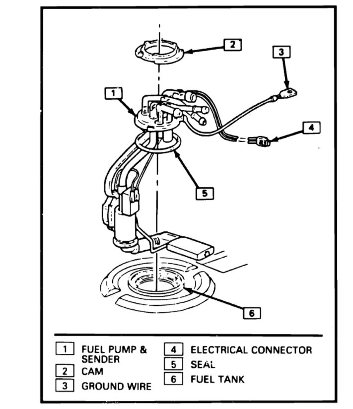

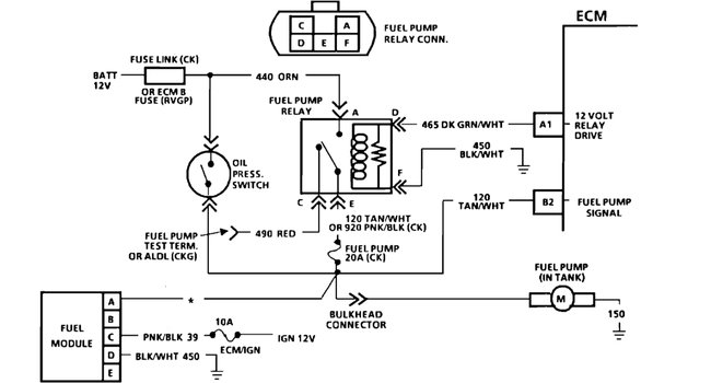

First check all your fuses. Next check to see if your fuel pump is running. Put your ear on the gas tank and have someone turn your key forward but don't start it.
This guide should help
You should hear the pump running for 3 or 4 seconds.
If it does't run unhook the wire harness down by your tank. You can hook up a 12-volt power source to your wire harness coming off your fuel pump, it should run, if it doesn't you probably need a new one. If it does run, check for power from the engine side of your harness. No power, check your fuel pump relay. I would buy a new one, they're not that expensive and you will no for sure it's not that. If your fuel pump does work, check to see if you are getting fuel to your carb. If your are not, check your fuel line and fuel filter. If your getting fuel, check for spark on one of your spark plug wires. No spark, check for spark from ignition coil to the distributor. Do these checks and get back to me and I'll help you more.
