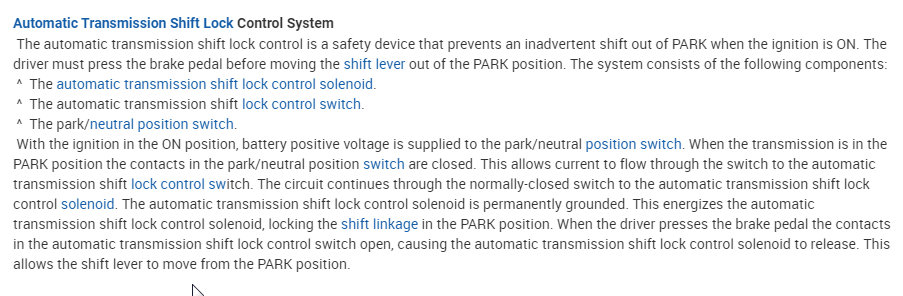

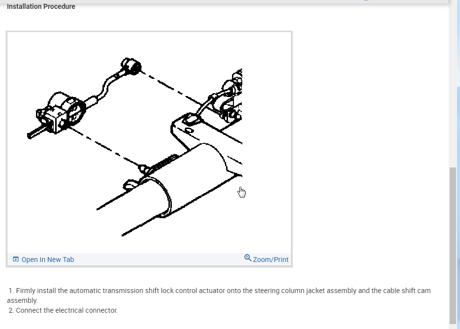

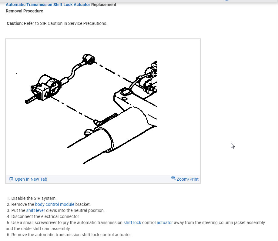

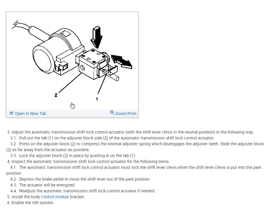

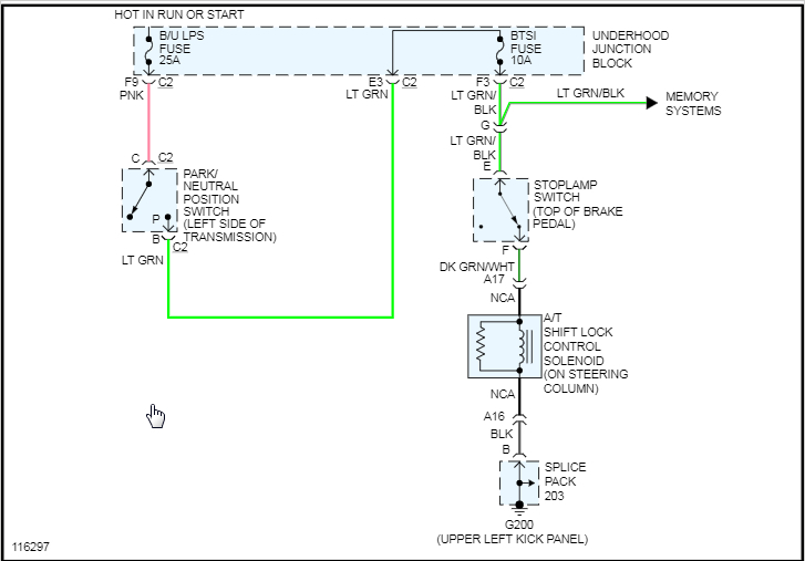

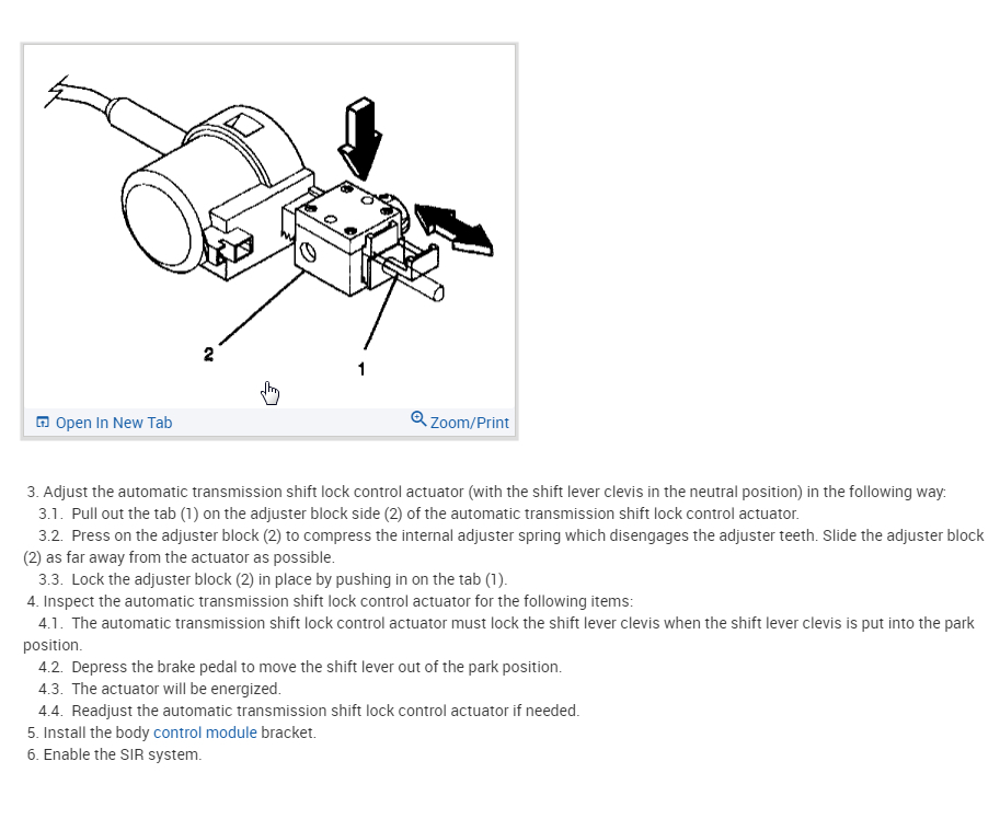

Wont start some mornings, but when i wiggle the shifter and hold it tight in park it starts. then don't have any problems starting the rest of the day.
Oct 15, 2019 at 7:10 AM
This sounds like the shift interlock switch is failing. This is located in the column and tells the control module what position the shifter is in.
I attached the process on how to replace this. Let me know if you have other questions. Thanks
Oct 16, 2019 at 10:51 AM

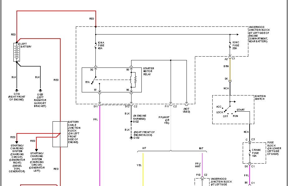

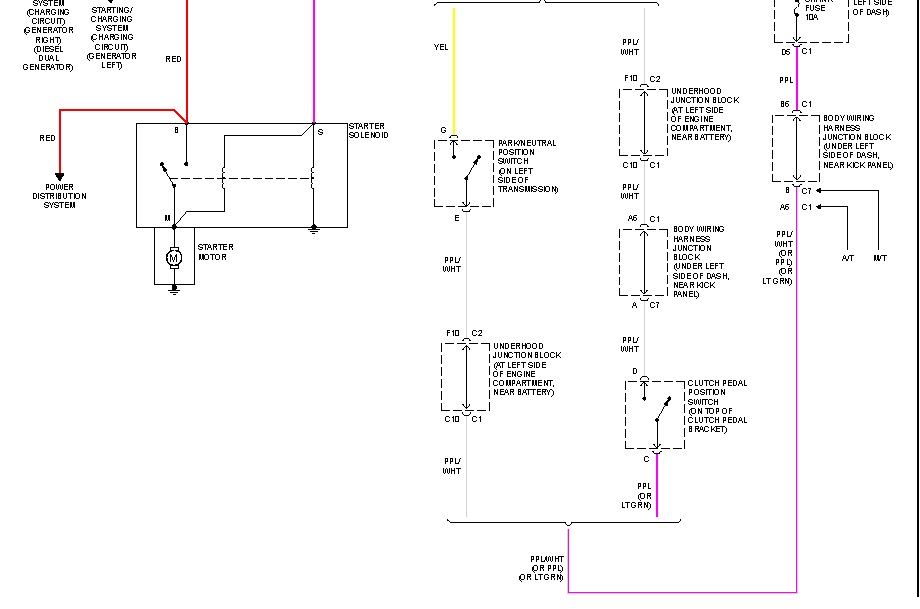

i thought the battery died to my 2001 silverdo so i replaced it and now it does not start still, my buddy took a look at it and said that the starter relay is not switching.
Sep 3, 2020 at 9:56 AM (Merged)
JDL
  • 16,098 POSTS

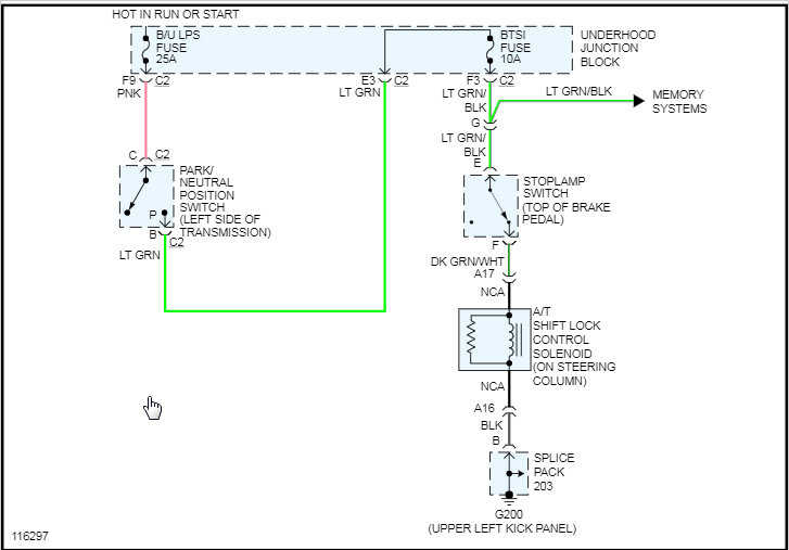

The wiring circuit below is for starter circuit. Start by checking applicable fuses and voltage. Battery connections are all ok? Voltage to load side of relay is hot all the time. Voltage to coil side of relay goes hot with key in the crank position and is wired through the neutral switch. Hope you can read the diagram.

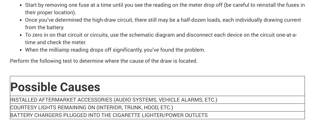

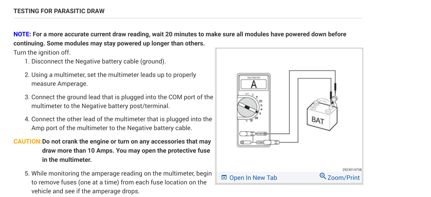

You might be stuck with having to have a shop that has a scanner capable of turning the security light on and off. If it doesn't a bad cluster may be present. and just the source of the drain.

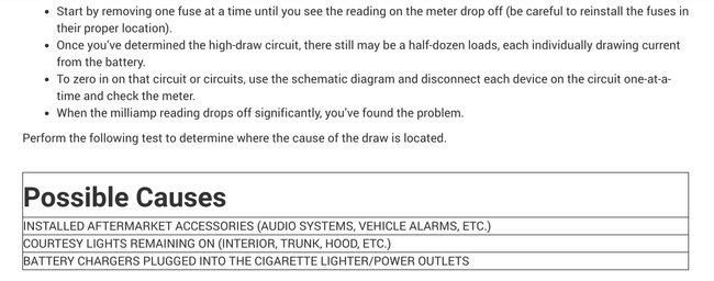

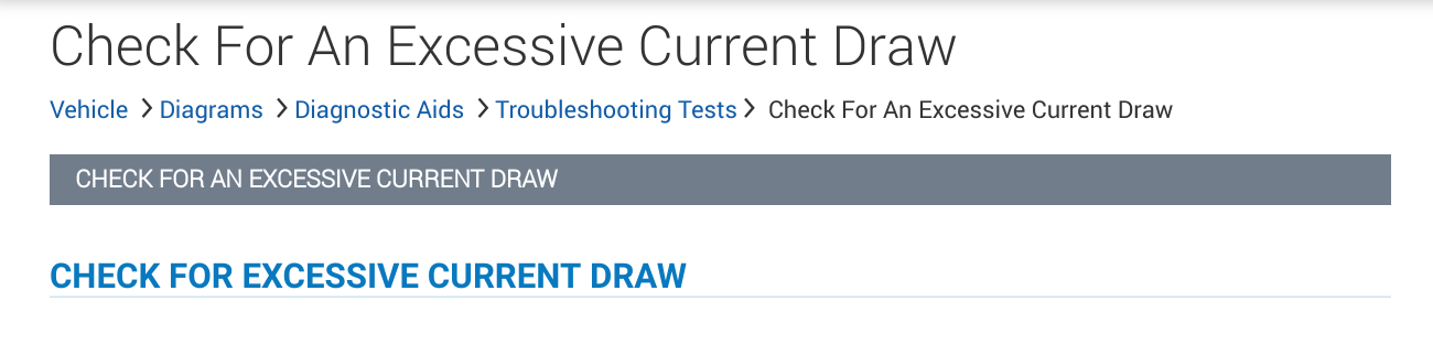

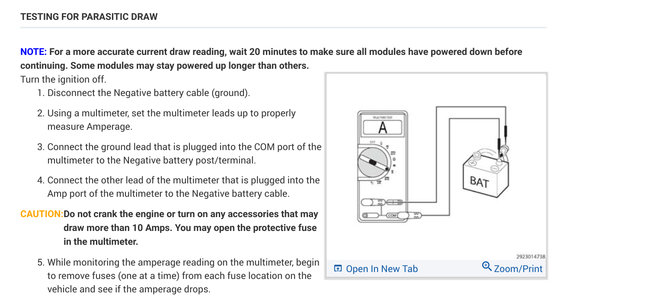

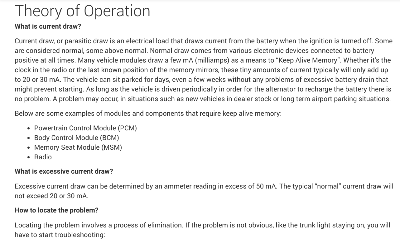

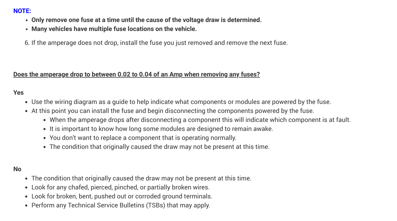

I think I would treat it as a parasitic draw and see what circuit has the drain. "google" testing a parasitic draw if you don't know how. When you find it, I think you'll find that fuse is the one on the same circuit of the security light.

This morning I brought my son to school, truck ran fine, stopped at the store on the way home and when I came back out it would not start. Plenty of battery power, no click nothing! I am assuming neutral safety switch but somebody told me to check the fuse first. Which fuse is it that I check? And where is it located?
Sep 3, 2020 at 9:59 AM (Merged)
STEVE W.
  • 15,413 POSTS
Try running the shift lever through the gears while holding the key on. Sometimes you can get the switch to work enough to get it started. Could also be a bad connection at the starter. Fuse 1 will be under the hood in the box and labeled Start the other one will be in the interior fuse box and labeled start/ign.
