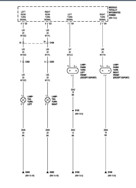

My left rear turn signal light will not work. it is the only one that wont work. i have tried several new bulbs that will not work and i have had someone check the fuse and still didn't work. what could it be causing it not to work and what should i buy to fix it ?

Hello,I'm Danny.
Normally that is caused by a faulty ground wire on that bulb socket. I would check for a loose,burnt,melted,cracked ground wire.Here is a tutorial showing you how to check:
I've attached a picture below of the turn signal wiring circuit.Hope this helps and thanks for using 2CarPros.
