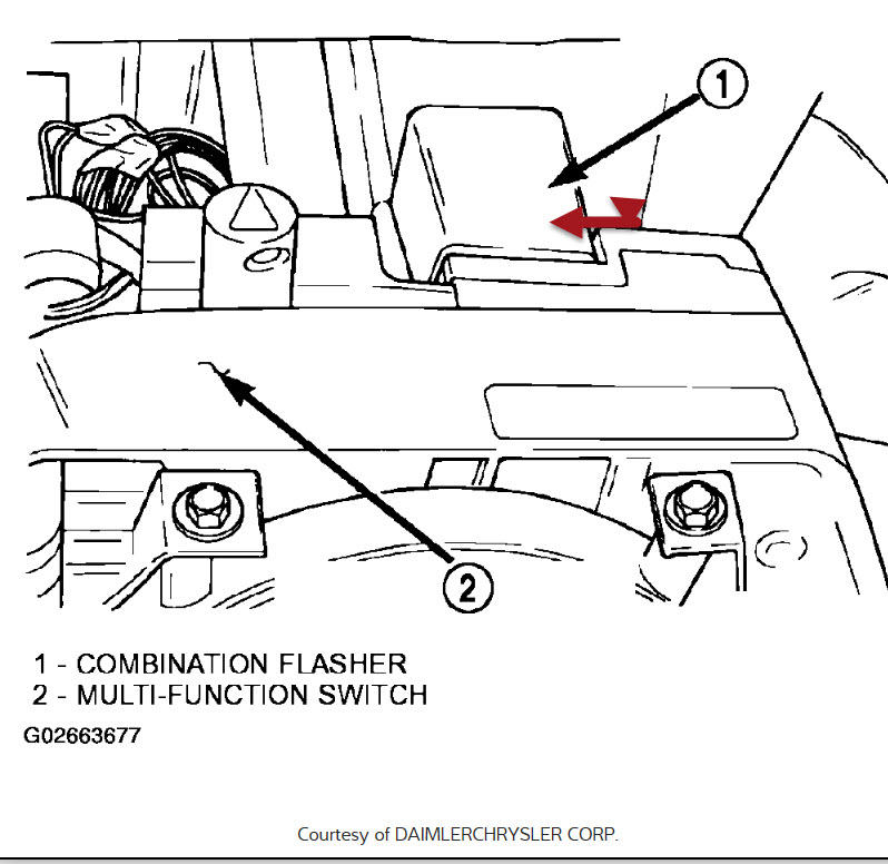

The turn signals and hazards are not working on my car. The bulbs are working just find. I replaced the fuses, multi functional switch, relay, and still nothing. The headlights, fog lights, wipers, etc are still working. It's just the turn signals and hazards and inside on the panel show nothing either.

you probably need anew combination flasher see pic.

those are 2 different circuts.check the signal fuse.then check the flashers.i hope you installed the switch right because both of these are controlled by the signal switch.
