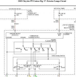

Sorry for the delayed responce. It sounds like you might have blown one of the fuses that power up that system. We will need to start there. Here is the wiring diagram for your car. test the power input at the switch and get back to me please.
https://images.2carpros.com/forum/automotive_pictures/10_wiring_3.jpg
Enlarge your screen size to see the diagram (ctrl + ) Thanks for using 2Carpros.com

Hi hootiemomma,
It is possible to be a wiring fault so get a test lamp and we can start some diagnostic testings.
When testing, probe the terminals indicated with the test lamp attached to a good ground.
Perform the following test at the multifunction switch.
With ignition OFF.
Is there battery voltage at terminal # 11 ( Pink/Dark Green wire)?
With ignition ON.
Is there battery voltage at terminal # 3 ( Red/White wire)?
I am stumped why the mechanic mentioned to you the flasher would not work if the hazard is used. The only explanation that I can come up with is the type of flasher unit used. Is the correct flasher unit installed ?
Flasher relays are not universal and if the wrong terminal locations are used, they would not function correctly .
I am not sure of the flasher terminal locations as the wiring diagram does not indicate them. Would it be possible to upload a picture of the flasher relay terminals and the multifunction switch relay terminals with the relay unplugged?
With some testing, we can determine if the relay and terminals match up.
