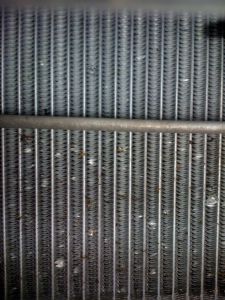

DAVIDBNAZ
I forgot to mention that I replaced the thermostat. The ac fan comes on as soon as I turn it on. The rad. fan comes on at 190 deg. As for the aftermarket radiator I put in, Its twice as thick but I noticed you cant see through It like the stock one. It looks like the fins are bent but it was made that way.

MHPAUTOS
  • 31,937 POSTS
I would still be re testing the thermostat, as dud new ones are not uncommon, also as you say the temp does come down with the heater on, this is somewhat indicating that the radiator may not be effective enough, I would get a radiator shop to check the core & tube size is suitable for your engine.
