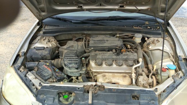

I bought this car from someone. when I put on the air conditioning while the car is moving you will see the temperature start raising and if the air conditioning off after speeding and you brake because of traffic for a while then it starts overheating. I have replaced the reservoir cap and the radiator cap as well, but still doing the same. I am confused I do not want to be changing mechanics. what do I do?
Jul 26, 2017 at 12:58 PM (Merged)
HMAC300
  • 48,601 POSTS
After car is warm with engine off and fan disconnected check radiator for cold spots if any radiator is bad. then pressure check for a blown head gasket. you can buy an additive at auto parts as well to chemically check it.
MICHAEL BRAYCE
Please, how do I go about this cold spots and pressure check for a blown? Thanks

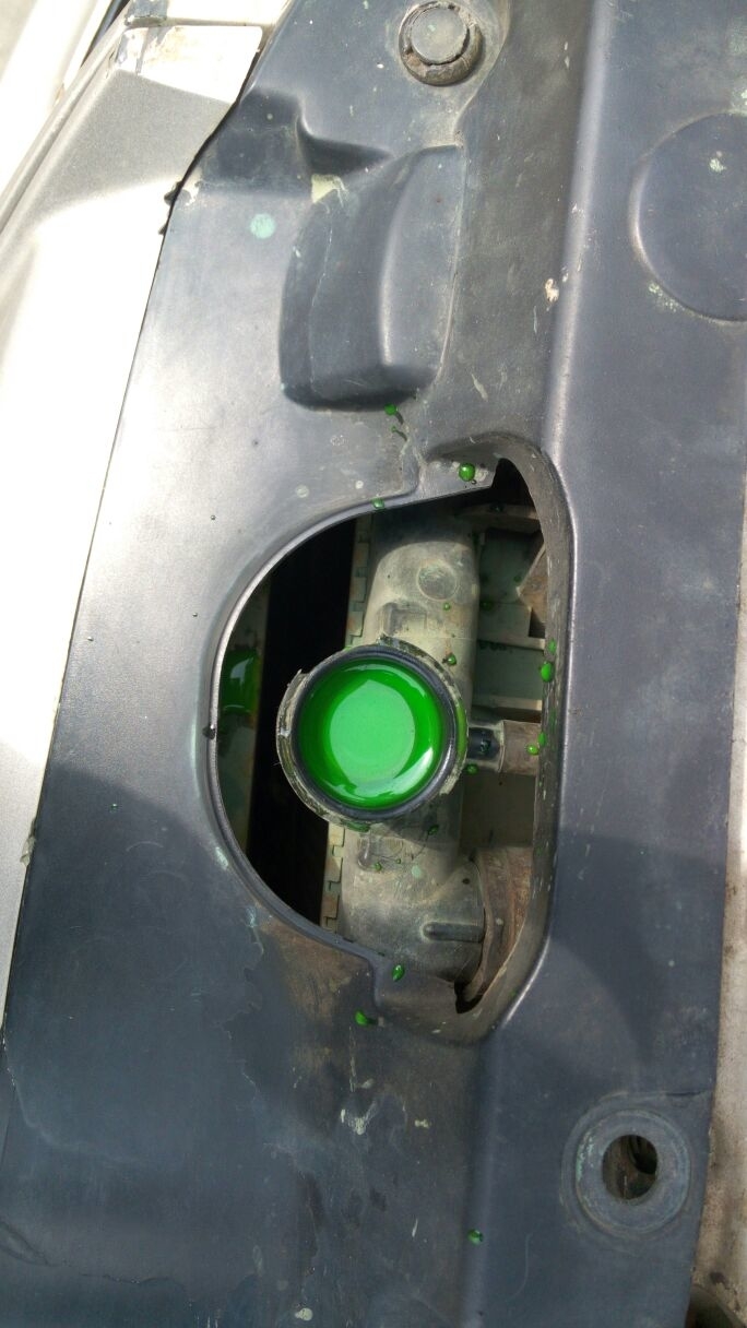

Hi good morning hope all is well. Thanks for the answers so far. But yesterday evening I used my car I checked the water level but driving it for about ten km and back I parked it this morning, I checked the water but it has dropped and I added some to it. this morning I drove it to office about twenty km I parked it and waited for it to cool down. I checked it again and the water has dropped but because there were no traffic the overheating did not start. what will be the problem?
Thanks so much for your help.
  • 55,528 POSTS
Hey MICHAEL,
Are the cooling fans working when the engine gets hot? if no they probably need replacing.
Here is a guide that will help you get the problem fixed:
https://www.2carpros.com/articles/replace-electric-fan-motor
Please let us know what happens so it will help others.
Best, Ken
