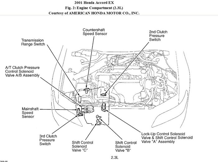

I was able to test the lock up solenoids successfully an they were within the normal ohms range and clicked normally when powered on. The clutch solenoid however was more questionable, but I'm not confident in my testing since this is my first time with this type of diagnosis. Ohms measured about 6.0 (5.8-6.0 on one multimeter and as high as 6.2 on a different multimeter.I wanted to use more than one to make sure). I also could not get the solenoid to click when connecting a hot lead and ground to the terminals, but again, I'm not so confident that I did it correctly, so I may try again.
Oh, and I also forgot to mention that there are no stored or pending codes.
Tuesday, July 7th, 2020 AT 2:18 PM (Merged)
DRCRANKNWRENCH
  • 3,380 POSTS
If you got the other 2 solenoids to to test correctly, I think you should be confident.
You have the technique and guidance and I can tell that uou are very thorough.
You pulled information from here and Hayne's, used 2 multi-meters to account for accuracy and made the test wires properly. Are you an Engineering student, if not you should be.
Check on th eprice of the solenoid. Part of Electro-Mechanical diagnosis is hit or miss. It might be part of the problem. The only way you will know is to buy one.

Thanks so much for all the advice and encouragement. I'm not an engineering student or anything, but I just really like to learn and to fix things that are within reasonable possibility.
I was also wondering. If the solenoid would not click on when powered manually, wouldn't that mean that it would never work during normal operation? I assume the solenoid is working normally most of the time since the car shifts completely normal the majority of the time. Or maybe I just don't fully understand its operation.
Anyway, thanks again!
DRCRANKNWRENCH
  • 3,380 POSTS
Electrical diagnosis is really hard because parts fail slowly or intermitantly. Sometimes you have to wait for them to fail completely befoere you can diagnose the issue and then the part failure may cause other damage.
It is a process of elimination.
The tests are nearly the same except for resitance values. If you have checked the passage of the solenoid and it does not click every time you apply 12V, it fails the test and is working intermitantly. It does not follow the behaviour of the other solenoids as they reacted to the 12V application every time.
I think it is a problem as you said your transmission shifts properly sometimes, the solenoid works properly sometimes.
It may not be the problem, but it is failing and you can eliminate it from the list of possibilities.
I would replace it as automatic transmissions can get damaged when they do not shift properly.
I think you have good mechanical intuiton which is very thorough, you just need to be confident in your findings.
You are replicating what happens to that solenoid under normal operation. The only difference is that the voltage signal comes from the connector.
Check out prices and wheigh the risk. They always say, "$100 in maintenance saves $1000 in repair". Oh so true.

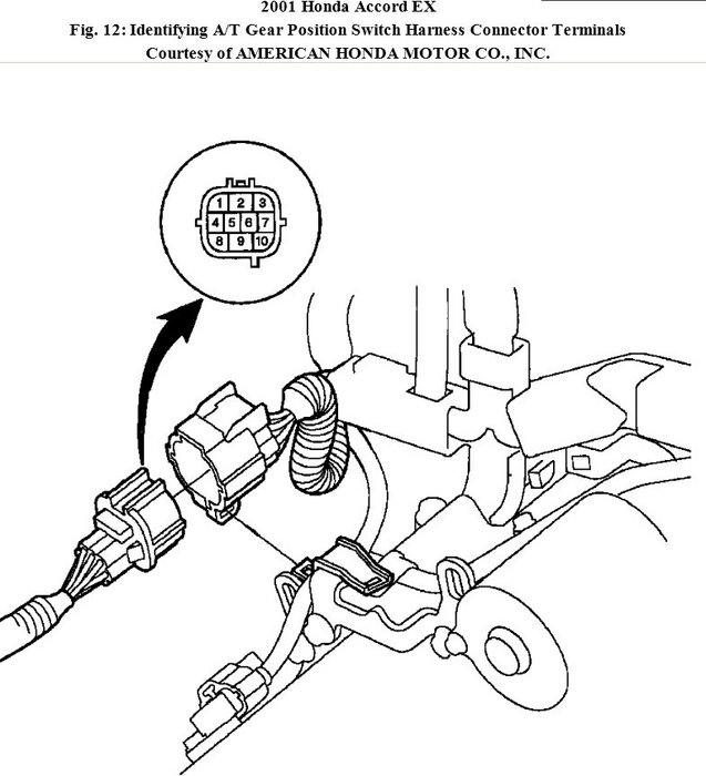

Thanks, I actually have a pick set and didn't think of using it for this. It worked great, thanks for the suggestion.
Also, I later remembered that you told me to remove the solenoids to check for debris so I also did that, but didn't find any. While the clutch pressure solenoid was off I tested it again with my fused jumper and it worked correctly so I'm a little torn, but like you said I will find out the cost to weigh out the risk of replacing it even if that turns out to not be the issue.

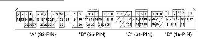

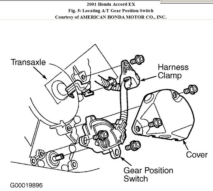

I also had someone suggest to test the transmission range sensor to make sure it is working properly. Do you know where I can confirm what the correct voltage reading should be in each lever position, and which wires are + and - for backprobing?
My Haynes book says to test it by checking continuity, not voltage, but they instruct to do it by removing the connector, then testing continuity between various pin combinations. But what is the acceptable continuity for each position? And how do I shift to the various gears when the shift lever is locked due to the connector being taken off? (Neutral safety swith engaged since the computer cannot recognize the gear you're in)
Hope that makes sense, but just let me know if I can clarify better.
DRCRANKNWRENCH
  • 3,380 POSTS
I tried to send you this message once, but it looks like it did not make it, sorry if it is duplicate.

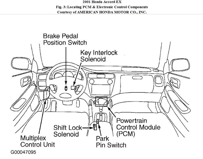

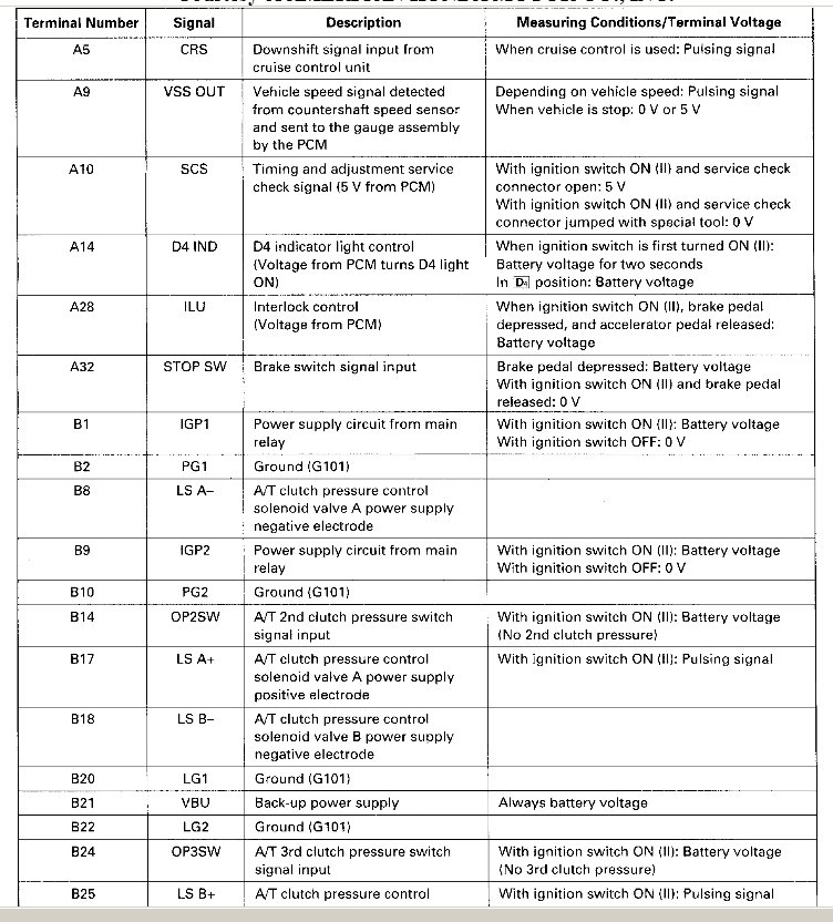

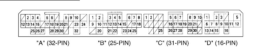

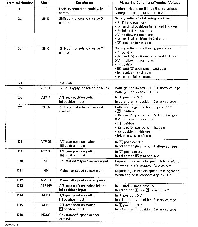

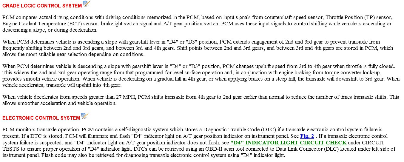

As far as the Transmission Range Sensor, I could only find one reference for which I sent you a location diagram. It seemed to otherwise be/or be part of the *****r position switch.
I sent you a voltage pin test chart. You can test a circuit or circuits in a component several ways to test them. Voltage gives you a value while continuity is either open/closed. So, if something that you test is nearly out of the specification range, it is probably slowly failing or internitantly failing. So, I think it will be an interesting test, let me know what comes of it.
I had to send you some diagrams in 2 part top and bottom pieces as they are too small to be usefule otherwise.
As far as the gear shifter, I sent you the locations of the shift solenoid lock and shifter lockout and the gear shift selector on the transaxle. I think you can take the cover off the shifter switch on the transaxle and slect gear by hand.
I wish I had a better answer about the range snesor, so I am sneding you everything I could find in relation to it.
Enjoy! I hope it gets you a few steps closer to your goal. Sounds like you are doing great and are good at getting as many information sources as possible. That is good as even the best information, except for 2carpros, can be different or mis-leading, etc.
