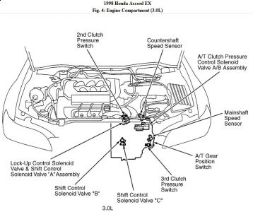

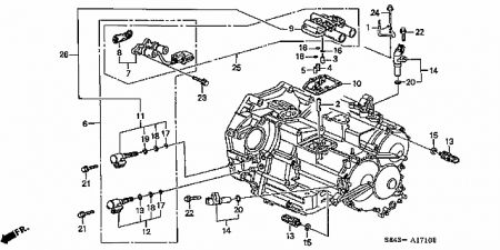

Well the transmission was recently rebuilt and the fluid is at the correct level and i don't have any codes. I only have bad shifting when cold. Could you happen to help me with the location of the solenoids on my honda so i could possible check them out. I think i have located most of the solenoids, I am having problems locating the shift solenoid, it is solenoid #7 in the picture.
https://www.2carpros.com/forum/automotive_pictures/455821_solenoids_1.jpg
There seems to be quite a few solenoids, solenoids A&B, a shift solenoid and a linear solenoid. Which one would be the problem?
Jul 7, 2020 at 2:14 PM (Merged)
KHLOW2008
  • CERTIFIED EXPERT
  • 41,814 POSTS
Hope this diagram is clear enough for you to understand. It can be any of the solenoids but the most likely would be the AT clutch pressure control solenoid valve A/B assy.

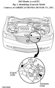

I have a 1998 Honda Accord EX with a 3.0 liter v6 and automatic transmission. The transmission is begining to slip and I am searching for a salvage yard transmission. Therefore, I need to know from what years of Accord I can get the transmission from and it will bolt up, connectors plug in, and work correctly. I've searched car-parts.com and it only lists 1998 and 1999 V6 Accords as having interchangable transmissions. Other places have stated that 1998 through 2002 V6 Accords auto transmission will work. Are you able to tell me which years of Accords I can pull the transmission from to replace the one from my 98?
KHLOW2008
  • CERTIFIED EXPERT
  • 41,814 POSTS
Hi aviador, The year is not the main thing. The transmission code would ensure you have the right trans.
https://www.2carpros.com/forum/automotive_pictures/192750_TransaxleIdenAccord6cyl98Fig01_1.jpg
For 1998 the trans model should be B7XA and can be found in models up to 2002.
