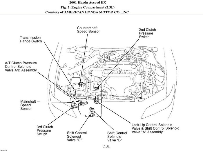

Also, I later remembered that you told me to remove the solenoids to check for debris so I also did that, but didn't find any. While the clutch pressure solenoid was off I tested it again with my fused jumper and it worked correctly so I'm a little torn, but like you said I will find out the cost to weigh out the risk of replacing it even if that turns out to not be the issue.

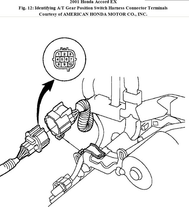

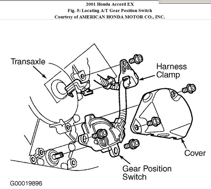

I also had someone suggest to test the transmission range sensor to make sure it is working properly. Do you know where I can confirm what the correct voltage reading should be in each lever position, and which wires are + and - for backprobing?
My Haynes book says to test it by checking continuity, not voltage, but they instruct to do it by removing the connector, then testing continuity between various pin combinations. But what is the acceptable continuity for each position? And how do I shift to the various gears when the shift lever is locked due to the connector being taken off? (neutral safety swith engaged since the computer cannot recognize the gear you're in)
Hope that makes sense, but just let me know if I can clarify better.

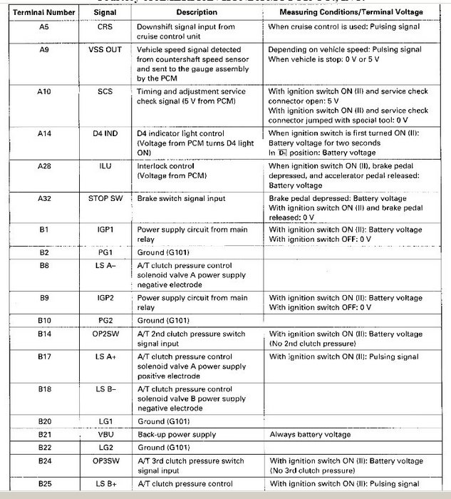

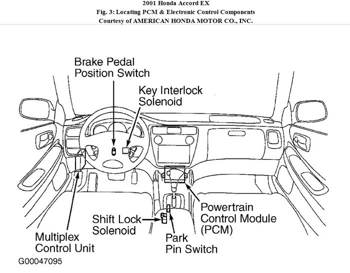

As far as the Transmission Range Sensor, I could only find one reference for which I sent you a location diagram. It seemed to otherwise be/or be part of the *****r position switch.

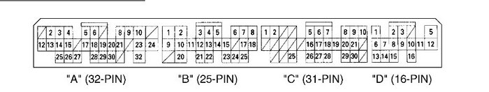

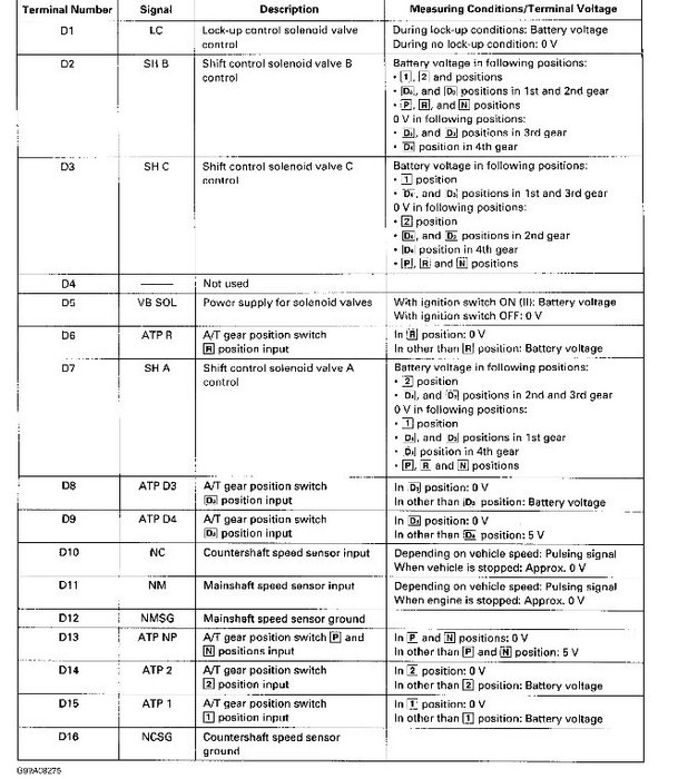

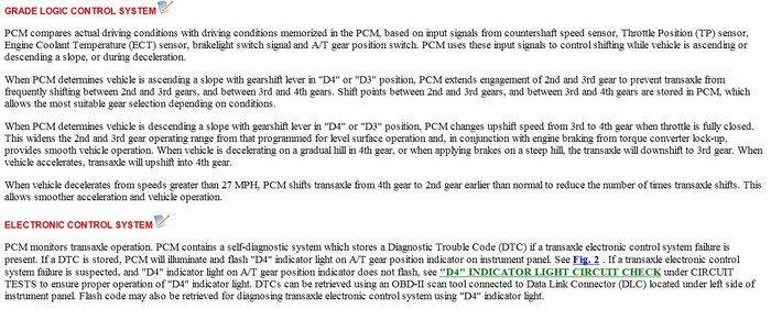

I sent you a voltage pin test chart. You can test a circuit or circuits in a component several ways to test them. Voltage gives you a value while continuity is either open/closed. So, if something that you test is nearly out of the specification range, it is probably slowly failing or internitantly failing. So, I think it will be an interesting test, let me know what comes of it.
I had to send you some diagrams in 2 part top and bottom pieces as they are too small to be usefule otherwise.
As far as the gear shifter, I sent you the locations of the shift solenoid lock and shifter lockout and the gear shift selector on the transaxle. I think you can take the cover off the shifter switch on the transaxle and slect gear by hand.
I wish I had a better answer about the range snesor, so I am sneding you everything I could find in relation to it.
Enjoy! I hope it gets you a few steps closer to your goal. Sounds like you are doing great and are good at getting as many information sources as possible. That is good as even the best information, except for 2carpros, can be different or mis-leading, etc.
