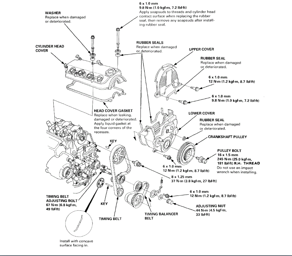

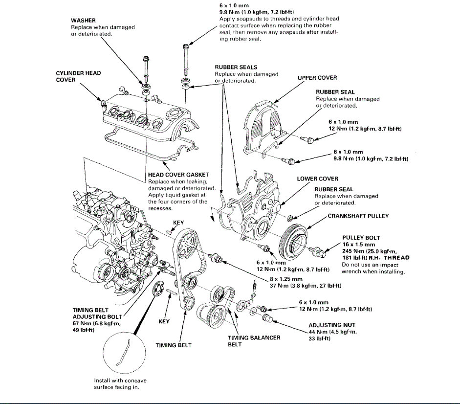

AAV559
  • 1995 HONDA ACCORD
  • 2.3L
  • 4 CYL
  • 2WD
  • MANUAL
  • 170,000 MILES
I have replaced the distributor o-ring, both of the vtec solenoid gaskets.
Tuesday, August 25th, 2020 AT 11:48 AM (Merged)
  • 109,932 POSTS
I attached an exploded view of the top end of the engine. See if there is anything you may have missed. I have to ask. Has the valve cover gasket been replaced? Is the leak coming from the top of the engine and running down on the transmission?
