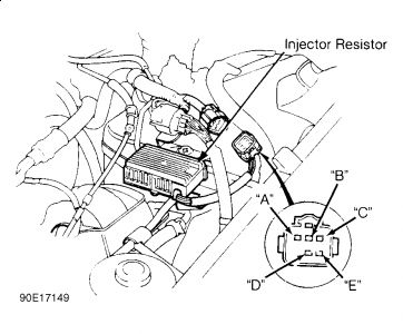

Ok we need to test the injector resistor box. See pic below. Now what you do is unplug it and check resistance between each term to term A. Meaning check resistance between term B and term A then term C and term A and so on. Resistance should be 5 to 7 ohms on the 200 scale. If not replace that box. Refresh me what codes are getting?

I ohm the fuel injector resistor and here are the readings on the 200 scale:
Term A to B, C, D, E are 6.3
Term B to A 6.3, C, D, E are 12.0
Term C to A 6.3, B, D, E are 12.0
Term D to A 6.3, B, C, E are12.0
Term E to A 6.3, B, C, D are12.0

Ok these codes are all circuit failure problems. Now that we have the codes lets go through them one at a time and get this car fixed. THe care is telling us with the codes that there is power or ground problems. So first off it looks like that resistor box is responsible for you injector problem. However if we go from the code 16 for the injector then here is what we need to do. First reset the computer by removing the back up fuse from the under hood fuse relay box for at least 10 seconds. Second get a long screwdriver which you will use as a stethescope ok. With the engine running put one end of the screw driver on the injector and the handle end you will cup with you hand and put your ear to it. Listen for the clicking of the injector. Now if the injector isn't clicking then unplug it and ohm it should be 1.5 to 2.5 ohms. If this is good set you meter to 20 volt scale turn the key on engine off and check the red wire with black stripe on the injector harness and see if there is power. Let me know what you find here and we will go to the next step.

I reset the fuse for the indicator lights and things seem to be running like it did before. I have a question, is the injector resistor still okay? If it is, I can't thank you enough for you help. It was awesome!

Yes everything looks good. I would drive and enjoy. If you have any more questions just ask. Thanks and have a great day.
