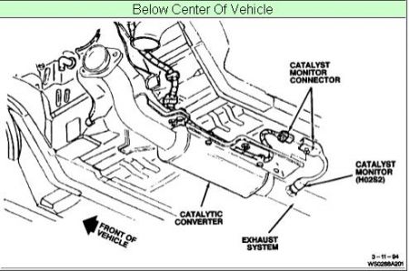

HAMMERFIX
  • 1995 PONTIAC GRAND PRIX
Engine Performance problem
1995 Pontiac Grand Prix 6 cyl Two Wheel Drive Automatic
changed spark plugs and wires. Still has engine miss and rpm surges and rotton egg smell. Need to know location of bank 1 sensor 2 and will just a defective sensor create these problems?
Monday, August 26th, 2019 AT 11:58 AM (Merged)
  • 75,992 POSTS
Engine running rough or misfiring can be cause by the following:
1.Defective spark plug.
2.Inadequate spark/coil,defective spark plug wire.
3.Lack of compression
4.False air leakage.
5.Faulty fuel injectors.
6.Insufficient fuel pressure.
7.Contaminated fuel.
8.EGR valve that is leaking.
9.Oxygen sensors.
https://www.2carpros.com/forum/automotive_pictures/12900_ox_2.jpg
