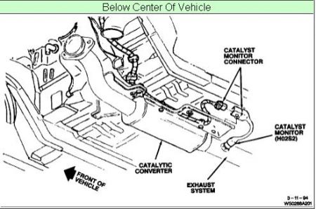

Engine Performance problem
1995 Pontiac Grand Prix 6 cyl Two Wheel Drive Automatic
changed spark plugs and wires. still has engine miss and rpm surges and rotton egg smell. need to know location of bank 1 sensor 2 and will just a defective sensor create these problems?

Engine running rough or misfiring can be cause by the following:
1.Defective spark plug.
2.Inadequate spark/coil,defective spark plug wire.
3.Lack of compression
4.False air leakage.
5.Faulty fuel injectors.
6.Insufficient fuel pressure.
7.Contaminated fuel.
8.EGR valve that is leaking.
9.Oxygen sensors.
