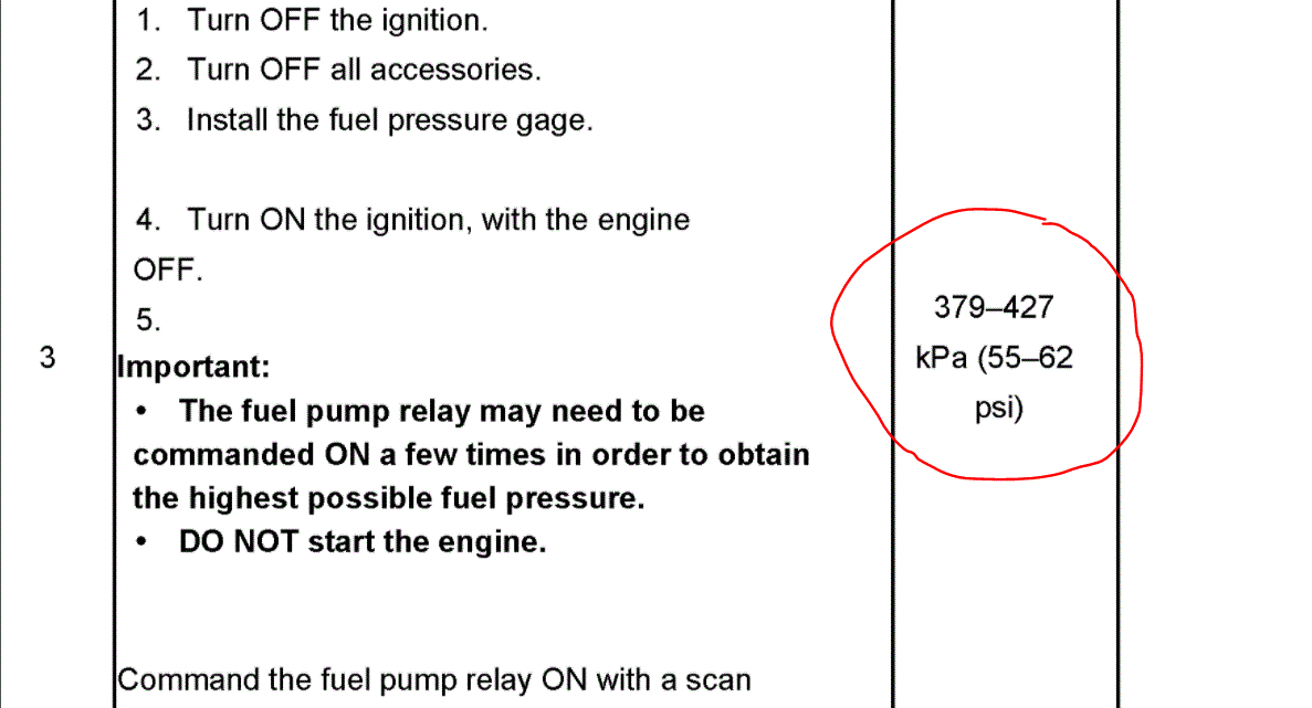

Recently replace lower and upper intake manifold gaskets. Replaced fuel injector spider, distributor, distributor cap and rotor, new spark plugs and wires, and crankshaft position sensor. Cleaned Throttle body. Fuel pressure is 65 PSI. New fuel filter. No codes being sent. Any ideas? It starts quickly and idles well but when trying to take off, it stumbles, hesitates and sometimes backfires. Checked timing and it's good.

Prior to replacing the gaskets, did the vehicle act the same way? Also, you indicated fuel pressure at 65 psi. Is that with the engine off? I ask because max (according to the manual with engine off) is 62. (see pic 1)
Is there any black smoke from the exhaust? Have you checked for vacuum leaks?
If you haven't checked for vacuum leaks, start there. Make sure everything on the air intake tube is back together properly and tight. Also, it's easy to leave a vacuum hose off. Here is a link that explains how to check:
Let me know if his helps, what you find, or if you have other questions.
