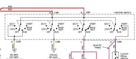

Welcome to the forum. I'd have to check feed circuits to and from the ignition switch. As far as the starter circuit, you could check the circuits at the starter relay in the power distribution center. Voltage for the coil side of relay, goes hot with key in the crank position. Voltage to load/swith side of relay, is hot all the time.
Sep 3, 2020 at 4:49 AM (Merged)
MIKEINTROUBLE
I'm sorry it's a 1994 chev trk. i dont know if it matters,,, where abouts is the power distribution center on this truck? On fender by battery?
JDL
  • 16,098 POSTS
Hi, thanks for the donation. The model year does make a difference, there is no starter relay for the 94. looked at 94 chevy truck K1500 gasoline. Use a testlite, check voltage to ignition switch, red wires, hot all the time. As far as the starter, the purple wire, right side of switch, goes hot with key in the start position. There are other tests for the starter,but, right now, I'd check the circuits at the switch.
https://images.2carpros.com/forum/automotive_pictures/170934_K1500_1.jpg
