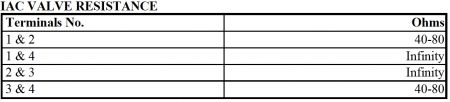

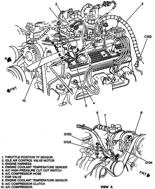

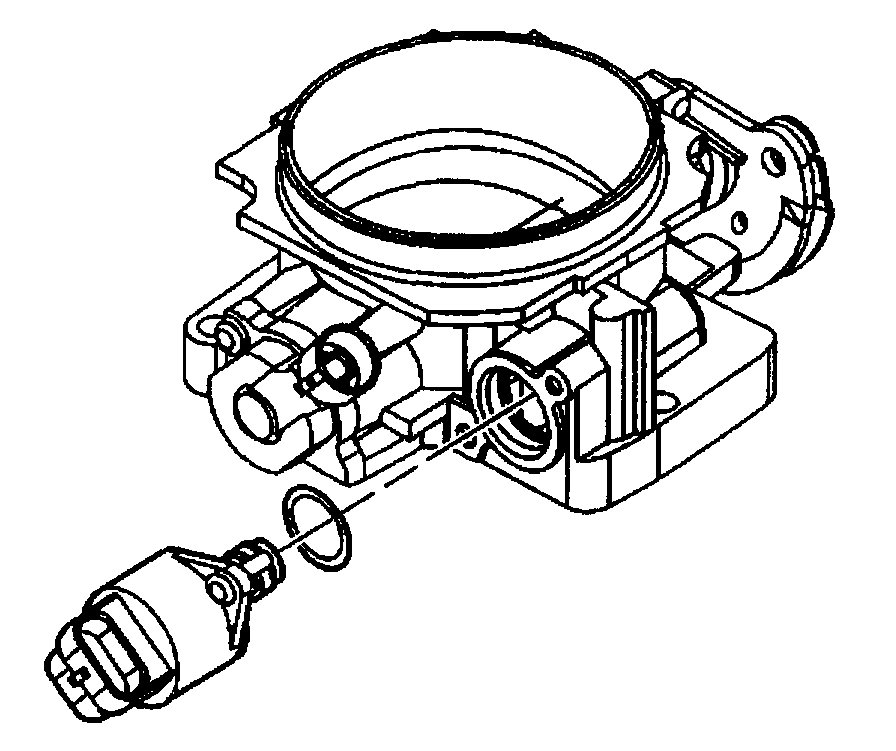

My truck listed above just started stalling 2 days ago; when I put it into park or slow down. It doesn't sputter it just shuts off. Now I have to turn it over a couple of times before it will start. I checked all of the plugs and wires (they were recently replaced) and they're not bad. The battery is keeping a good charge and I haven't had any drop in oil pressure. The check engine light is not on. I'm confused.
Sep 24, 2010 at 9:38 PM
MERLIN2021
  • 17,250 POSTS

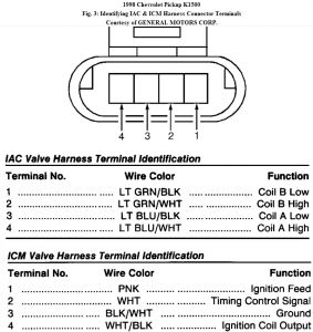

On the throttle-body check the IAC(idle air control valve) you can try removing it and cleaning any carbon out of it, but if it's weak, a new one would eliminate the stall on de-cell or idle. IDLE CONTROL SYSTEM Idle Air Control (IAC) System Diagnosis) 1. If power-train OBD system check has been performed, go to next step. If power-train OBD system check has not been performed, perform power-train OBD system check. See power-train OBD system check test with codes - 5.7L article. 2. Turn ignition switch to LOCK position. Connect IAC Driver (J-37027-A) to IAC valve. Set parking brake and block wheels. Turn A/C off. Start engine and let idle. Using scan tool, display RPM. Extend and retract IAC valve using IAC driver. If engine RPM changes, go to next step. If engine RPM does not change, go to step 7). 3. If RPM changes smoothly with each flash of IAC driver between 700 and 1500 RPM, go to next step. If RPM does not change smoothly with each flash of IAC driver between 700 and 1500 RPM, go to step 7). 4. Disconnect IAC driver. Check resistance between appropriate IAC valve terminals. See IAC VALVE RESISTANCE table. See Fig. 3 . If resistance is as specified, go to next step. If resistance is not as specified, replace IAC valve and go to step 10).
https://images.2carpros.com/forum/automotive_pictures/62217_iac_resist_1.jpg
https://images.2carpros.com/forum/automotive_pictures/62217_IACA_1.jpg
5. Check harness between PCM and IAC valve harness connector for opens and shorts. If open or shorts do not exist, go to next step. If open or shorts exist, repair as necessary and go to step 10). 6. Check the following: mechanical malfunction, vacuum leaks, lean or rich mixture, poor connection at PCM, defective PCV valve, A/C compressor circuit for short to ground, poor connection at IAC valve or IAC valve passages for blockage or restrictions. If problem does not exist, go to step 9). If problem exists, repair as necessary and go to step 10). 7. Check IAC passages for blockage or restrictions. If blockage or restrictions do not exist, go to next step. If blockage or restrictions exist, repair as necessary and go to step 10). 8. Replace IAC valve and go to step 14). 9. Replace PCM and go to next step. 10. Connect IAC Driver (J-37027-A) to IAC valve. Start engine. Using IAC driver, extend and retract IAC valve. If RPM does not change as expected, go to step 3). If RPM changes as expected, system is okay at this time.

  • 110,248 POSTS
Welcome to 2CarPros.

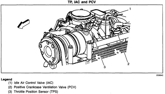

First, make sure nothing is blocking the air intake tube. If that is clear and the air filter isn't plugged, I want you to check the idle air control valve (IAC). The IAC is responsible for maintaining the engine idle speed by allowing a metered amount of air to enter the engine when the throttle plate is fully closed. What may be happening is when you take your foot off the throttle, the IAC may not be working and causing the engine to shut down and flood a bit. Then, you have to hold the throttle wide open to get it restarted.

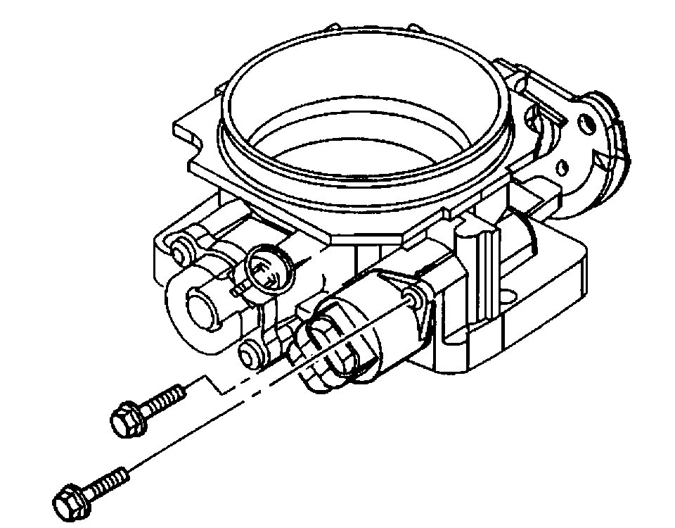

I attached two pics indicating where the IAC is located. You will find it on the throttle body. First, make sure the electrical connector is clean and making good contact. If it is, remove the IAC and inspect it for corrosion, excessive carbon or dirt. Also inspect where it mounts on the throttle body to ensure it isn't plugged.
Here is a link that shows in general how one is replaced. I'm adding it so you can see what you are getting into before you start.
https://www.2carpros.com/articles/how-to-replace-an-idle-speed-control-motor-iac
___________________
Here are the directions for replacement specific to your vehicle. The remaining pictures correlate with these directions.
IDLE AIR CONTROL (IAC) VALVE REPLACEMENT
Throttle Position Sensor Electrical Connector
See Pic 3
REMOVAL PROCEDURE

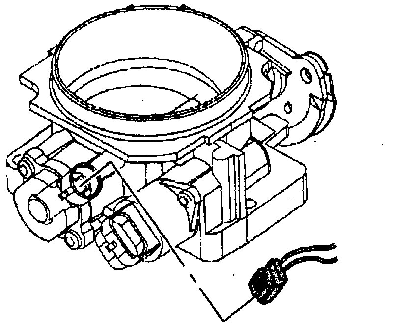

1. Remove the electrical connector from the Idle Air Control (IAC) valve
See Pic 4
2. Remove the IAC valve attaching screws.
CAUTION: If the IAC valve has been in service: DO NOT push or pull on the IAC valve pintle. The force required to move the pintle may damage the threads on the worm drive. Also, DO NOT soak the IAC valve in any liquid cleaner or solvent, as damage may result.
See Pic 5
3. Remove the IAC valve assembly.
4. Remove the O-ring.
CLEANING AND INSPECTION PROCEDURE
1. Clean the IAC valve O-ring sealing surface, pintle valve seat, and air passage.
^ Use the carburetor cleaner and a parts cleaning brush in order to remove carbon deposits. Follow instructions on the container.
^ Do not use a cleaner that contains methyl ethyl ketone, an extremely strong solvent and not necessary for this type of deposit.
^ Shiny spots on the pintle or seat are normal. They do not indicate misalignment or a bent pintle shaft.
^ If air passage has heavy deposits, remove the throttle body for complete cleaning.
2. Inspect the IAC valve O-ring for cuts, cracks, or distortion. Replace if damaged.
NOTE: If installing a new IAC valve, replace with an identical part. The IAC valve pintle shape and diameter are designed for the specific application.

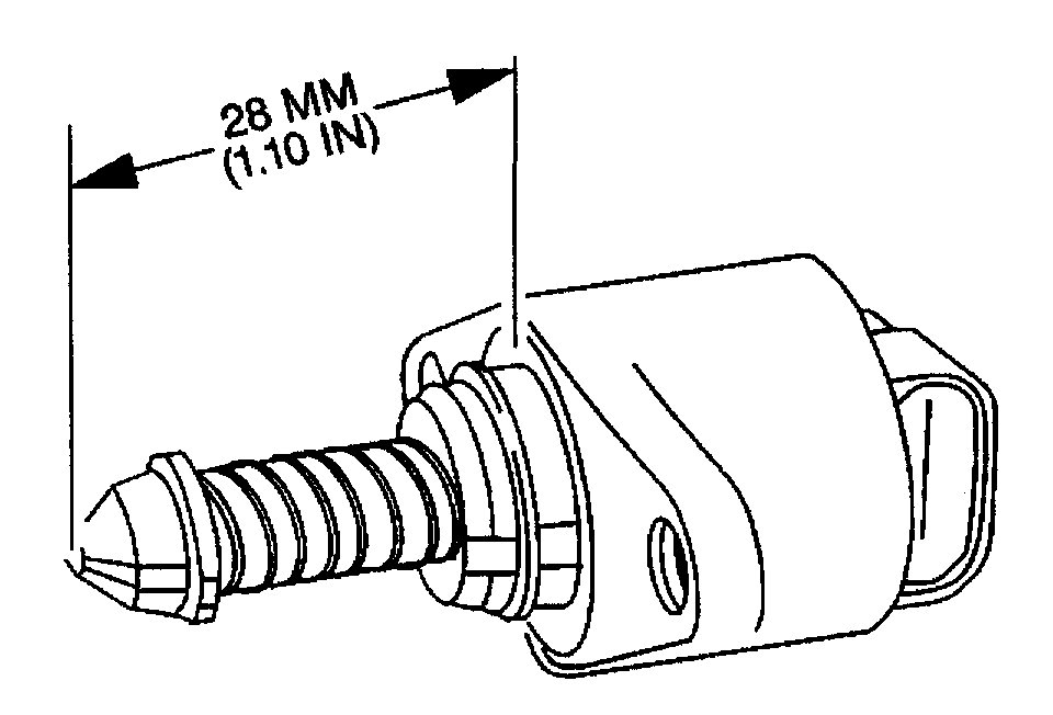

3. Measure the distance A between tip of IAC valve pintle and mounting flange. If greater than 28 mm, use finger pressure in order to slowly retract the pintle. The force required to retract the pintle of a new valve will not cause damage to the valve.
See Pic 6
MEASUREMENT PROCEDURE
NOTE: If installing a new IAC valve, replace with an identical part. The AC valve pintle shape and diameter are designed for the specific application.
INSTALLATION PROCEDURE
2. Lubricate the IAC valve O-ring with clean engine oil.
2. Install the IAC valve assembly.
3. Install the attaching screws.
Tighten
^ Tighten the IAC valve attaching screws to 3.0 Nm (26 lb. in.).
4. Install the electrical connector.
5. Reset the IAC valve pintle position.
5.1.Turn the ignition switch to the ON position for 5 seconds.
5.2.Turn the ignition switch to the OFF position for 10 seconds.
5.3.Start the engine.
5.4.Check for the proper idle operation.
