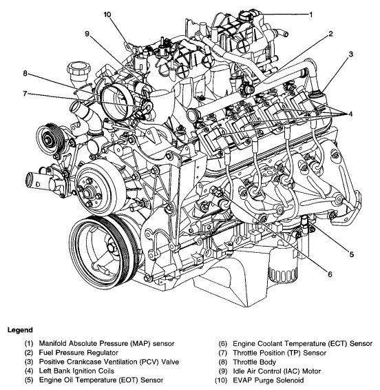

If no trouble codes exist, I would then recommend checking the coolant temperature sensor. Here is a description from alldata of what it does. If the sensor isn't working properly and provides false information to the computer, the air fuel mixture will be wrong and can cause what you are experiencing.
The Engine Coolant Temperature (ECT) sensor is a thermistor, a resistor which changes value based on temperature, mounted in the left cylinder head. Low coolant temperature produces a high resistance, 100,000 ohms at -38°C (-39°F) , while high temperature causes low resistance 70 ohms at 130°C (266°F) .
The Powertrain Control Module (PCM) supplies a 5.0 volt signal to the ECT sensor through a resistor in the PCM and measures the voltage. The voltage is high when the engine is cold. The voltage is low when the engine is hot. The PCM calculates the engine coolant temperature by measuring the voltage. The engine coolant temperature affects most systems the PCM controls.
The scan tool displays engine coolant temperature in degrees. When the engine starts, the engine coolant temperature should rise steadily to about 90°C (194°F) then stabilize when the thermostat opens.
The engine coolant temperature and intake air temperature should be close to each other if the engine ha8 not been run for several hours, overnight. The following DTCs set when the PCM detects a malfunction in the ECT sensor circuit:
DTC P0117 ECT Sensor Circuit Low Voltage
DTC P0118 ECT Sensor Circuit High Voltage
DTC P0125 Excessive Time to Closed Loop
DTC P1114 ECT Sensor CKT Intermittent Low Voltage
DTC P1115 ECT Sensor CKT Intermittent High Voltage

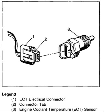

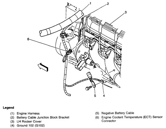

If you find the sensor to be faulty, here are directions for removal and replacement. Additionally, there are pictures to follow for part and location identification.
REMOVAL PROCEDURE
Raise the vehicle. Refer to Lifting and Jacking the Vehicle in General Information.
Drain the engine coolant. Refer to Draining and fitting Cooling System in Engine Cooling.
Lower the vehicle.
Disconnect the electrical connector from the Engine Coolant Temperature (ECT) sensor.
NOTE: Refer to Handling Coolant Sensor Notice in Cautions and Notices.
Remove the ECT sensor.
INSTALLATION PROCEDURE
Coat the ECT sensor threads with sealer GM P/N 12346004 or the equivalent.
NOTE: Refer to fastener Notice in Cautions and Notices.
Install the ECT sensor.
Tighten
Tighten the ECT sensor to 20 N.m (15 lb ft) .
Connect the ECT sensor electrical connector.
Refill the engine coolant. Refer to Draining and fitting Cooling System in Engine Cooling.
Start the engine and check for leaks.
Reinspect the engine coolant level. Refer to Draining and Filling Cooling System in Engine Cooling.
I hope this helps. Let me know if you have other questions or need additional help.

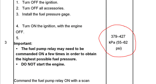

Recently replace lower and upper intake manifold gaskets. Replaced fuel injector spider, distributor, distributor cap and rotor, new spark plugs and wires, and crankshaft position sensor. Cleaned Throttle body. Fuel pressure is 65 PSI. New fuel filter. No codes being sent. Any ideas? It starts quickly and idles well but when trying to take off, it stumbles, hesitates and sometimes backfires. Checked timing and it's good.

  • 110,248 POSTS
Prior to replacing the gaskets, did the vehicle act the same way? Also, you indicated fuel pressure at 65 psi. Is that with the engine off? I ask because max (according to the manual with engine off) is 62. (see pic 1)
Is there any black smoke from the exhaust? Have you checked for vacuum leaks?
If you haven't checked for vacuum leaks, start there. Make sure everything on the air intake tube is back together properly and tight. Also, it's easy to leave a vacuum hose off. Here is a link that explains how to check:
Let me know if his helps, what you find, or if you have other questions.
