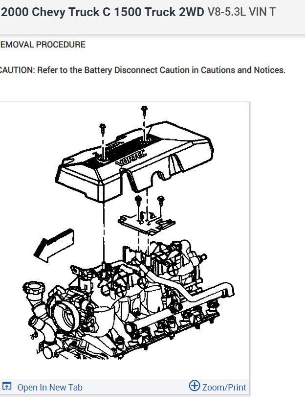

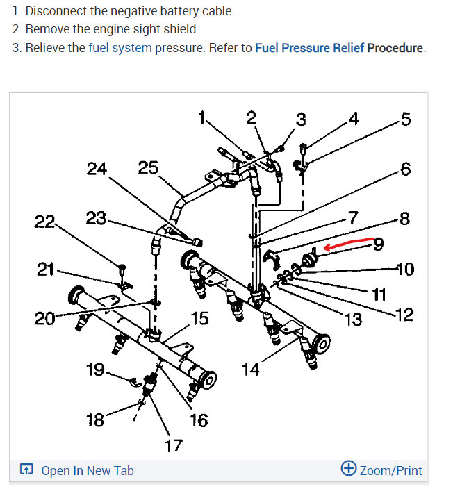

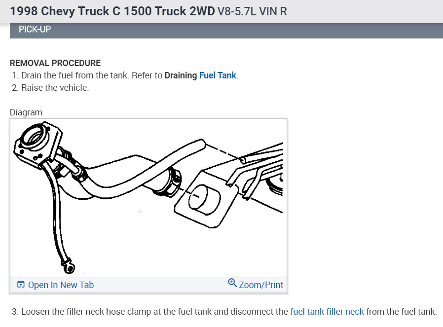

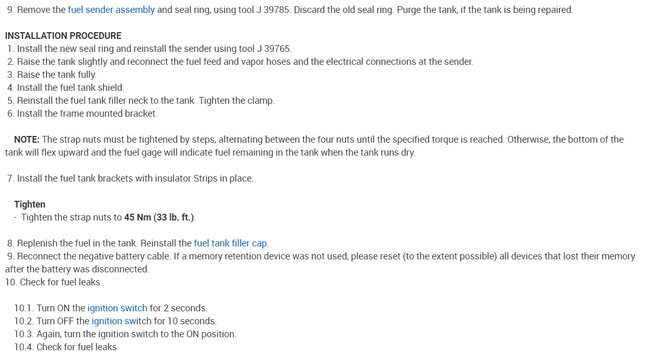

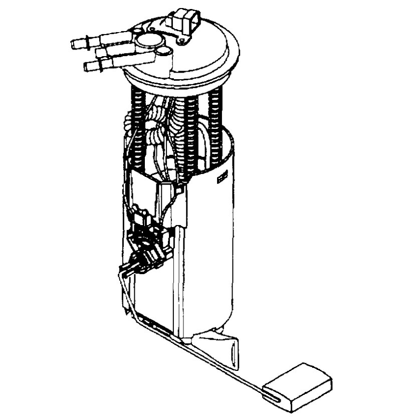

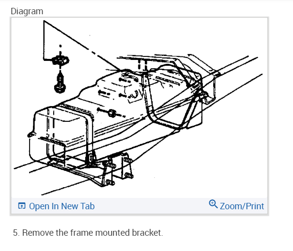

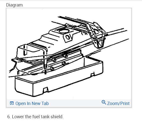

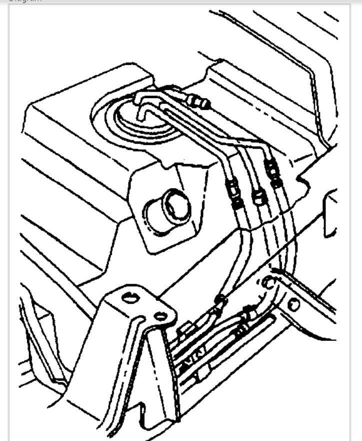

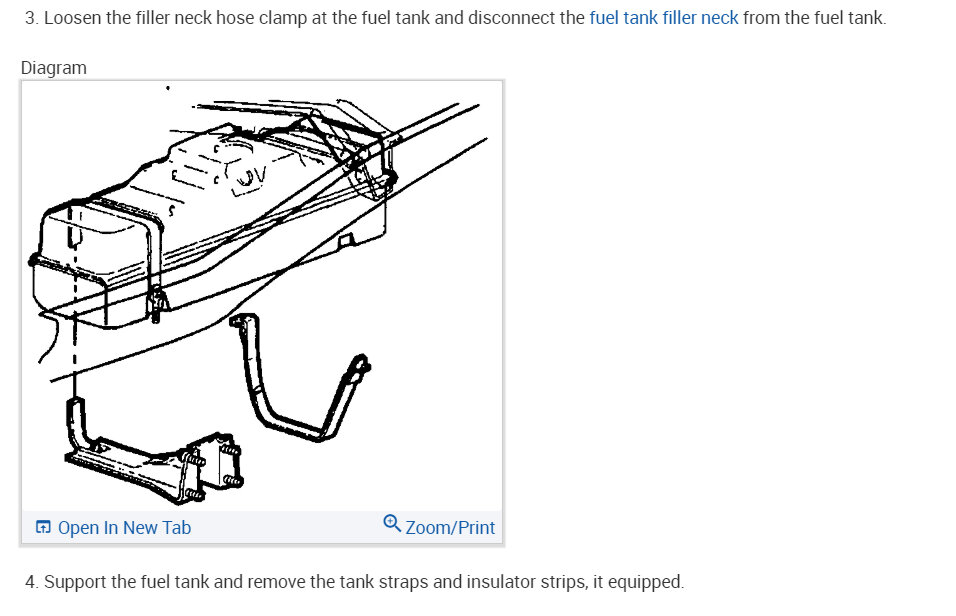

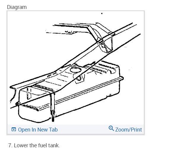

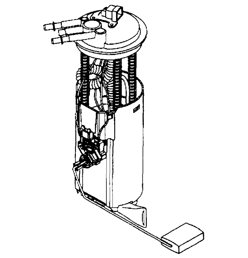

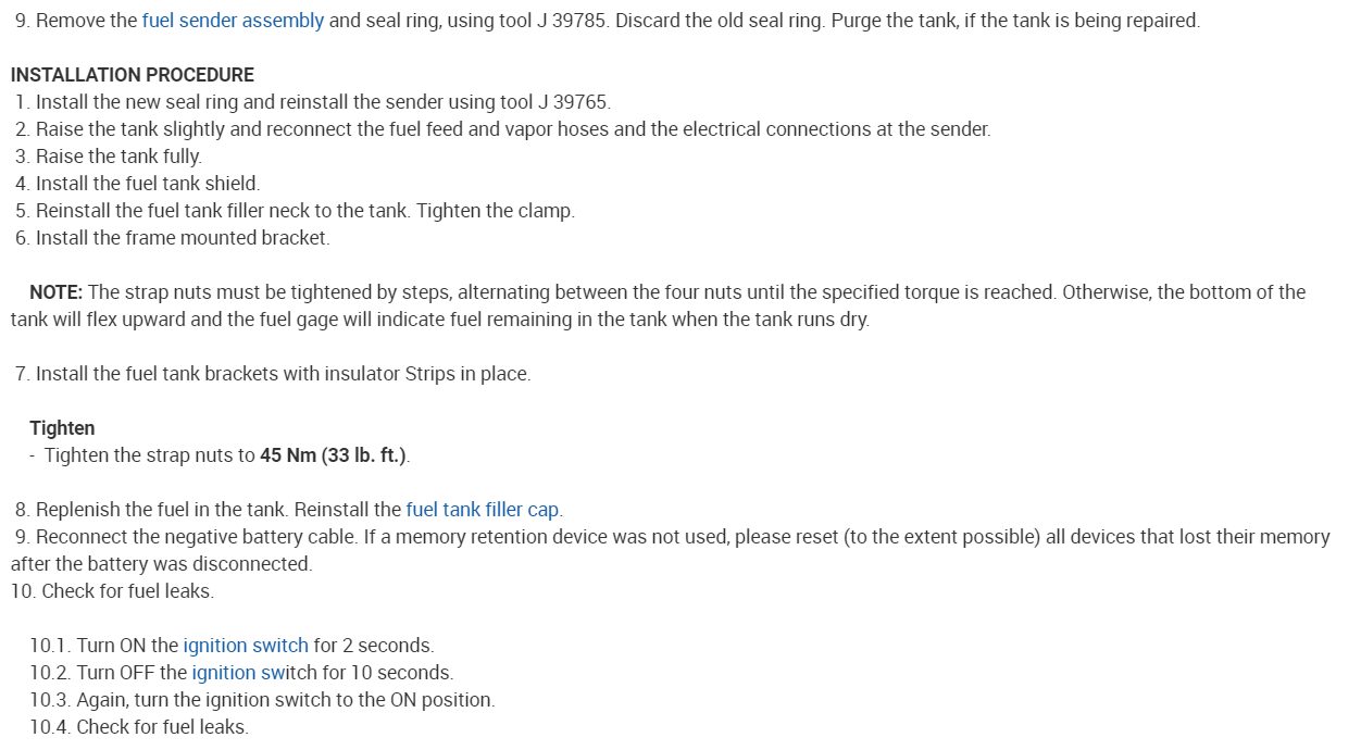

Here is how to change the pump out. Also, check the fuel pressure regulator by pulling the vacuum line off and if there is fuel present the regulator is bad and needs replacement. Check out the images (below). Please let us know what happens.
