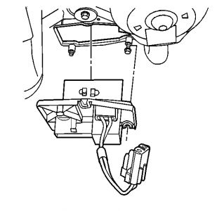

Hi guys I own 2000 montana and I only have 3-5 speeds on blower motor where is the resistor located any help would be appeciated I cant find it thanks, lost low speeds

I have the same problem, fan not working 1-2 speeds, any help would be appeciated.

I OWN A 2000 MONTANA & CHANGED THE FAN RESISTOR ONCE. LOCATED UNDER THE GLOVE COMPARTEMENT BESIDE THE BLOWER FAN. GOOD LOCK, NOT EASY TO REMOVE WILL

Next to the blower motor.under the dash on passenger side.
https://www.2carpros.com/forum/automotive_pictures/102900_blo_1.jpg
