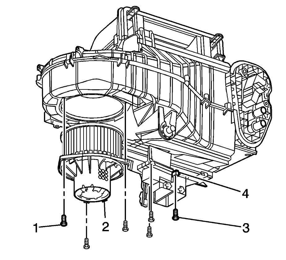

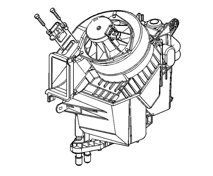

Drove vehicle with good heat blowing on Friday, purchased and replaced the battery today and when started the vehicle the heater fan not working now.
Dec 15, 2019 at 9:08 AM
DANNY L
  • 5,648 POSTS
Hello, I'm Danny.

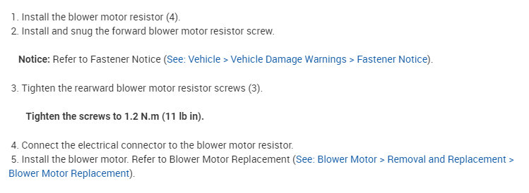

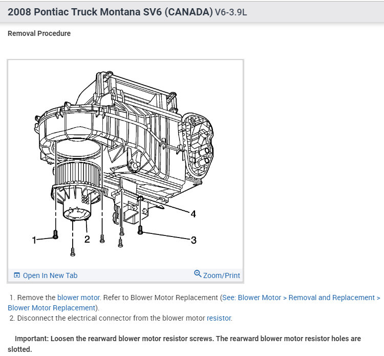

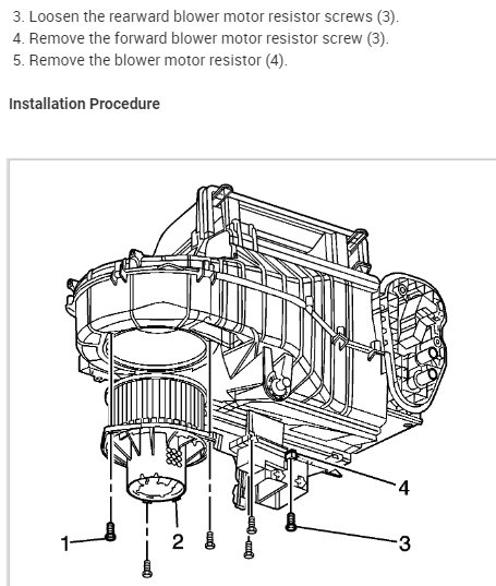

Here is a tutorial showing how to replace blower motor/resistor:
https://www.2carpros.com/articles/blower-fan-motor-works-on-high-speed-only
I've attached pictures and step-by-step instructions below on how to replace blower motor/resistor for your Montana. Hope this helps and thanks for using 2CarPros.
Dec 15, 2019 at 9:27 AM
STEVE W.
  • 15,345 POSTS

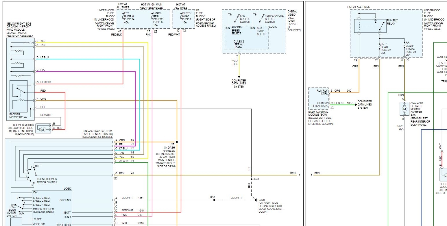

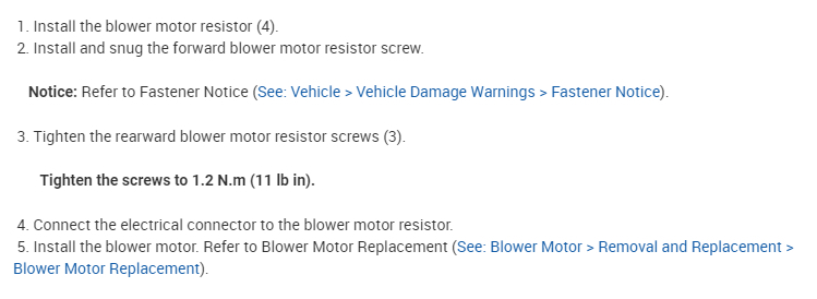

If it doesn't work on any speed including high it is more likely the motor itself. On high the resistor is bypassed and the blower gets full power. I would check fuse 34 and fuse 27 first. A quick test for the run relay is if you have the aux. real heater, if it works the relay is good. Use a test light to be sure you have power at both sides of the fuse then unplug the wiring at the blower resister and check for battery voltage on terminal G the Red wire with black stripe. If you have power there but no blower on high then test the blower motor itself by applying battery voltage to the Red terminal and grounding the other. If the blower works check that the Black wire has a good ground, they have a bad habit of failing.
Removing the blower and resister is easy, they are in the passenger foot-well. Remove the blower first, then loosen the rear screws on the resister and remove the front one The rear ones are slotted. Two common issues with them, the blower motor starts to fail and the higher current burns the relay contacts or the resister or the ground fails.

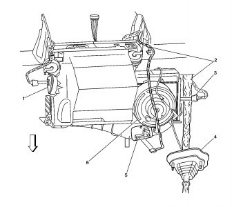

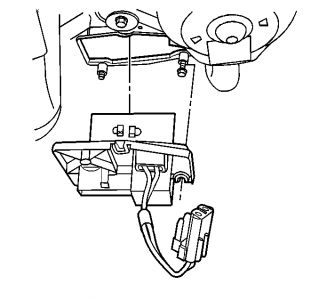

Need to know the location of blower motor resistor on the vehicle listed above. Please and thank you.
Oct 18, 2020 at 5:02 AM (Merged)
Good evening,
It is under the dash, right side and next to the blower motor. Check out the diagrams (Below). Please let us know what happens.

I have to take part of my answer back. the relay is included in the resister so all 5 speeds actually do pass through it.

DENNYP
  • 1,824 POSTS
(1) Electric Slave Actuator (2) I/P Harness (3) Connector to Electric Air Inlet Actuator (4) Pass Through P100 (5) Blower Motor Resistor (6) Blower Motor

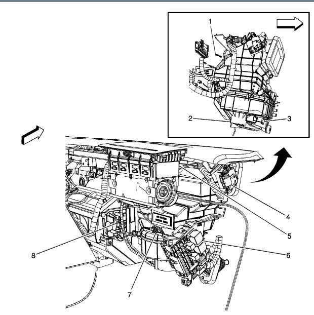

DIB46
hi guys i own 2000 montana and i only have 3-5 speeds on blower motor where is the resistor located any help would be appeciated i cant find it thanks,lost low speeds
D0NALD
I have the same problem, fan not working 1-2 speeds,any help would be appeciated .
WILFRID
I OWN A 2000 MONTANA & CHANGED THE FAN RESISTOR ONCE. LOCATED UNDER THE GLOVE COMPARTEMENT BESIDE THE BLOWER FAN. GOOD LOCK, NOT EASY TO REMOVE WILL
DENNYP
  • 1,824 POSTS
next to the blower motor.under the dash on passenger side.
