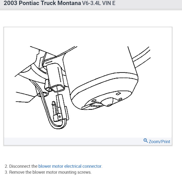

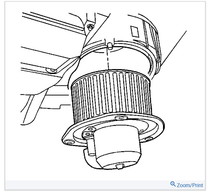

This sounds like the blower motor when out but to be sure lets run down this guide which shows how to test and replace the blower motor with diagrams below for how it can be done on your car.
https://www.2carpros.com/articles/blower-fan-motor-works-on-high-speed-only
Check out the diagrams (Below). Please let us know what you find. We are interested to see what it is.

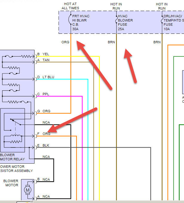

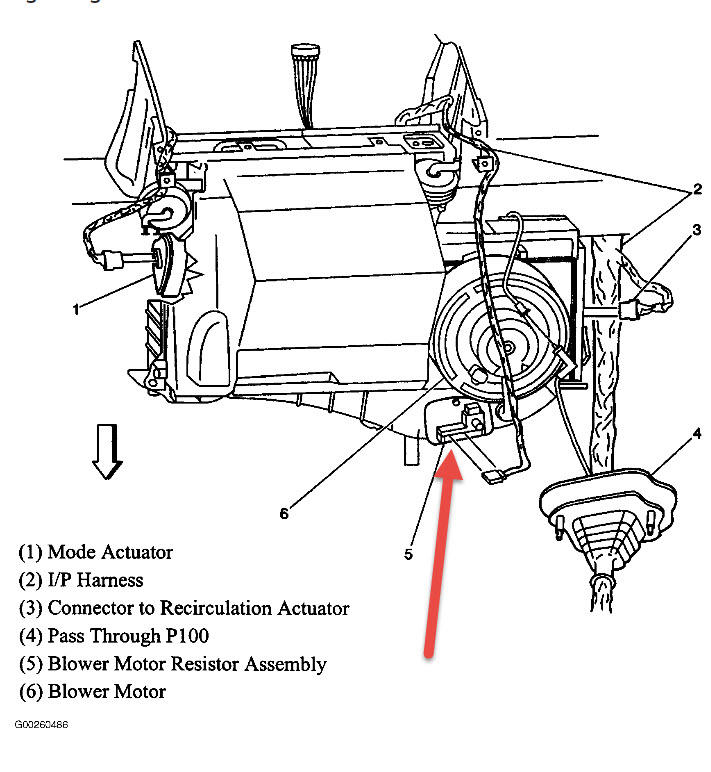

check relay and resistor in pics I tmay be the control though which would have to be scanned by a pro.

  • 110,244 POSTS
Chances are the blower motor resister is bad. Have you tried replacing that? There is also a relay that can cause this, but my first guess is the resister.
