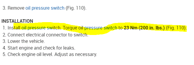

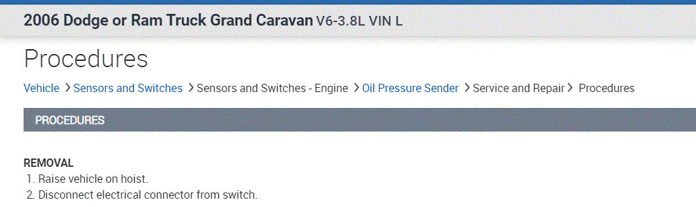

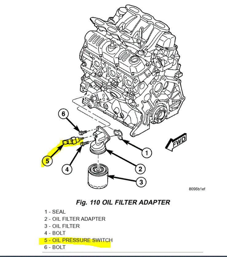

Is there any torque specs for oil sensor sending unit?

As far as the torque specs, see the directions below. Note: it indicates 100-inch pound of torque and not foot pounds.
Let me know if this helps and what was causing the lights to stop operating.
