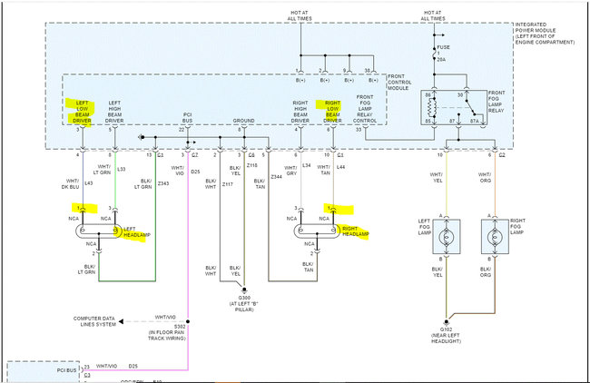

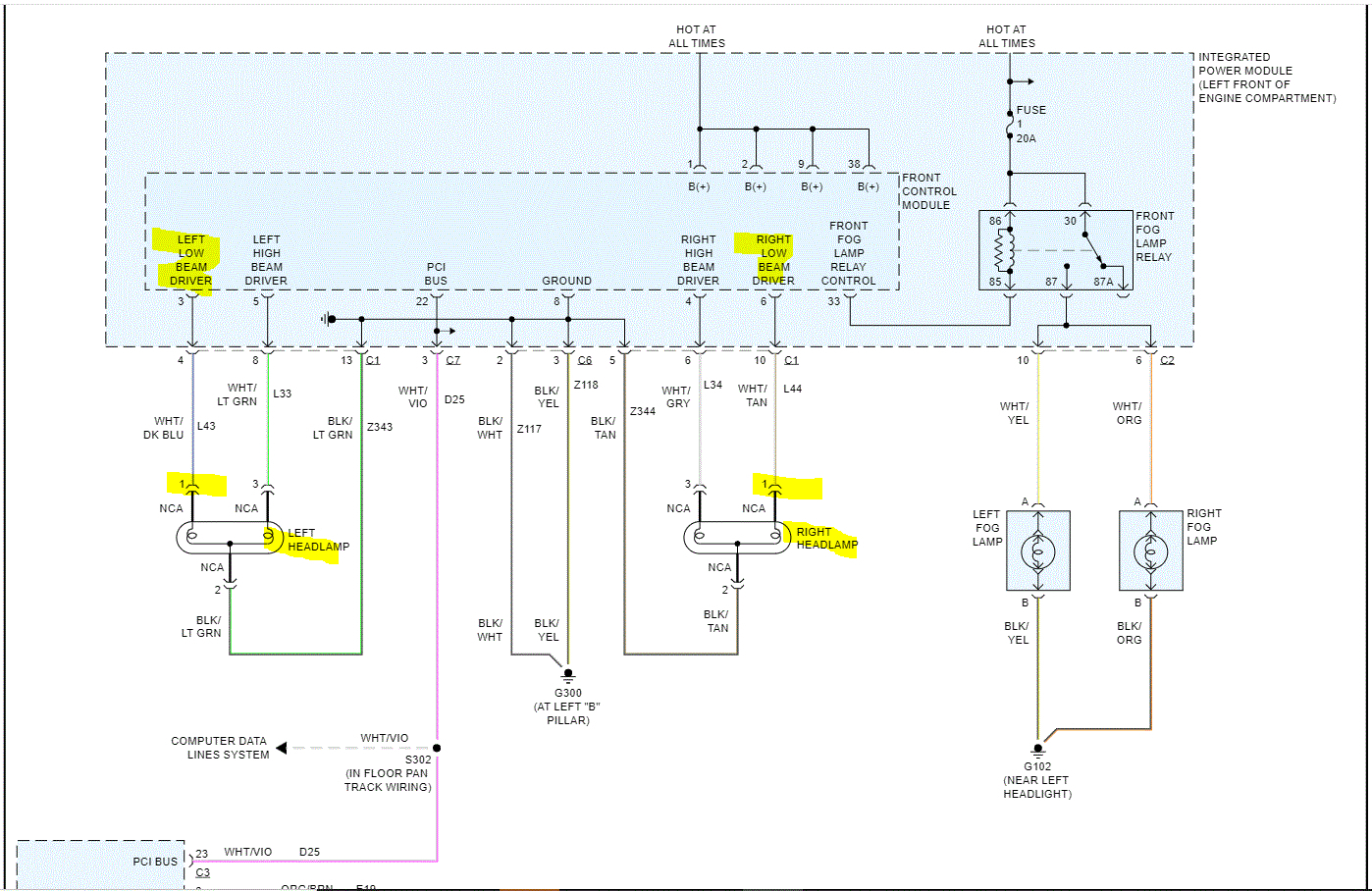

The power for the low beams comes from what is called a totally integrated power module (TIPM). When a low beam is requested, power from the TIPM left and right low beam drivers powers the low beams. So, to confirm that the bulbs aren't the problem, I need you to perform a test.
If you remove the headlamp bulb socket from the rear of the headlamp assembly, locate a white wire with a tan tracer on the right (passenger side) connector and a white wire with a dark blue tracer on the left side. Turn the headlamp lights on low beam. You should have 12v to both of those wires. Testing is done one side at a time. Here is a link you may find helpful when testing. (See wiring schematic below)
If there is power, there is a good chance the bulb (which is a dual-element bulb) may have a bad filament for the low beam. If there is no power, then we need to go to the TIMP and perform testing. The TIPM is part of the fuse box under the hood and is where you place fuses (power distribution box).
The TIPM on this and many Chrysler vehicles have a reputation for failing due to the small pins in the connectors. There are many and because of their size, they are known to break, corrode, and just no longer make a good connection.

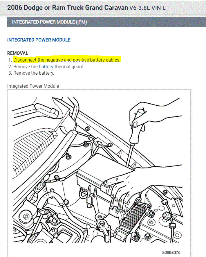

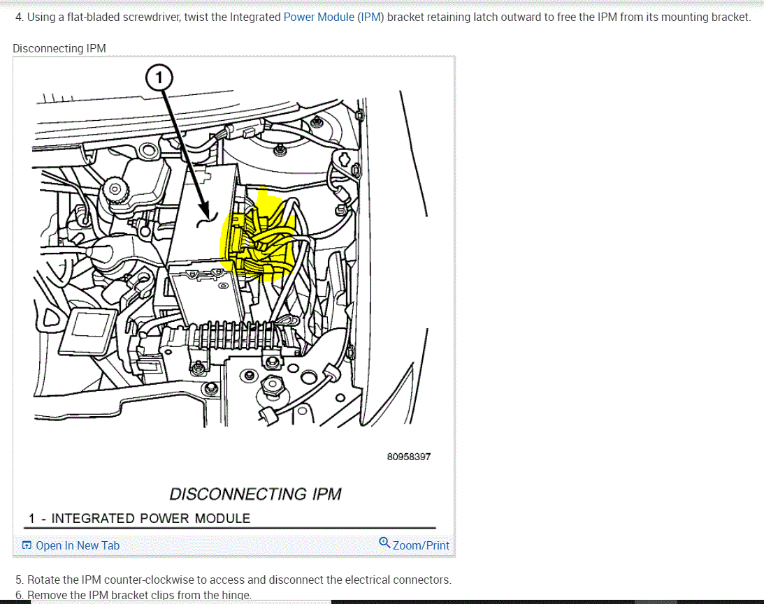

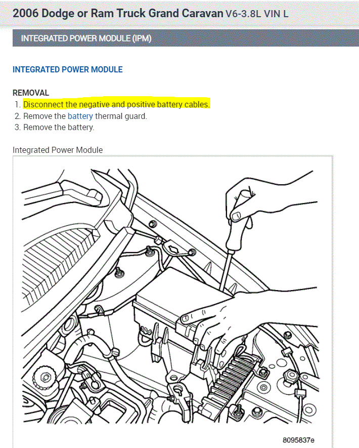

If there is no power, we need to check the TIPM connectors. If you look at the attached pics (1-3) they provide the directions for removal of the TIPM. You don't need to fully remove it, but you need to loosen it so you can turn it and access the wiring connectors under it (pic 2). Pic 4 shows the connector that we will be testing.
Make sure the battery is disconnected and removed prior to doing the work. Once removed, I would like to allow it to sit for approximately 30 minutes to discharge any modules holding power, but that's your call. It isn't indicated in the manual.

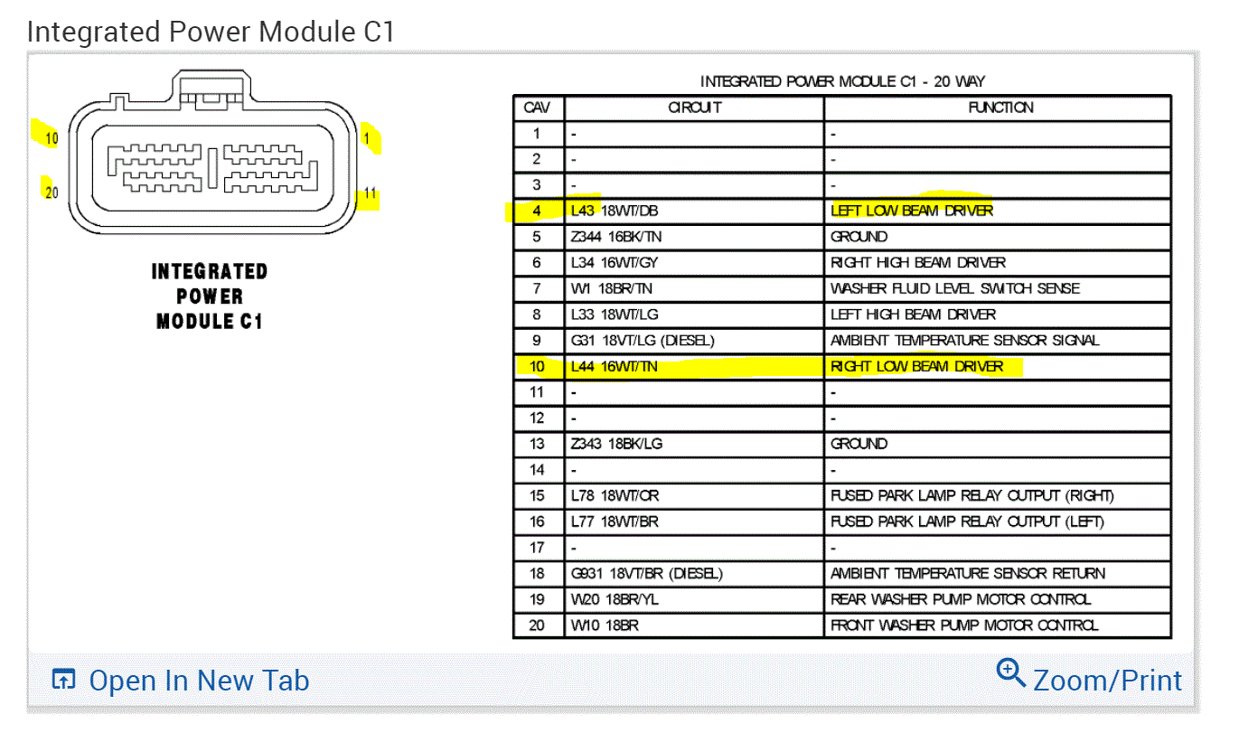

Once removed, locate connector 1 (see the last pic below) It is a 20-way connector and shaped like the one in pic 4. It "should be" black in color. Disconnect the connector and specifically inspect pins 4 and 10. See pic for pin orientation.
Make sure they are not corroded, pushed in, broken, or anything that would cause a connection issue. If it appears good, then you will need to carefully reinstall power to the electrical system, and check the wires out from those pins for power by back probing the wire at the connector with it plugged in.

If you were to use a jumper wire between battery power and the wires for the low beam (see schematic above), the light should turn on, and yes, a test light will complete the power circuit. However, that really isn't a permanent fix. You will have no control overturning them on and off and switching from low to high beam.

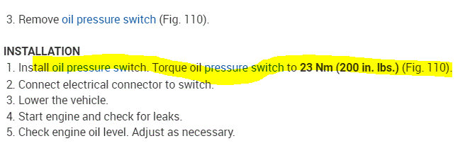

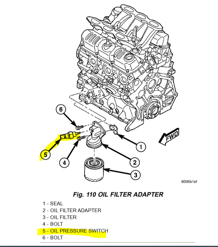

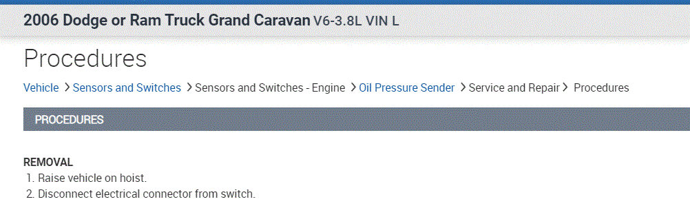

Is there any torque specs for oil sensor sending unit ?

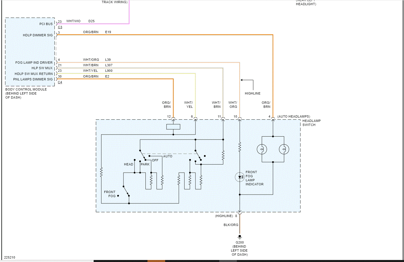

The low beam switch is what signals power to the TIPM which in turn allows the lights to work. Any switch is used to either close a circuit (make contact to complete) or open a circuit (disconnect or prevent power flow). In general, it works just like a light switch at home. It completes a circuit when on.
As far as the torque specs, see the directions below. Note: it indicates 100-inch pound of torque and not foot pounds.
