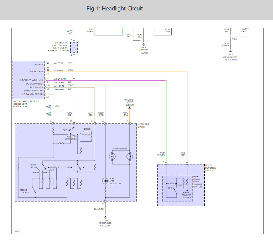

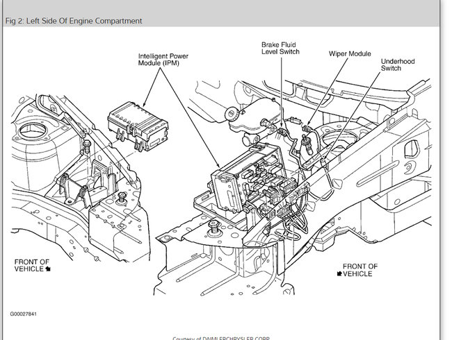

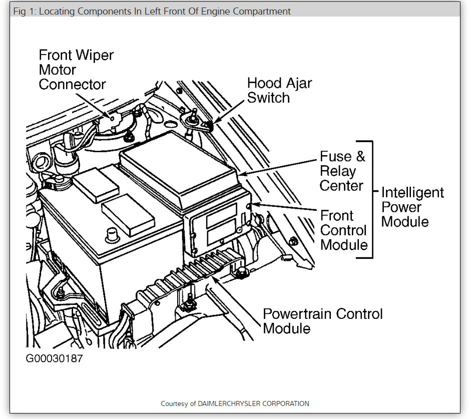

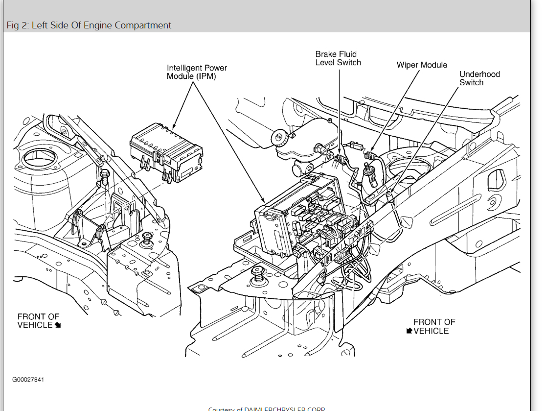

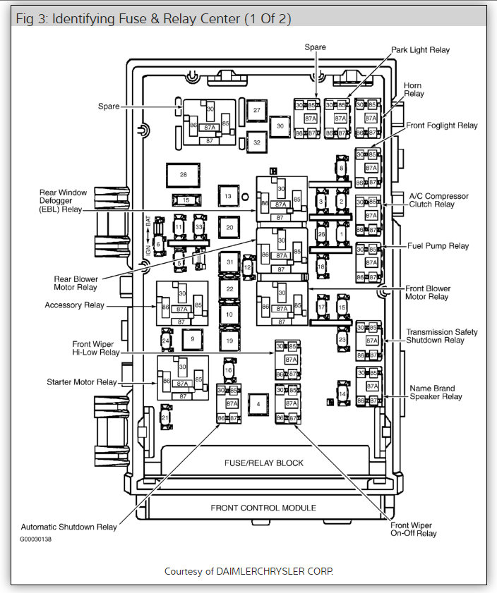

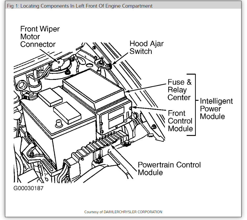

On the RS van the front lights are controlled by the FCM (front Control module) If your wiring and bulbs are indeed good. The FCM is the problem. It is attached to the PDC (power distribution center). Both units combined it is called an IPM (integrated Power Module).

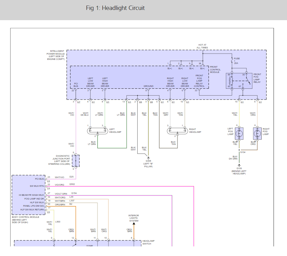

Here is a headlight wiring diagram so you can see how the system works.

1. Just remove the plastic cover over the PDC ( which is the black cover beside the battery. )
2. Looking at the front of the PDC is a silver housing with four torx screws.
3. Remove the four screws.
4. Pull out the FCM housing. ( It separates from the PDC )

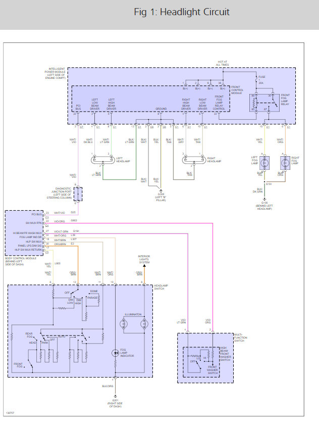

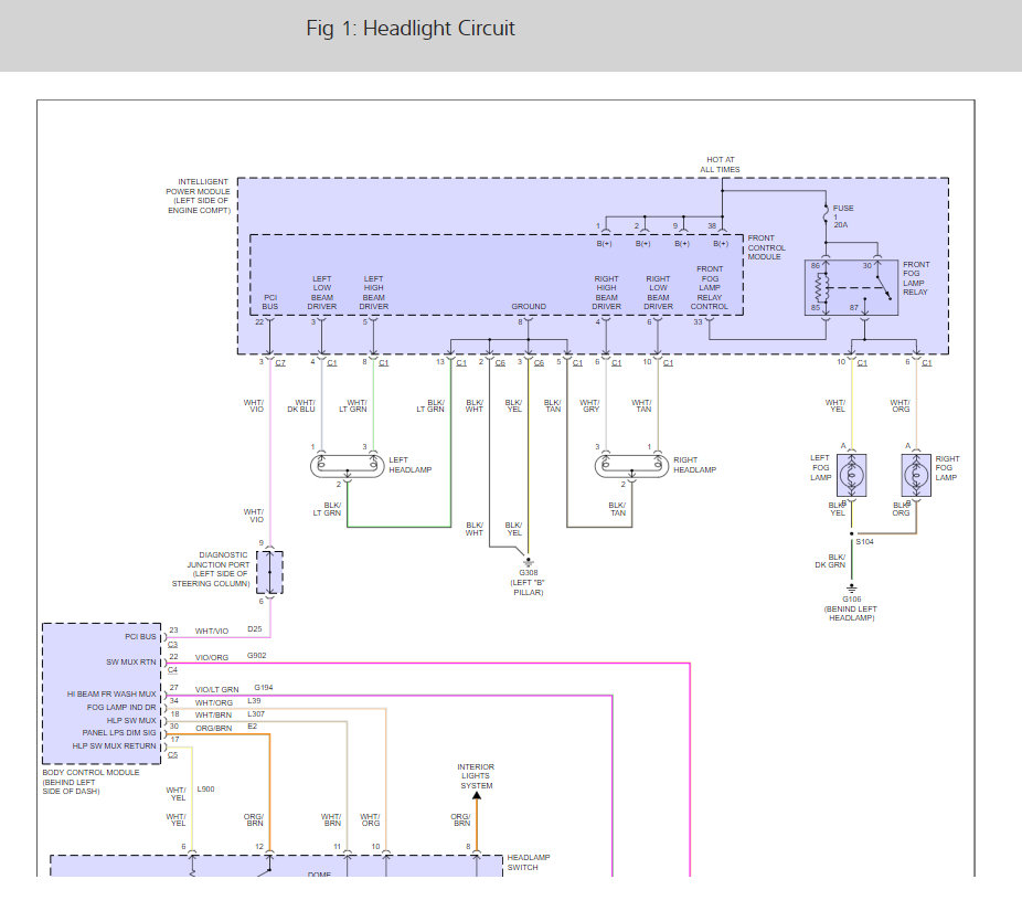

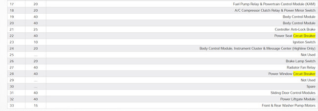

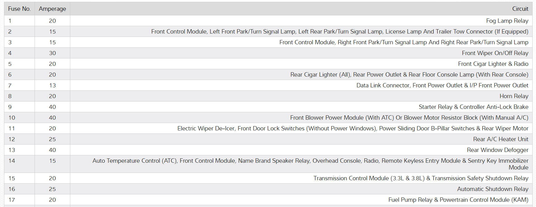

Are both high and low beam headlight not working? Here are wiring diagrams so you can see how the system works and the fuses #1 we should check as well with a guide to help:

I have daytime running lights and one works and the other one doesn't. when I turn on my headlights, the right one works and the left one doesn't but if I turn my brights on the left one works and the right one doesn't. So if I drive at night I have to hold the blinker switch in between dim lights and bright lights in order for both headlights to work. It's a pain in the butt. I checked the wiring and it looks okay and I replaced the headlight bulbs and that didn't fix it.
Nov 17, 2019 at 3:23 AM
  • 55,447 POSTS
Yep, it sounds like the IPM has gone out. but I would test power and continuity to make sure the switch is working. Use this guide and the wiring diagrams above:
